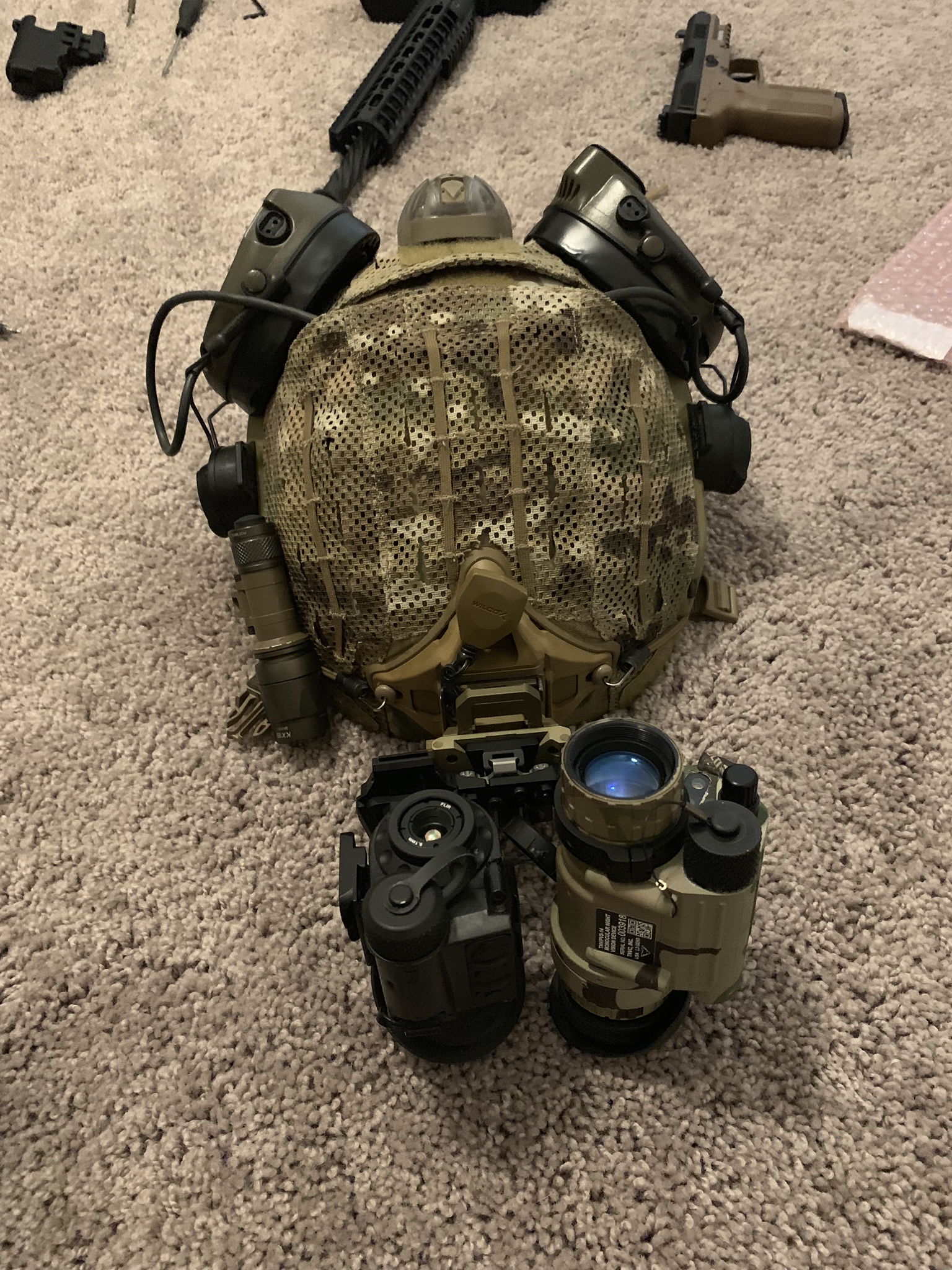

What has me coming back to the thin filmed is the extra cash could go towards a helmet/mount and/or a DBAL A3
If it comes down to having one -14 only vs one -14 with a LAM, I’d choose the -14 and LAM.
If you’re using it mainly for hunting,
honestly you might want to consider a thermal depending on where you hunt. You can find good used ones in that range or new 320 or 384 cores. They compliment each other. so you can add either down the road. Navigate or spot for eye shine with the -14 then go to thermal, or spot with thermal and go to -14 and LAM.
Whole system > one epic item.
I recommend you get a Crye Nightcap and a Rhino II mount off ebay to save money.
If you are doing dangerous operations in vehicles (tactical night driving) get the bump helmet. It can change a hospital level wreck into a walk away wreck. Ask me how that works lol.
Consider an IR only laser, or the stream light TLr-vir-ii. Most find day lasers fucking useless wastes of time.
