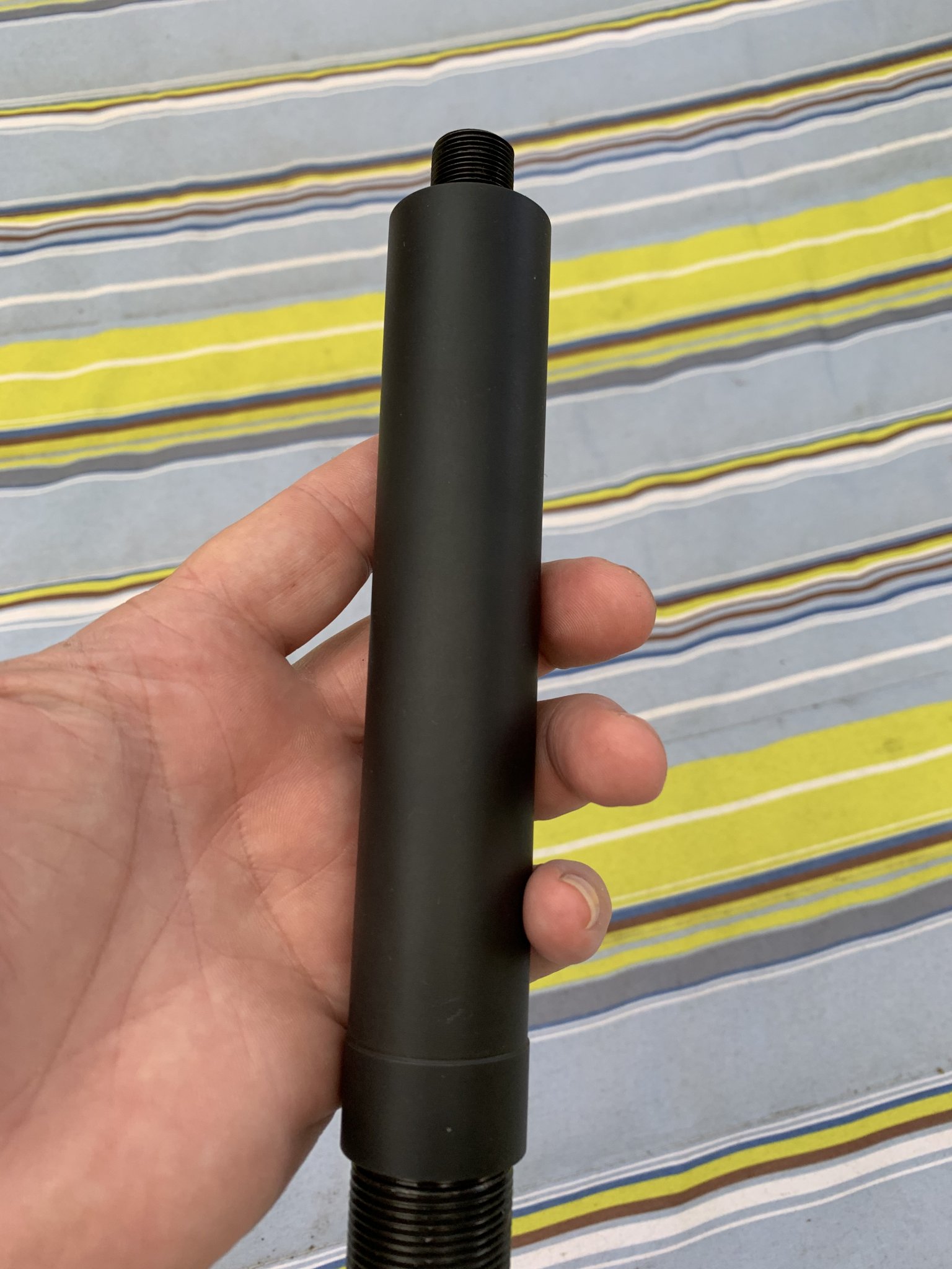

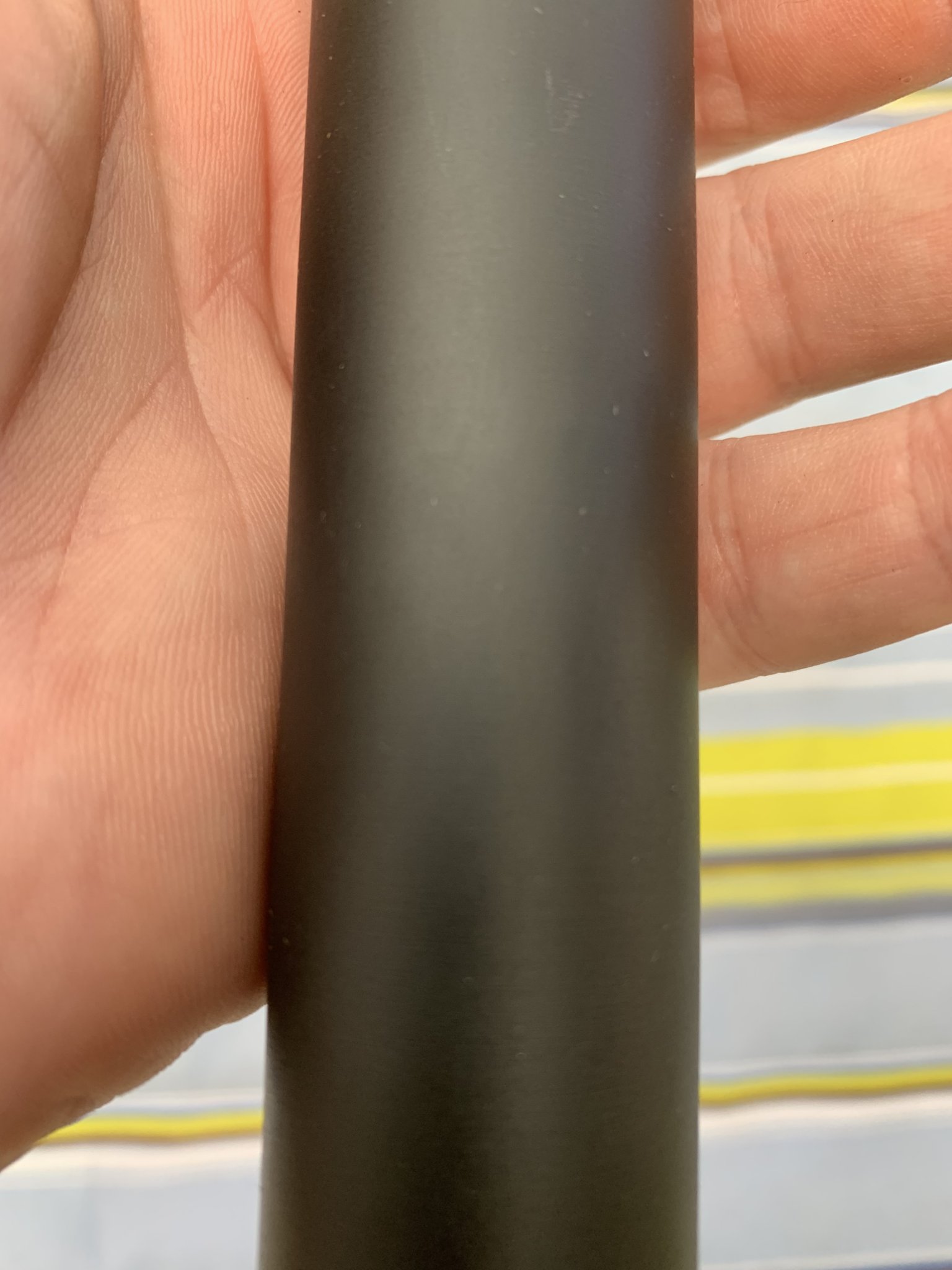

If you media blasted it you could use cold blue. It gives a blasted finish the appearance of parkerizing. And once oiled it looks great and lasts a long time.
Here is a barrel I blasted with medium aluminum oxide then blued it with Brownells bluing cream.
