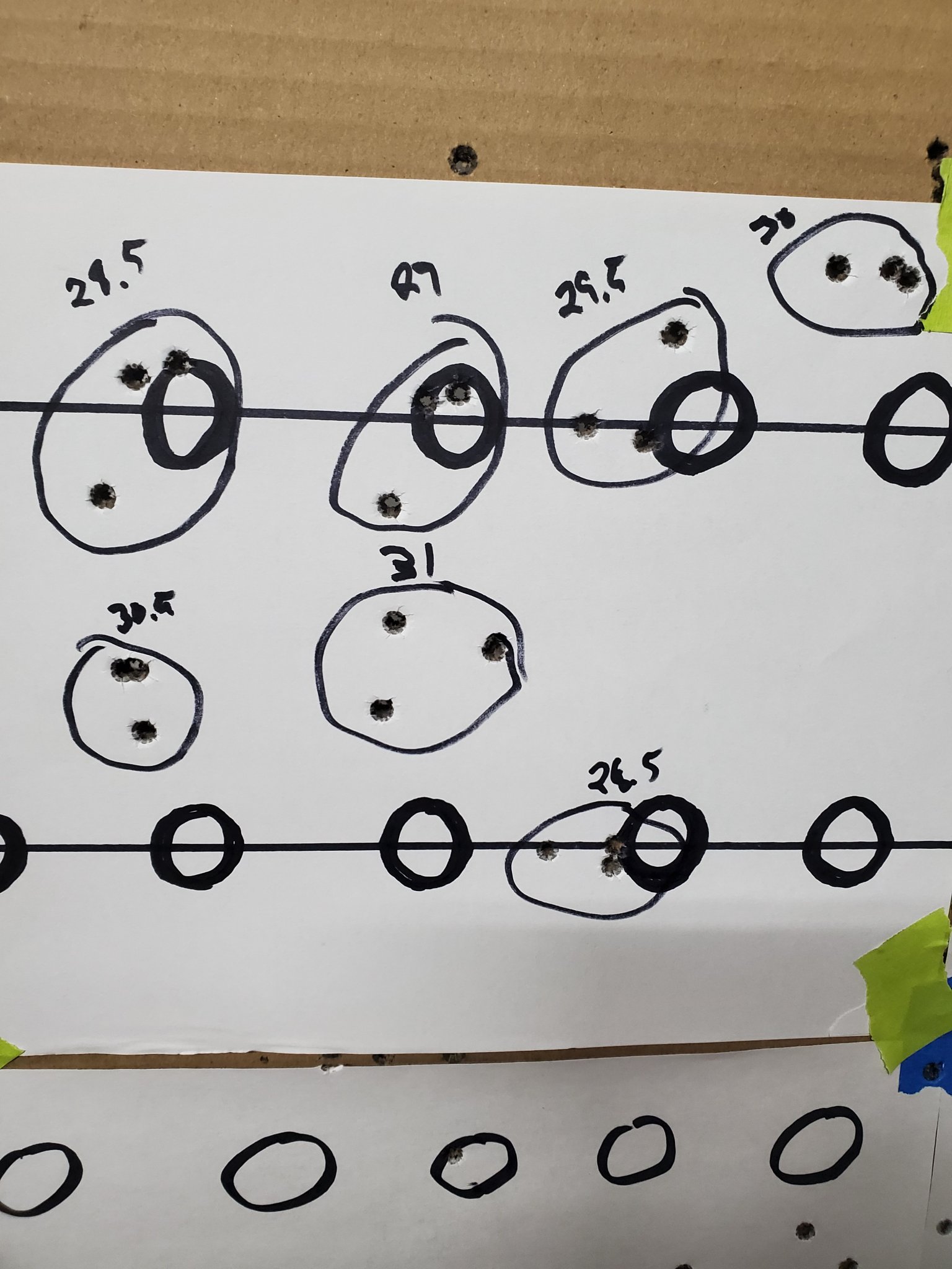

See the 29.5-30g area I don't want to load in...

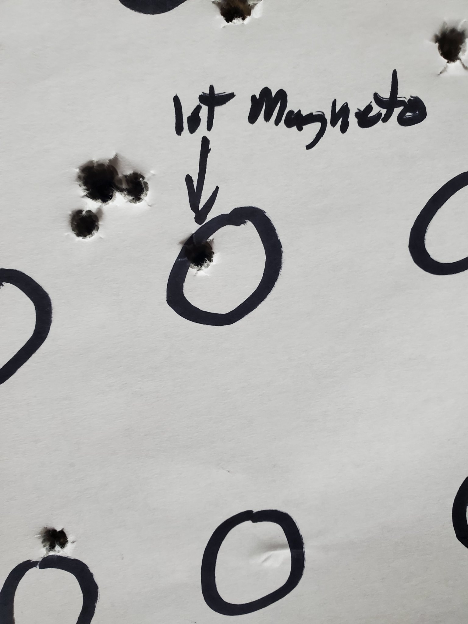

I had 11 peices of brass left so.

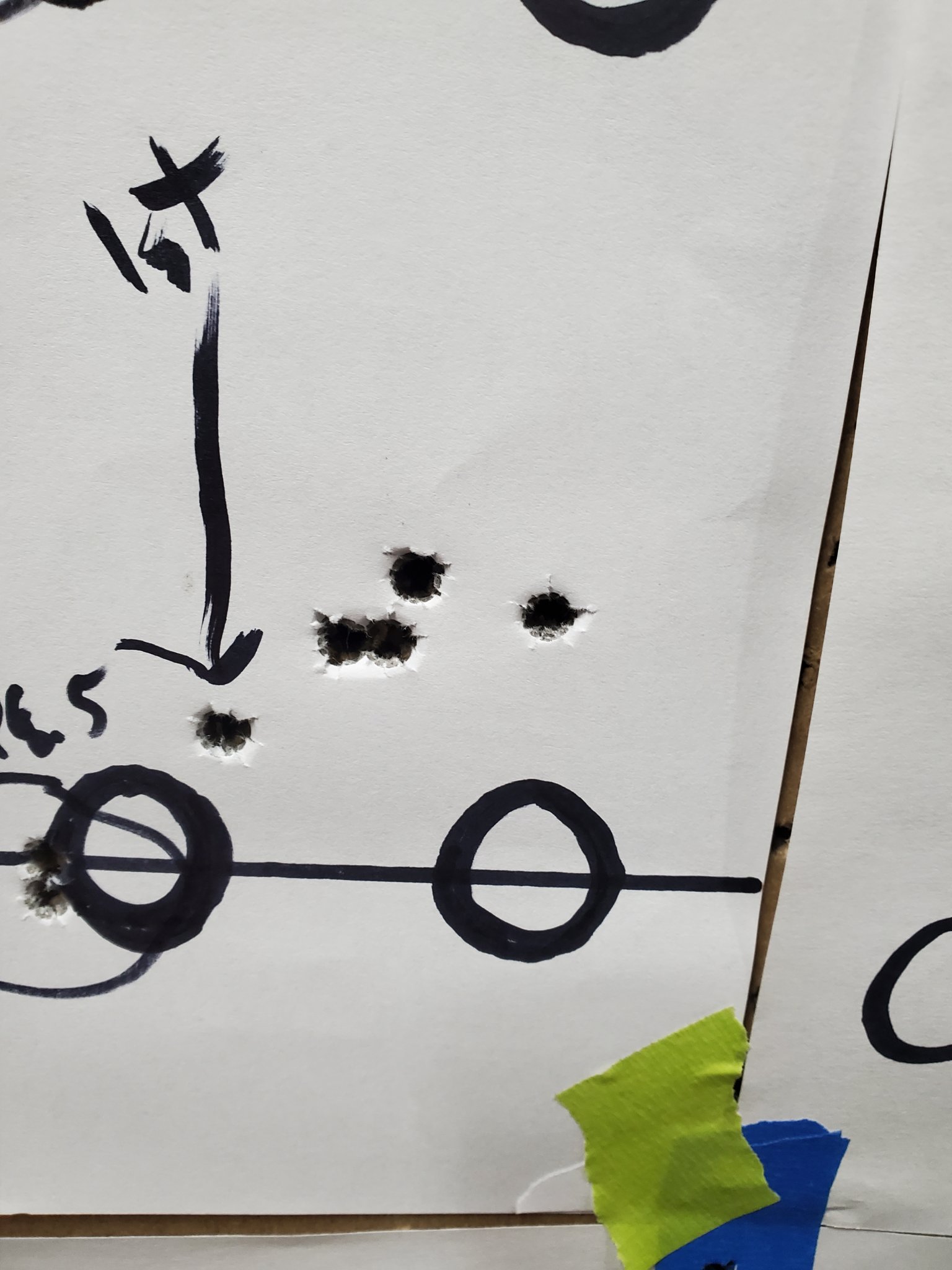

First 5 shot group. I did not clean after the last test.

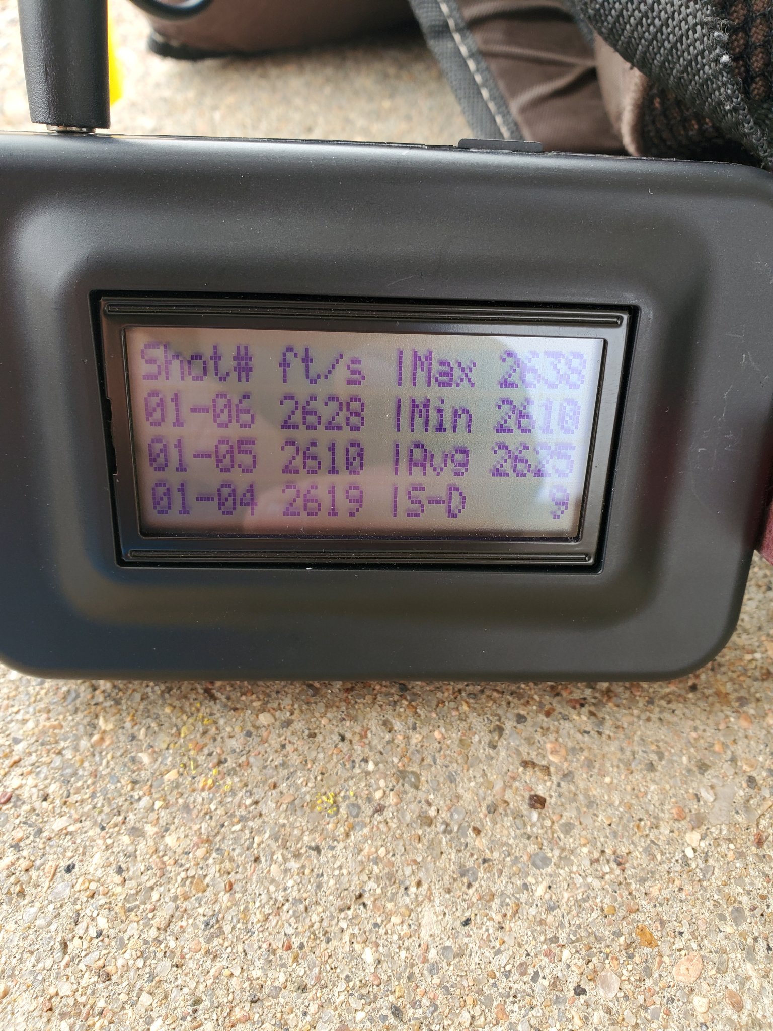

Then six over the chronograph.
Now to load this 40 some peices of brass again with 30.5 and shoot it some more. I might go ahead and bed this barrel. I was not expecting to this much promise out of a 150 dollar thin profile CMMG 6 arc barrel.
Charges are thrown not weighed also. Speedy reloading.

Yes 100 yards. These 100g Speers don't have a really high BC. But they were cheap. Lol. Probably make a great shooting and hunting load.
