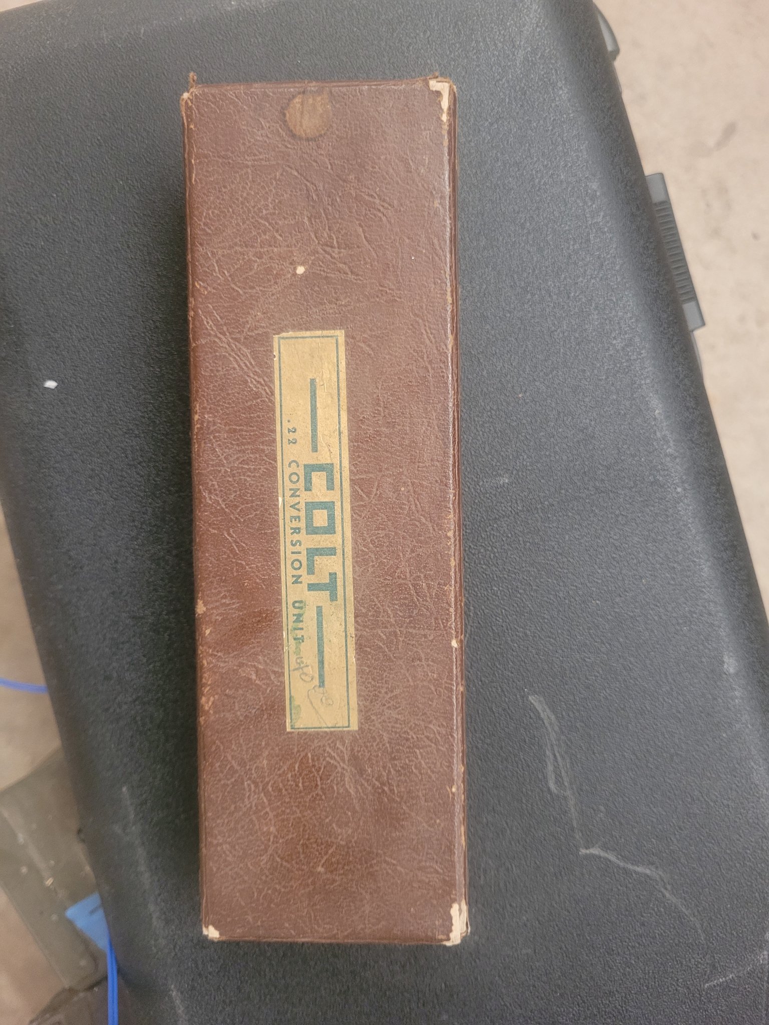

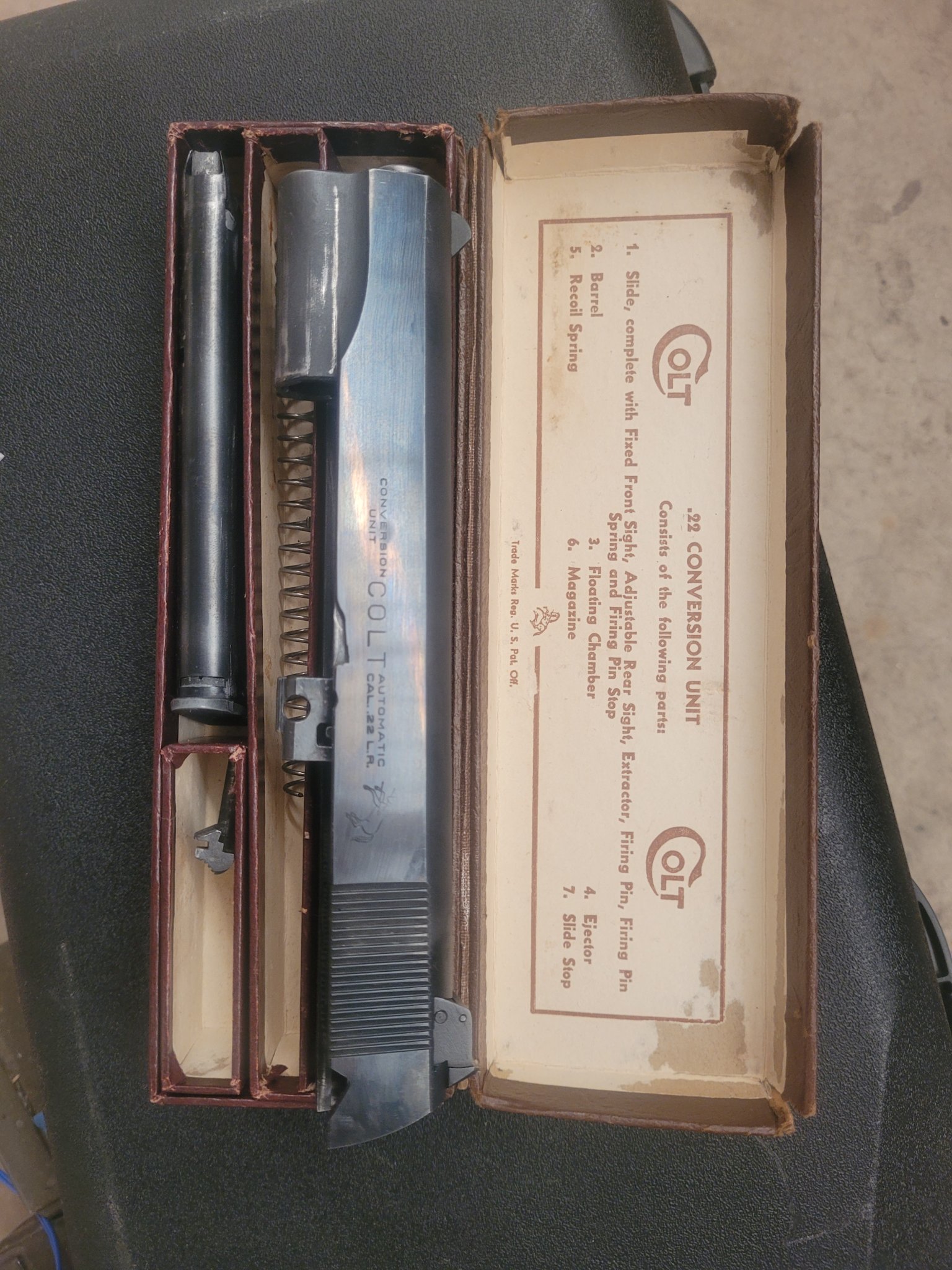

I bought a new Colt ACE at a LGS back in 1979. It was a really nice pistol, but accuracy with that floating chamber set-up mostly sucked. I wound up taking it back to the same shop and trading it for a High Standard Victor, which shot so much more accurately that there was no comparison. My only real regret in trading it was that in today's market, it'd probably be worth a bunch more than I paid for it - but at the time, I was working as a Stateside ferry pilot, and didn't have the money to keep both the ACE & Victor. I still have the Victor, and it's still a very good shooter...
I’m not thinking the colt/Walther is a floating chamber
With that ace I put 500 rounds through it as fast as I could load it and had almost no hiccups. That floating chamber is a wonder worker.
Yeah, mine was reliable, but I never found any 22RF ammo that shot very well in it. Granted, at that time, I was living in Wichita, and didn't have time to work with the ACE much until I'd moved back to the farm in western Kansas the following spring. Once I'd decided it wasn't going to print decent groups on paper, I was done with it. I saw an article in American Handgunner IIRC years later on an ACE that a noted pistolsmith had worked over in an attempt to improve accuracy, but it still didn't hold a candle to the way my H-S Victor shoots. The floating chamber was designed to produce enough recoil impulse with 22LR ammo to reliably cycle a 1911 slide, and it was very successful in that respect.

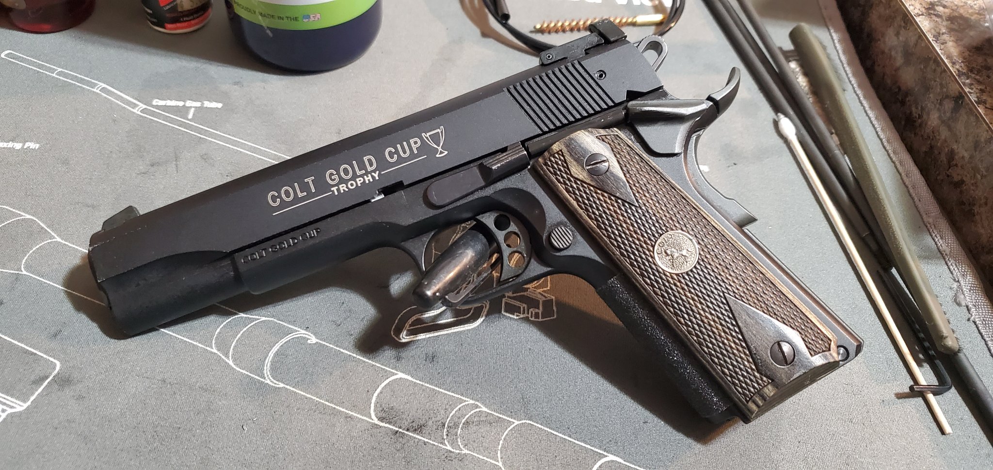

I got one a few years ago. My son loves the thing, and will mag dump repeatedly if I don't keep a close eye on him 😆
I put these grips on it to dress it up a bit. It's a nice complement to my 45ACP version I carry.

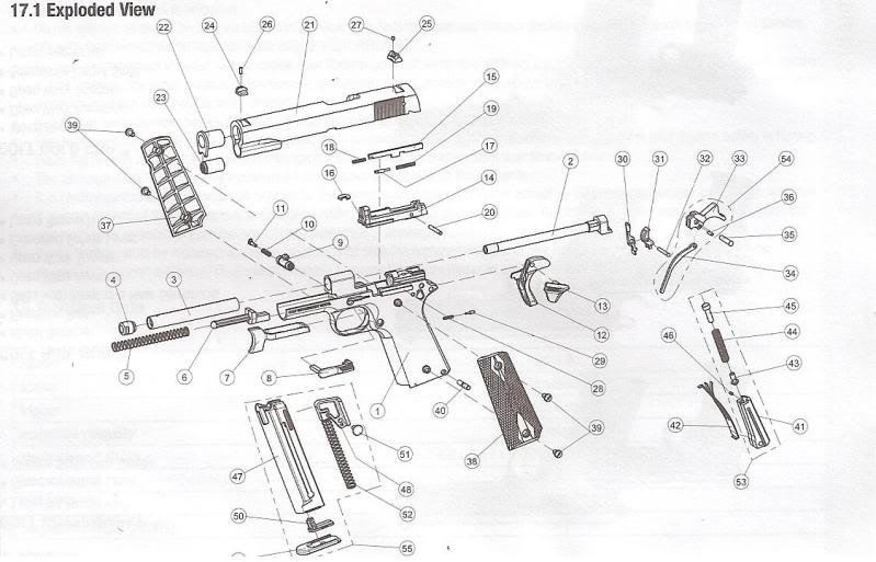

And down the rabbit hole
New Dawson sight
Flat trigger with over travel adj
Full length recoil rod and buffer with new spring
VZ grips
Slide and cylinder sear spring
Mag well and main housing
15 round mags
