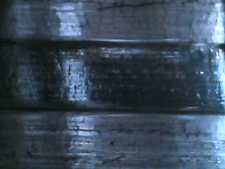

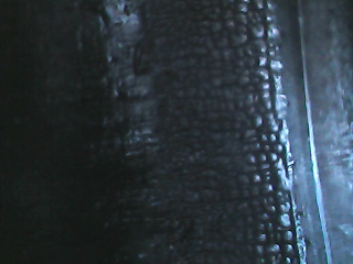

Had some gift cards to spend so I found the Lyman bore scope and have been messing with it. Lower pic is the beginning of the throat I think, and I believe that is what’s called a carbon ring. Haven’t spent much time researching bore scope images and wtf I’m looking at or should be looking for. Probably one of those deals where I was way happier before I saw this lol! Upper image is farther down the rifling, seems like I saw lots of carbon fouling for a few inches past the chamber area. Anything else you see or suggest paying attention to I would appreciate any thoughts.
I too thought I was doing well cleaning. I’m using Boretech Eliminator, brushes, and patches.
My Lapua 6.5 creed brass is short and I can’t get it to minimum trim length and I believe this caused a nasty carbon ring.
I didn’t worry about it much until I tried to find the lands again and was coming up extremely short. I could force the tool (Hornady) past it but it would jam in the lands.
I have cleaned the shit out of the throat and it’s still there. Just bought some VFG pellets and a jag for those to see if it helps to clear it up.
I’ve been using hoppes elite bore gel, nylon brush, and scrubbing 20 strokes and then a dry patch until I’d get a clean patch. Usually only took 4-5 times to get a clean patch that would just start to show copper and then I’d quit. This would be after 200 rounds or so. This particular rifle is shooting as good as it ever has, so this carbon I’m seeing is pretty disturbing

The first picture looks like a pretty well used throat. Heat checking and cracking; while it may look bad, it's pretty damn normal. Until it checks bad enough to cause pressure changes /SD and precision issues, not much you can do other than slow rate of fire and shoot fewer rounds when barrel is warm.
That second picture though.... Holy $h!+ Batman! Looks like your rifle got an STD from some back alley ammo! Lol. I've never seen anything even remotely close to that in a rifle; only in Sex Ed 20-some odd years ago!
On a more serious note, I've started using Kroil on a bronze brush similar in size to the neck area of chamber on a short, chamber style cleaning rod. For a 223/224, I use a .243 brush and for 6.5mm I use .30cal brush. I spin it several times (working in/out slowly) when it's just started into neck and slightly into lead/throat.
That has kept my carbon rings in check very well and, unlike full on cleanings, seem to have very little if any effect on CB/SD/Groups the next outing. Process take 2 min or so for each rifle.

I have to ask because it's difficult to see from the picture. In pic 2, is that smooth section on the right the neck and the alligatored/bubbly/warty section the Freebore/leade where the rifle shot l should be starting?

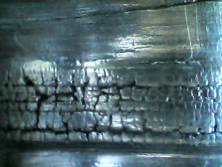

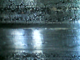

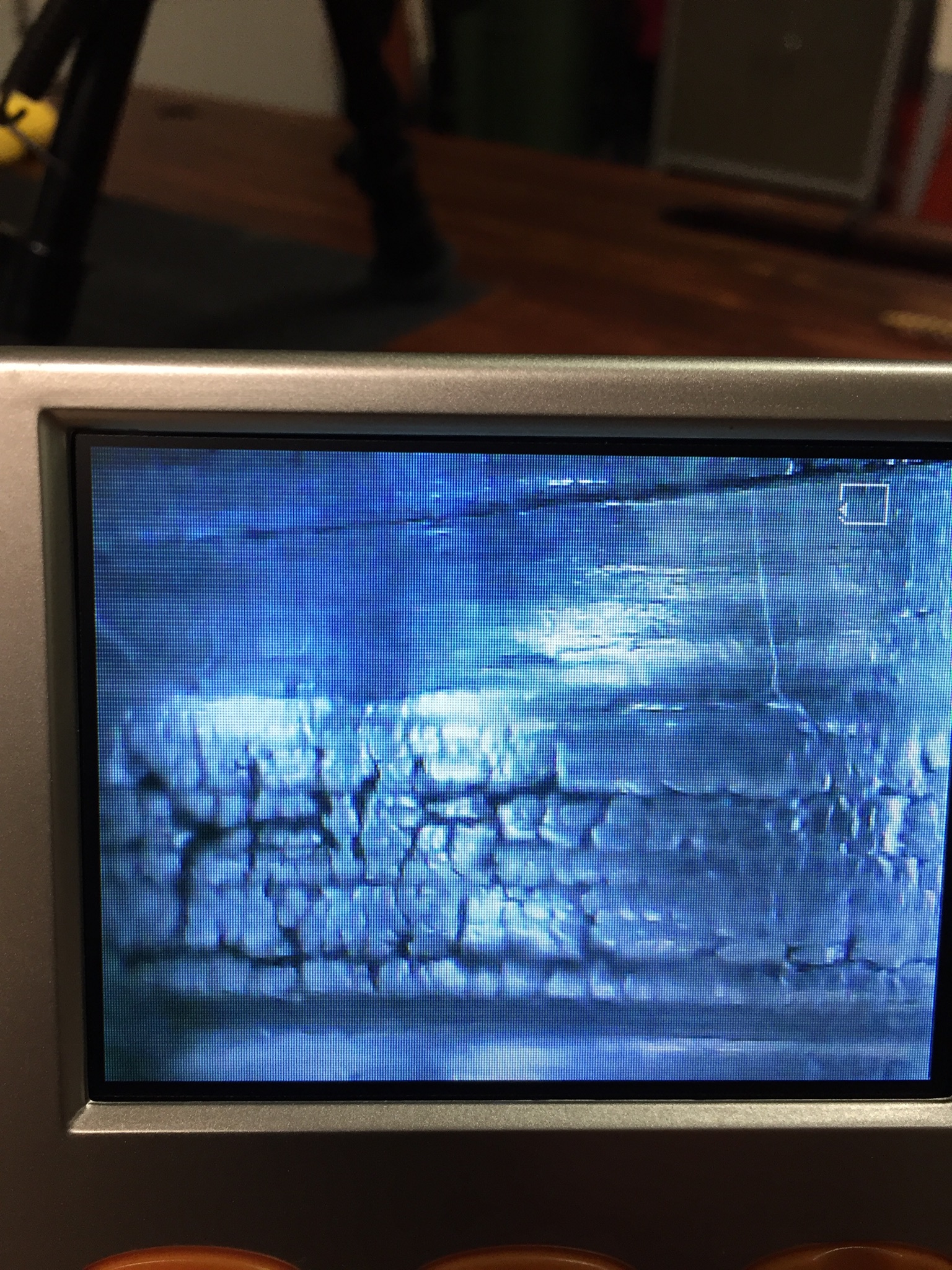

Shit, that throat looks damn near virgin compared to this 6.5 CM barrel at 2000 rounds, just before I replaced it at 2500. It’s impossible to keep a cheese grater free of carbon and copper.
The Lyman, IMO, is a great scope for the money. I got one when I suspected a carbon ring & it showed it clear as day.
I should have worded my original post better; I completely agree and meant more "normal" throat. The ops first pic looks fine to me. The pics you have look like what I expect when barrel is close to it's last breath.
Yessir, exactly. Great analogy btw! I might need rubber gloves now lol!

I think you might be surprised. A phosphor bronze brush spinning circular (perpendicular to bullet travel/bore) will take out some pretty knarly crap.
But you may get it done faster with Kroil + JB soaked patch on a bronze brush. If that doesn't get it out, you might try Wipeout Carbon remover stuff (don't recall the exact name) then go back to JB/Kroil.
