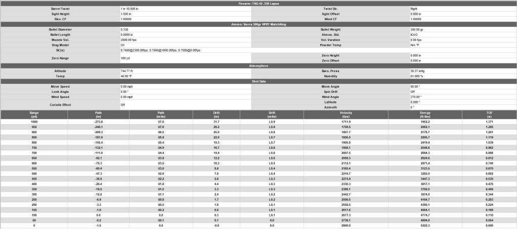

Agreed but I wasn't going to fight that argument here. Did want to correct the flight time for lapua. For me the calculated flight time is around 1.371 seconds. With .308 it's 1.733. @1200 it's 2.276 for .308 and 1.742 for .338 Lapua.
TRG-42 .338 Lapua Ballistics Chart
<div class="ubbcode-block"><div class="ubbcode-header">Originally Posted By: Boss334OP</div><div class="ubbcode-body"><div class="ubbcode-block"><div class="ubbcode-header">Originally Posted By: mstang1988</div><div class="ubbcode-body">Would like to see somebody be accurate enough with a .308 to humanely hunt deer at 1000, no offense.</div></div>
