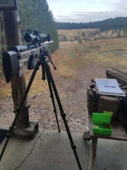

4. My final thoughts are on my tripod setup. I was lucky enough to make the cutoff on the October shipment of Pig0311 tripods from hog saddle. This is the first tripod I have shot off, I usually shoot prone or bench so its time to get out of my comfort zone. This was my 2nd time with this setup, and was much worse than the first time. My range has 40%- 60% IPSC torsos at 330, 420, and 500 yards. My first time out I was able to figure it out quickly, not so much this time. Again shooter fatigue set in, blurry vision, shaking more than before, dehydrated so my heart beat was more noticeable. Are you guys shooting off tripods w/ a sling to help control all this? I tried it and my TAB gear PRS sling was to cumbersome to get in a good shooting stance. I found it easier to just lean into the tripod while pulling the rifle back into my shoulder. Was still an issue, and I have lots to learn.

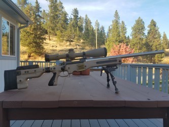

All in all it was a great day at the range. I got out of my comfort zone, and was shooting next to Nick, our local club president, who is also very competitive in PRS. So it was cool to have lots of misses and look like a noob next to a pretty accomplished shooter. Anyways, thanks for taking the time to read this and giving me your thoughts. If you not getting off the bench and prone, you should be.

3/4. I haven't used the PIG tripod. I've used Manfrottos and I currently have a Feisol. Since my Feisol has the Really Right Stuff leveling base, it's not a direct apples to apples comparison, but I used a Hog Saddle and Manfrotto ballhead on my old tripod setup. When I shot off a tripod, be it standing, kneeling, sitting, whatever, I used my sling to help stabilize the rifle. There are a couple of ways of doing it. You can unhook the sling from the rear of your rifle, run it between the tripod legs, and hook it to your belt with a carabiner. Moving your beltline forward or backwards slightly would increase or decrease the tension. The other technique is to wrap the sling around one of the legs and grip the wrapped sling. You can increase or decrease tension by simply twisting your hand. Take a look at the pics for the sling offered by the Hog guys. They show you what I mean.
Tripod will be more wobbly than prone or off a bench. I've tried every way to shoot off of them and yes, a sling is a huge help but for me, trying to hook it to a belt was more trouble than it was worth as well as once you set it up, moving out of that specific position caused the sling to now be too tight/too loose. The best way of utilizing a sling I've used is to learn to candycane the sling to the tripod on the weak side (left if you're a righty) side. Additionally, the first mistake people make with shooting off a tripod is to then lead with their weak side foot creating an angle on your upper body; instead lead with your right leg/foot and keep your torso/shoulder square to the rifle, just like when shooting prone. Also DO NOT push forward with your body onto the candycane'd rifle in the rest. Make contact while square and pull it back to remove any slack and kind of 'hang' there, again, alot like prone.
