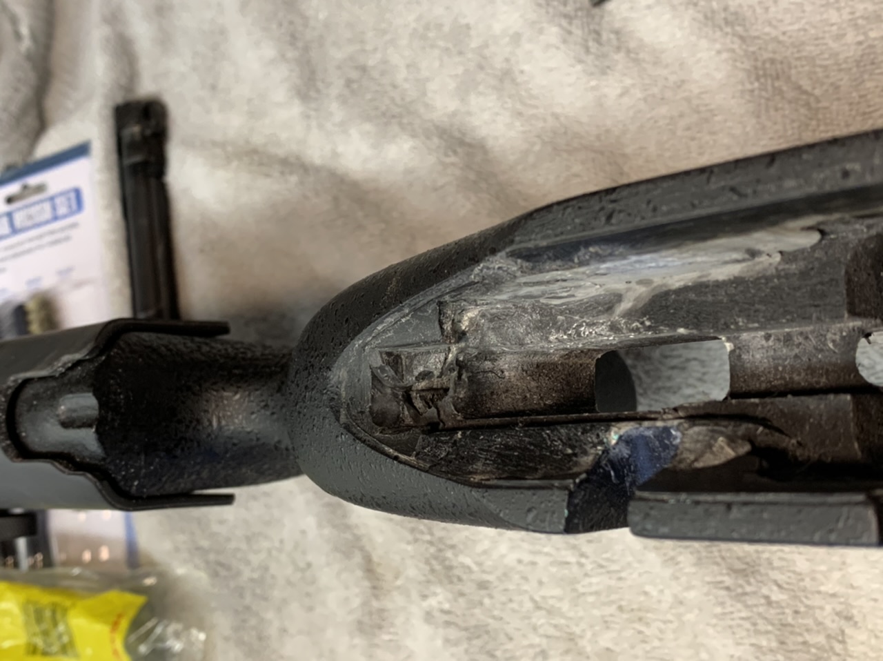

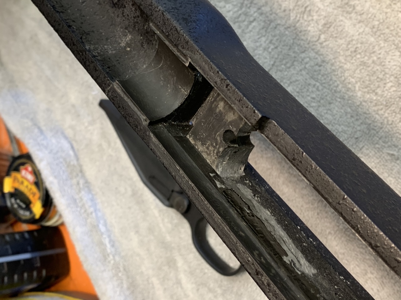

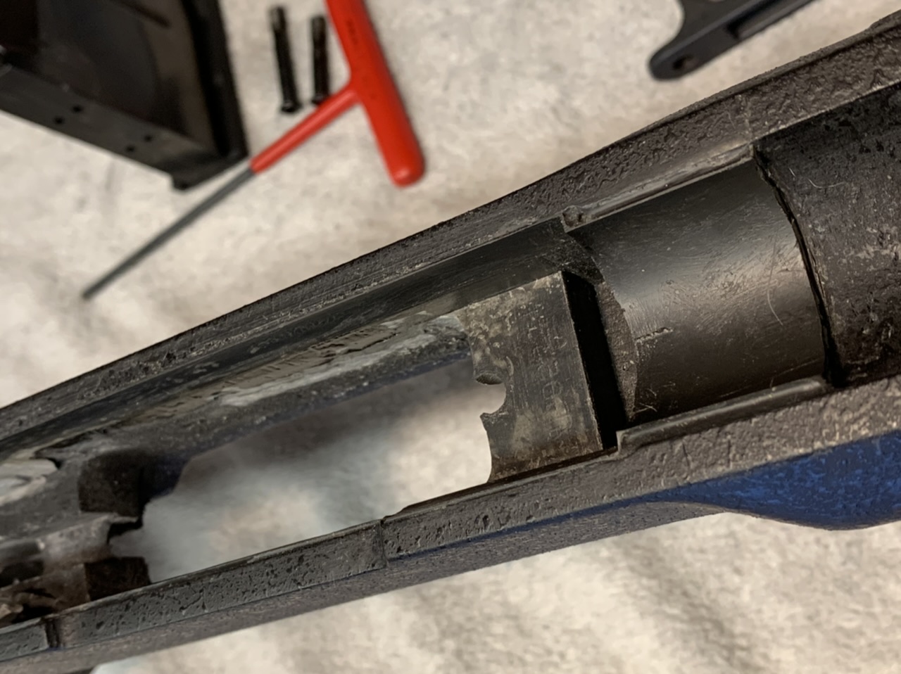

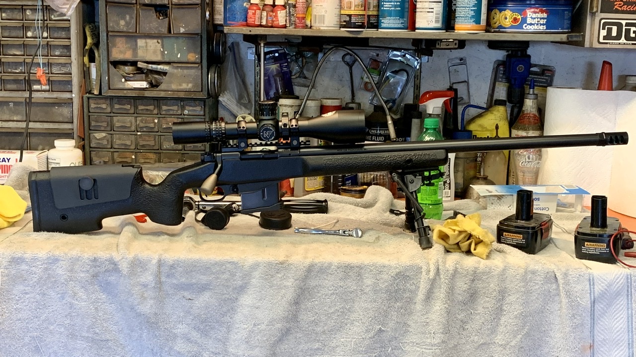

I recently upgraded my fathers FN SPR A4 with hinged floor plate to an A5 with TBM. The entire kit from Midwest Gunworks was 699 with two mags. Did the bedding job myself (way easier than anticipated) and it came out great. I would have had 750 easy just into the TBM and inletting alone. Not to mention your current stock is worth some coin on the back end of the project.
