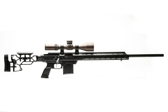

I’m looking to update/change my 300 Win Mags look with an updated chassis. I’ve been looking at the Tac21 and wondering if anyone has any thoughts. My current chassis is AI and it’s been great but with all of the modular designs out, I think it’s time for a change. Although it states there’s no bedding, I’ll be taking it to a smith to get it installed correctly the first time.

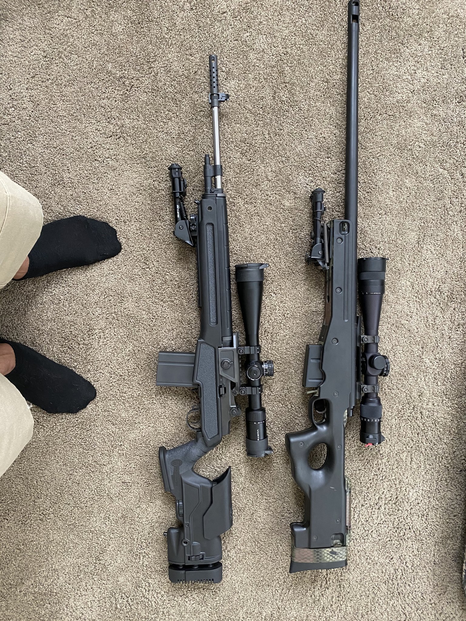

I have a 30-06 build with a Tac-21 and I absolutely love it. If you like the looks, you won’t be disappointed. I have the “Remington” version that came with their Tactical Chassis Rifle. I got it on clearance last Black Friday for an absolute steal. It’s the same chassis except is has Remington engraved on the off side and it takes the 3.775” accurate mags. Lots of room in the mags but they’re harder to find. I wish I had the 3.715” mag model for my purposes. The Gen2 upgrades would be nice to have, especially the mag release. I’ll be buying the 15” MLOK forend to upgrade mine. People who don’t own one comment on how it would be a pain to remove the butt all the time but it’s stupid simple and easy, and it locks up like a bank vault when it’s together.
I plan on buying another for a 223 build.

Put a 1.5mm/0.060” shim in the front of the magwell, and the 3.715s will work fine.
