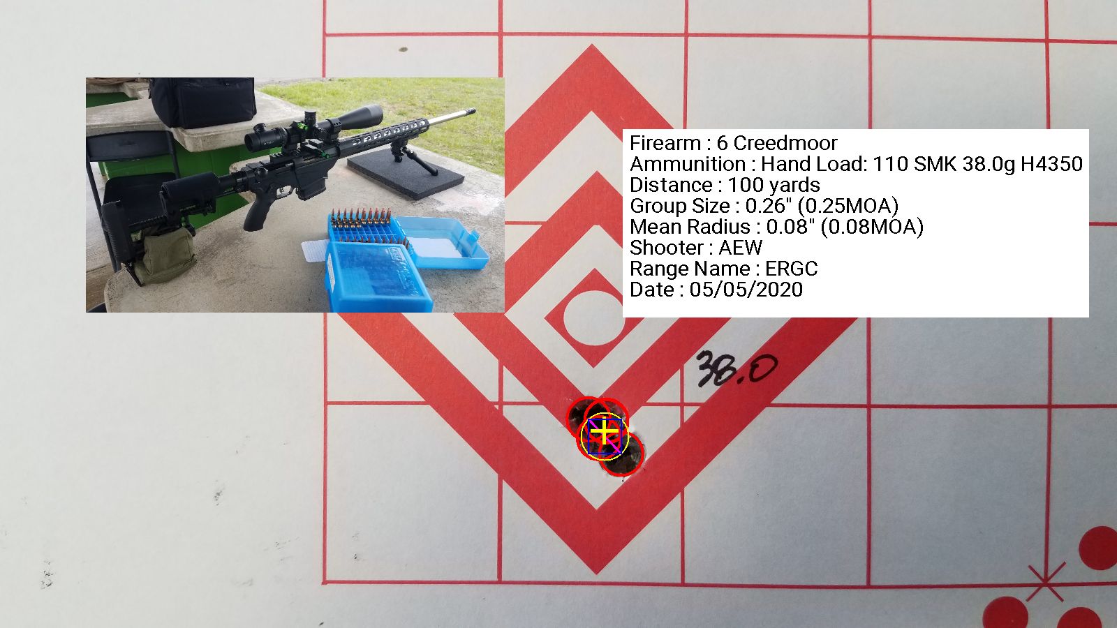

As a point of comparison, my 6creed, which I’m intentionally loading soft in a 27” barrel, goes 2900 with 37.5 Gr of RL16(identical to H4350 in burn rate). Last time I checked the throat I had zero erosion at just under 500 rounds. You can have speed or you can have barrel life, not both.

This was my 6Creed load and out of my Bartlein GAP spun barrel, I got 850 rnds before it went south. Also had .060 of erosion when I pulled it. Velocity dropped 50fps and groups opened considerably. Had the bbl scoped and throat was toast. There was fire cracking 6” up the bore. I switched to 6XC and 115 DTACs @ 2920 in an attempt to get better bbl life and got 1400rnds before bbl went south in the middle of a major match. Love 6mm but there is a price to pay running one at high velocities. No free lunch.
