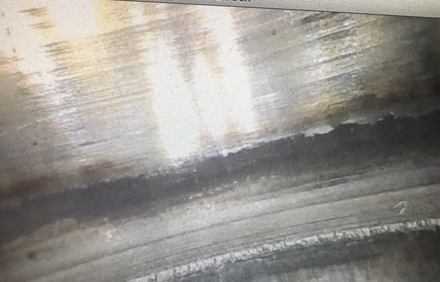

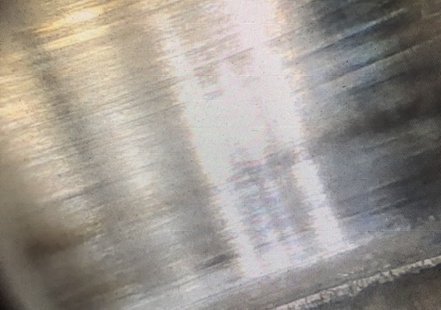

for most people its a measuring issue or cleanliness issue
the barrel needs to be pretty clean because carbon in areas will cause short measurements, and most "gun cleaners" suck something fierce at actually getting carbon out...ive seen really dirty barrels deep cleaned and the lands be found .050"+ further away than the owner thought they were
also depends heavily on the users rate of fire, and how much he torches the barrel...really hot loads fired slowly wont wear as much as light loads fired rapidly, etc
ive measured before leaving for a 2 day match on a clean barrel, then fired 250-300 rounds, pushed a couple wet then a couple dry patches (what a lot of people consider "cleaning"), remeasured and gotten a shorter measurement than original...re-clean the barrel good, checked with a scope, and then the measurement is .008 longer than original
couple nights ago, i wetted this chamber w/ 75-100 rounds to clean the neck out...with wipe out + accelerator for 45 min, probably 5-6 wet patches over that time, then pushed a nylon brush for 10 strokes, spun it for ~60sec ...and looked with a scope...
then i wetted a felt patch with vinegar+h2o2, spun it in the throat for 30 seconds...this isn’t uncommon for what I’ve seen in others either
of course you will always have barrel to barrel variation in caliber, loads, and steel...so its possible you scored a great one and it lasts for forever lol win win

I got off the phone with my rifle builder and we both agreed im not aggressive enough in my cleaning. likely the cause for sure. I used the tool and the bullet seat/feel method and got the same measurements but with the scope, the gun "appears" to be "clean" but for sure it isn't based on what I have been doing.
