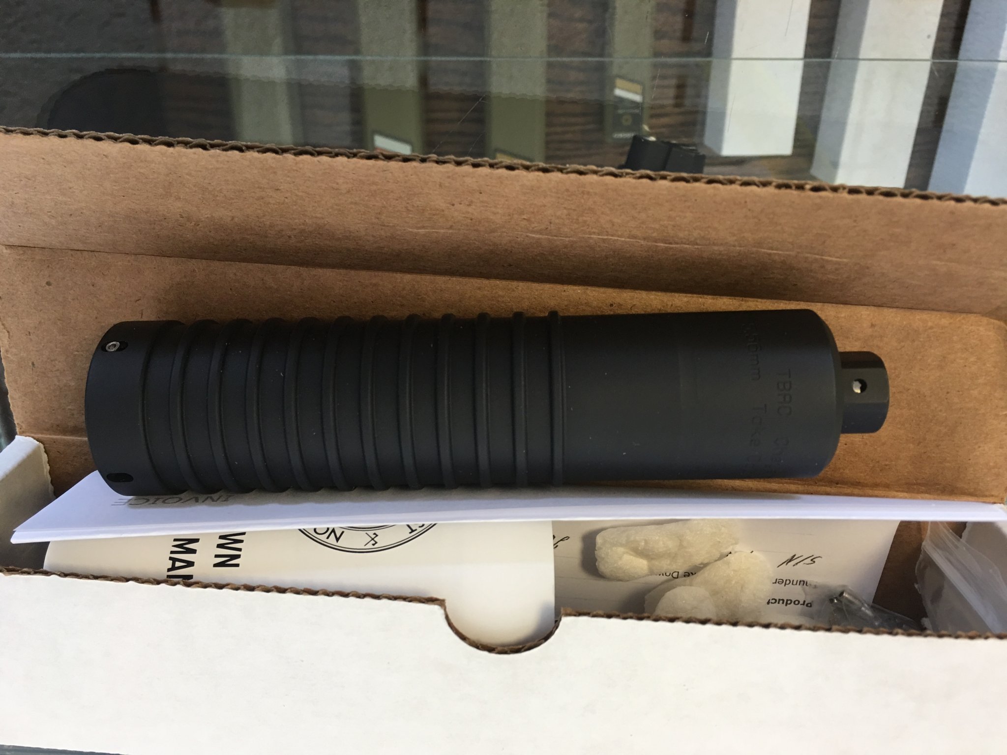

I’ll get a review up here soon for it. Just picked it up from my dealer a few days ago and I’ve been out of town since and haven’t had a chance to shoot it. Really well built though and I love the design. I went with the DSU and had it pinned and welded for the one stamp (non)SBR.

I will know more next year. I did get to fondle mine while in jail and it is well built! Heavy doesn’t bother me as it’s going on an SBR and I’m not planning on hiking long distances with it. I wish my SOT had a range so that I could shoot it now. From the videos I’ve seen and the reviews I’ve read you can’t go wrong with anything TBAC.

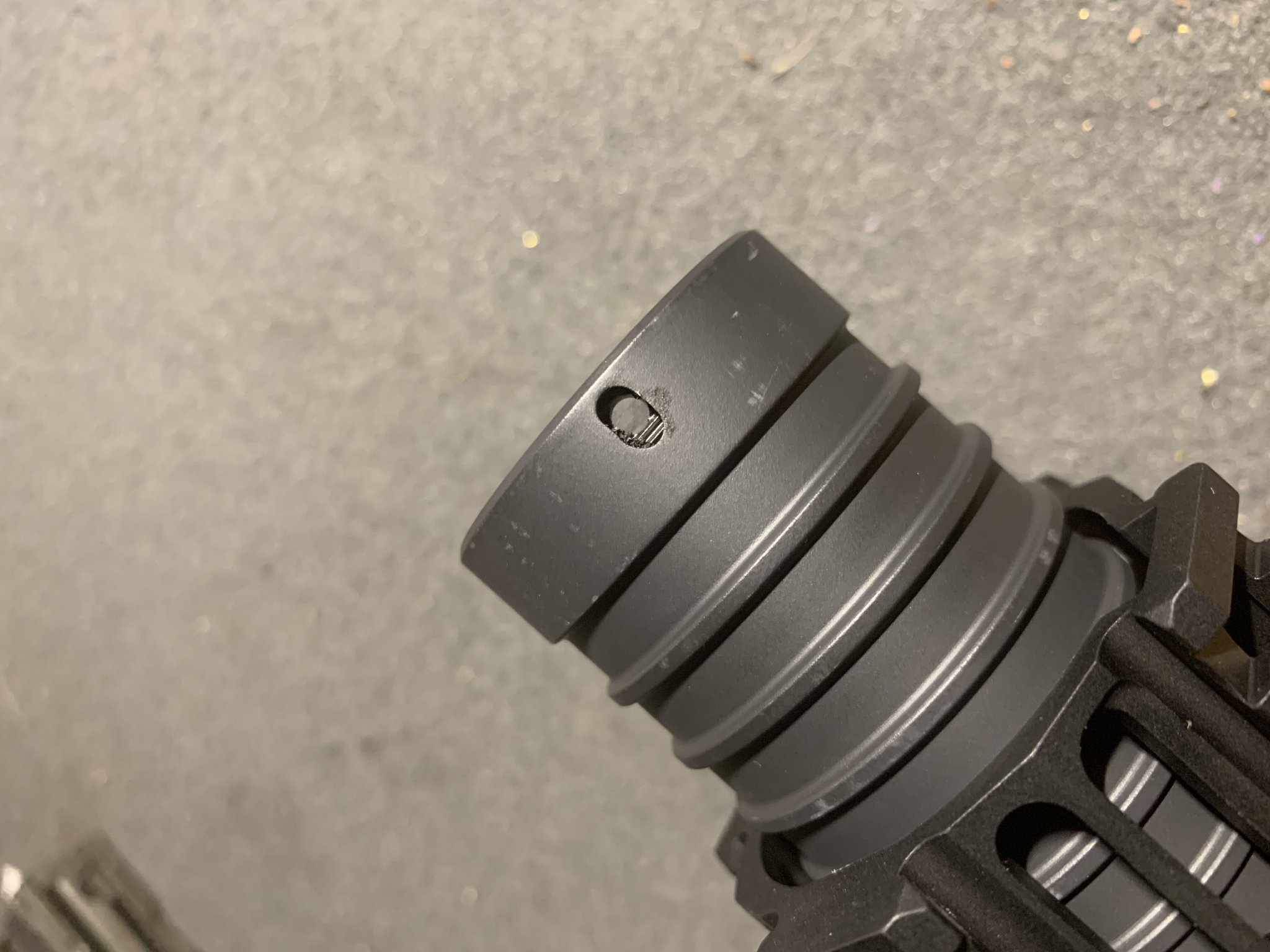

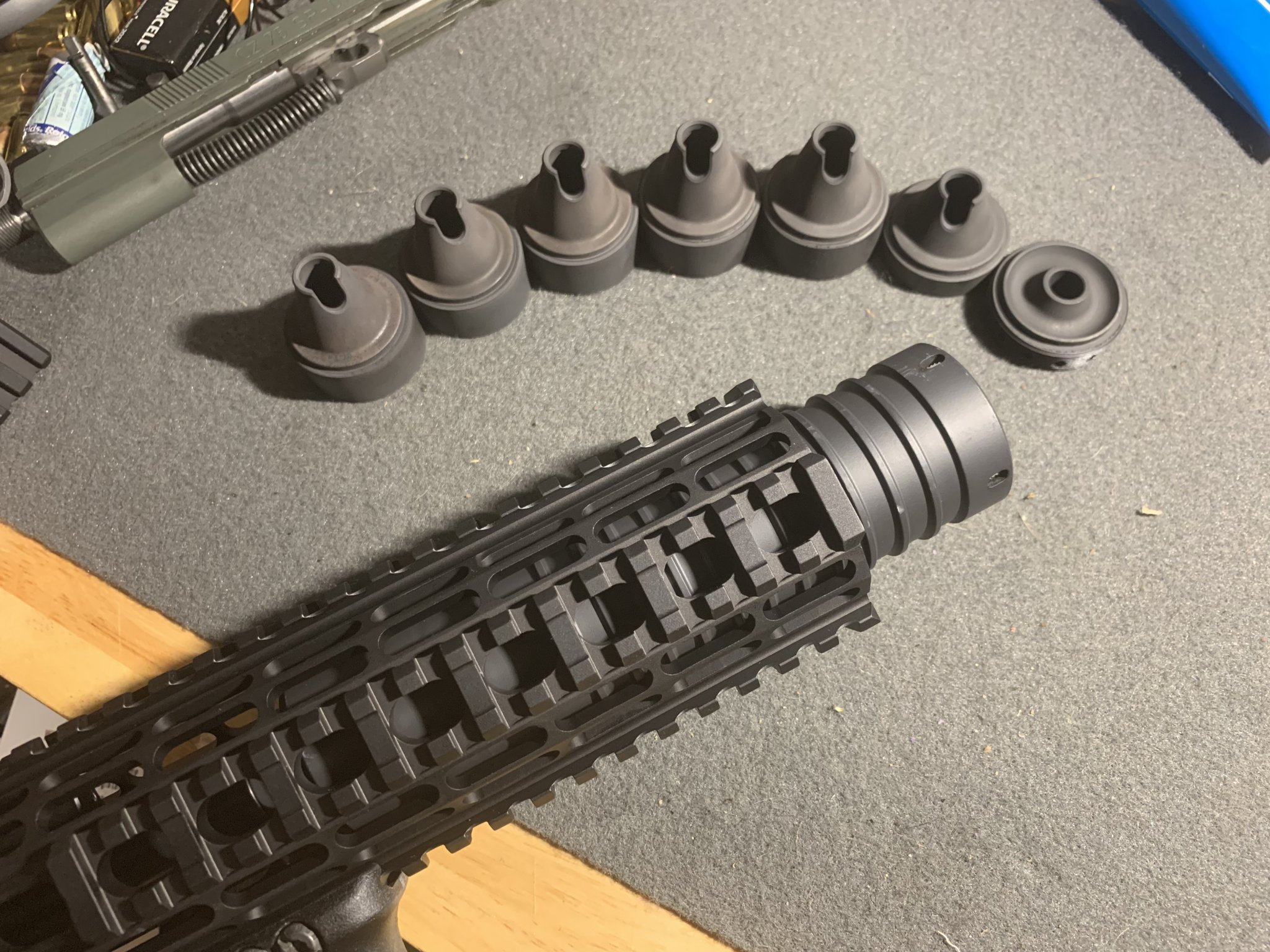

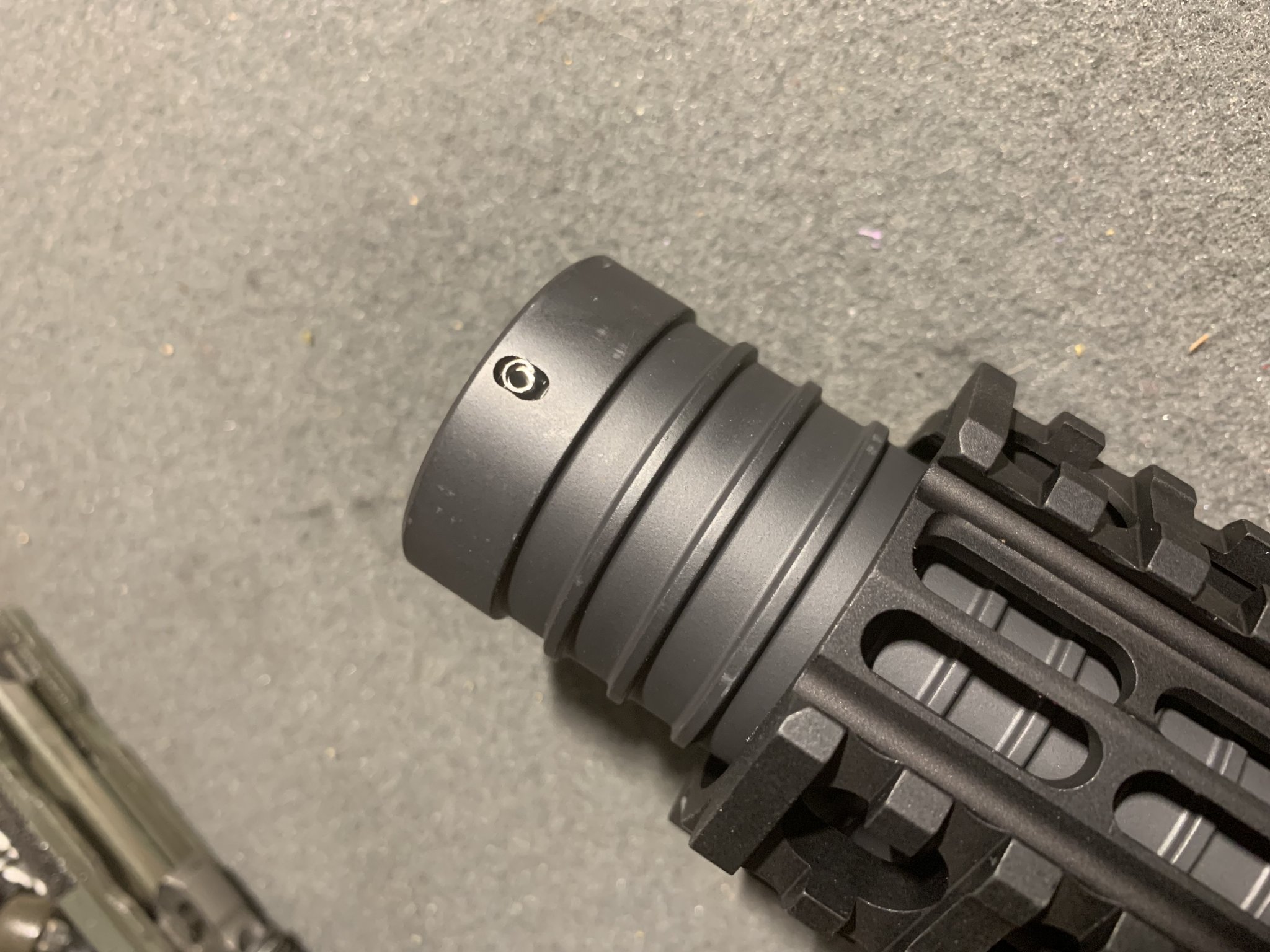

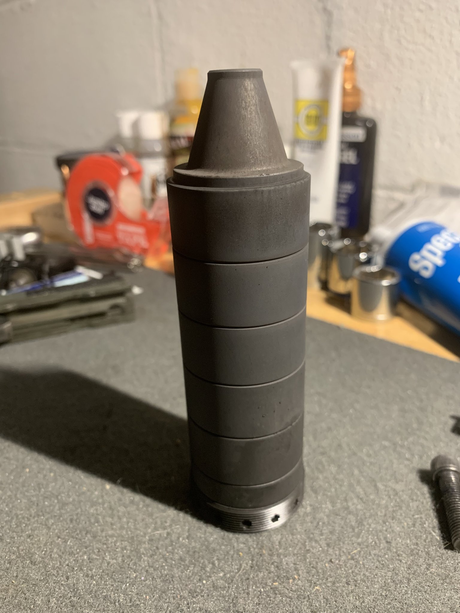

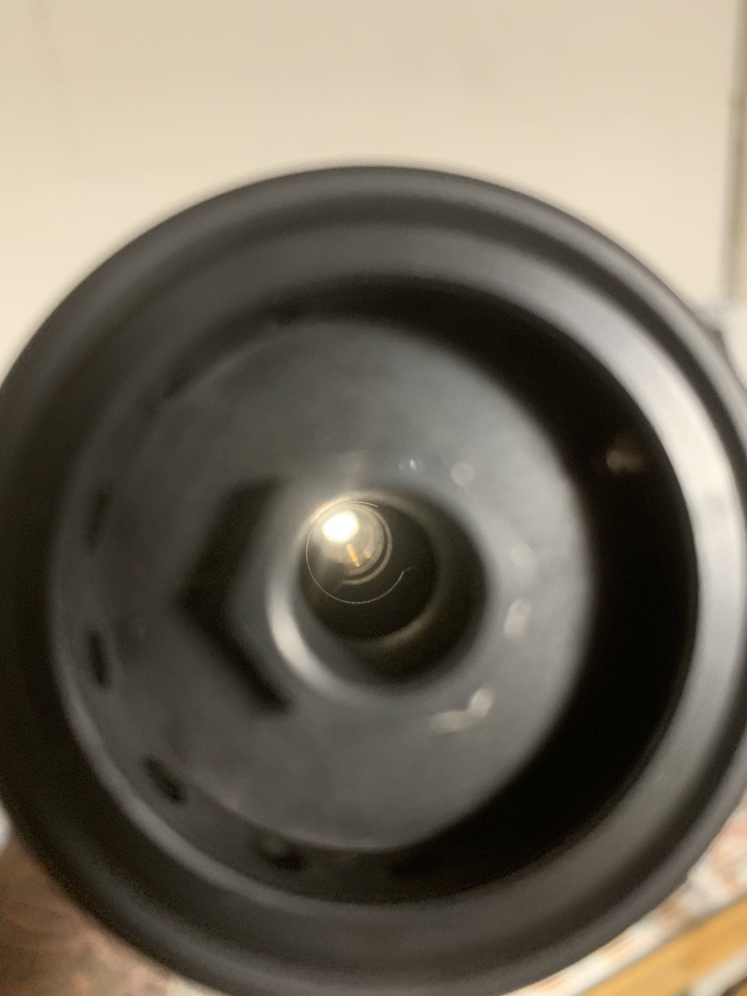

Got some range time today with my DSU. Granted it was just indoor, but I’m gonna get outside on Sunday with it too. The whole DSU system is fantastic. It’s super low in the gas department for a 10.3” barrel. Even though the can is heavy, it is balanced really well on a short barreled system. Seems pretty quiet indoors, I am looking forward to shooting it outside, I’ll take some comparison videos with my other 10.5” SBR set up.
I enjoy the construction of the can, everything is heavy duty. The front end service is cool.

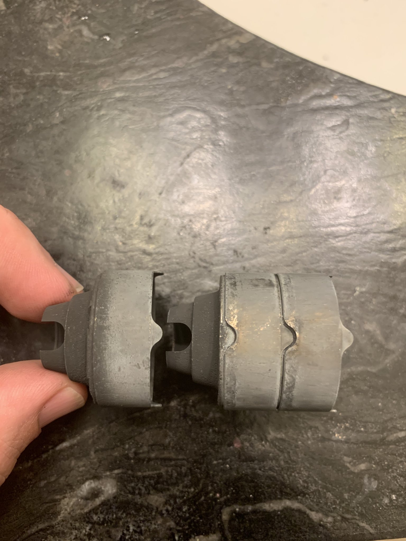

I really only have one complaint, and that’s the inability to maintain alignment with the baffles during reconstruction. Carbon buildup will be different along the stack, and the change in friction causes them to rotate as you’re locking down the end cap.
I have a .45 can from Freedom Armory and during testing they got different decibel ratings and back pressure results when the notches weren’t lined up, so I wonder how much different this effect will be in a high pressure can.
Some sort of groove system similar to what they use would be cool to keep everything in line. B6E89E32-801E-48CA-8457-2776918695D4.jpeg
Aside from that, I have no complaints and I’m looking forward to hammering on this thing this weekend.
I know TBAC recommends a H4 buffer, which I don’t currently have, so I used it with my JP Silent Capture heavy setup today, and I’ll also try a Spikes T2 buffer this weekend.
Some sort of groove system similar to what they use would be cool to keep everything in line. View attachment 7138413

I just ASSumed that it would have similar alignment system to the TakeDown 22 w/ a numbering and a line. They also seem to have a detent of sorts as they kinda 'click' in place when lining them up. Have to admit, I'm a bit disappointed.
Reactions: msstate56
Hello, to keep the price point some features had to be omitted. Here are the engineering notes which might be helpful
The rifles zero shifted less than 0.5 moa after disassembly, cleaning and reassembly, regardless of baffle orientation. This included jumping a fresh
baffle to the front. Zero shift was less than 1 moa after having the stack completely replaced. Solicitation meter requirements were also met regardless of baffle orientation.
Awesome, thanks for the information!
Ha...military proof--" The rifles zero shifted less than 0.5 moa after disassembly, cleaning and reassembly, regardless of baffle orientation".

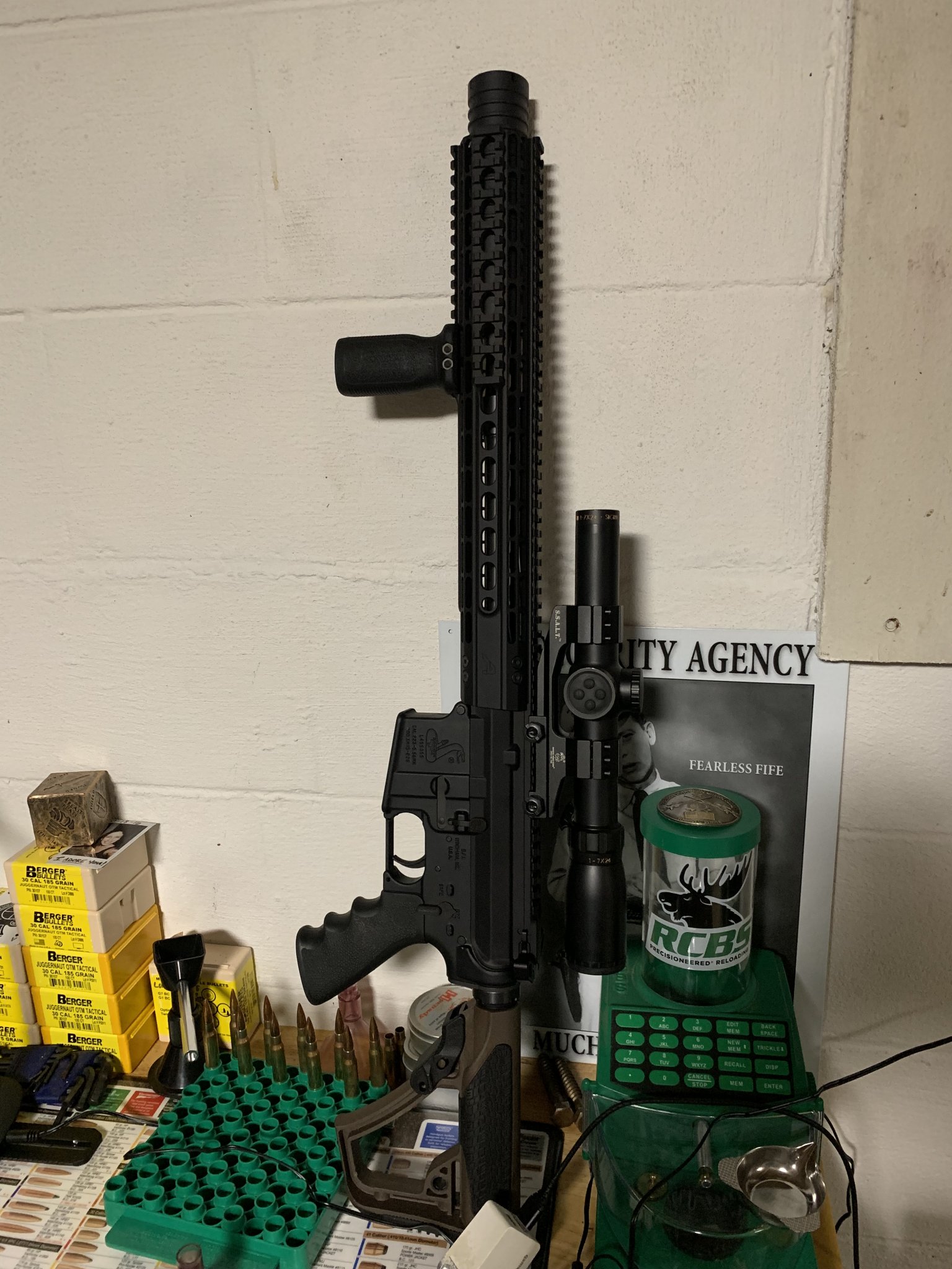

I got my TBAC 556 Take-down on order and supposed to be delivered on Friday. It will sit in jail for a while but I'm super pumped for it. I plan to put it on an 18" Seekins Precision 3G2 rifle with an 18" barrel. I shoot 77g IMI ammo. Anyone have any experiences shooting the 77gr IMI ammo through one of these cans?
I haven’t shot IMI through mine specifically Shawn, but I have shot a couple different 77gr loads through mine and they all sounded great, as well as super accurate.

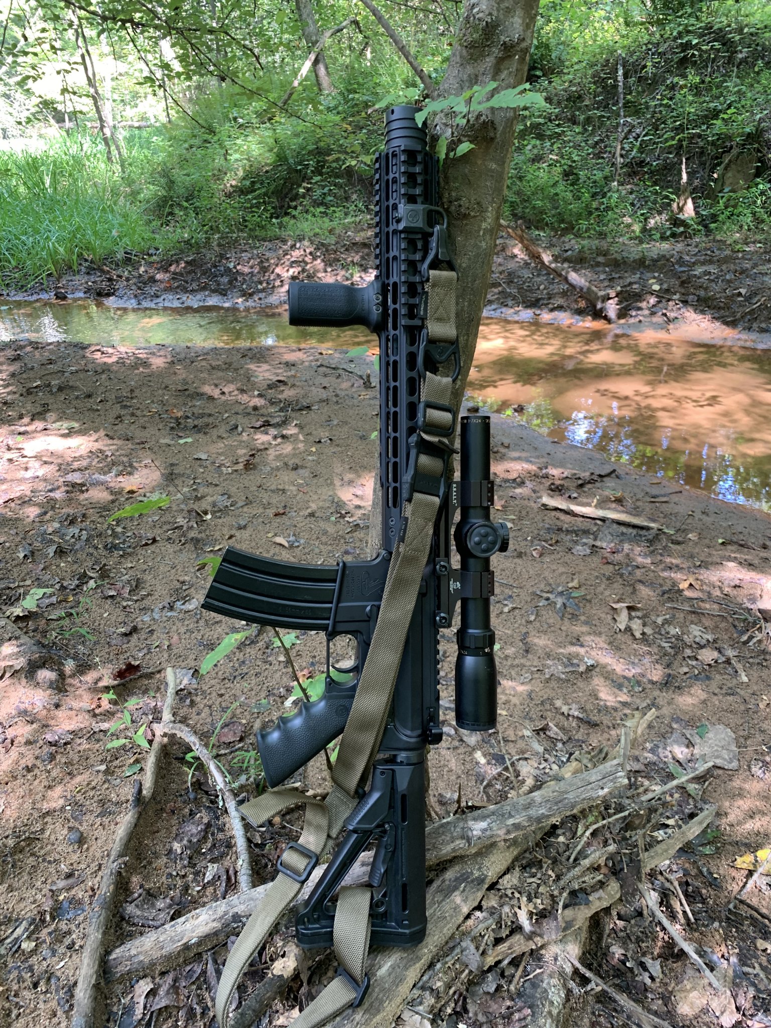

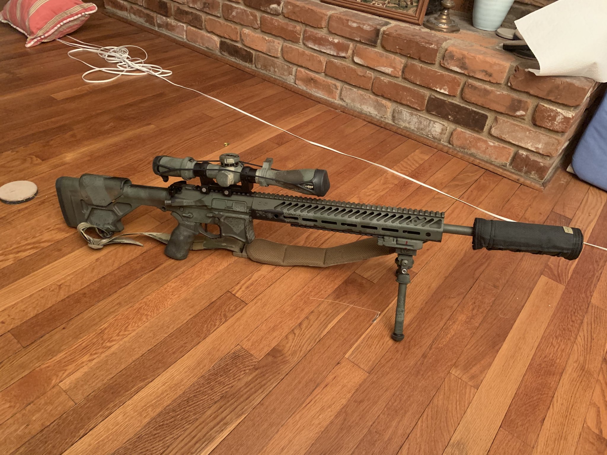

I got my TBAC 556 Takedown yesterday and mounted it on my Seekins Precision 3G2. It is slightly heavy but my rifle balances right in front magwell and that works for me. I got it covered with a Coletac Suppressor cover. I can’t wait to get it out to the range. I am super happy!
Reactions: WirgmanUSMC
I took my time rifle to the range yesterday to sight it in and adjust the gas block. I didn’t get to really shoot for groups and practice. It’s my deer rifle for close sits. I actually needed to dial down a full mil and add more gas. I didn’t figure on that. I must say it was a dream to shoot. The heathens next to me loved it to. 😉
Big ups to the ColeTac cover. I ran the gun fast to see what it would do and the cover did well.
