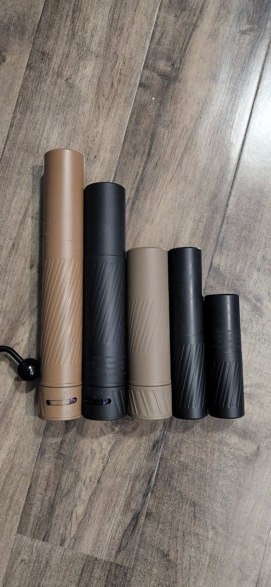

If it was me, I would be very tempted to get the Magnus.
It would have more suppression than your current lineup of suppressors, and the HUB option allows you to stay within the muzzle device ecosystem you currently have. You also get to maximize the value of that 50% discount.
If you want more of an all-around suppressor, the Dominus would be a great choice. You would have to change over to TBAC's muzzle devices for whatever rifles you want to put it on.

Can you use the TBAC suppressor end cap with different brand suppressor bodies? I thought I saw it available as a spare/upgrade from them and thought about using it to upgrade my Dead Air Nomad (which is still setup as a direct thread).
There are no removable thread or "mount' ends, other than the booster stuff in the Fly9.
I was thinking of the CB2BA adapter (link). My thought was that if TBAC and Dead Air are using the same thread spec/pitch, I could convert my Nomad to run off TBAC CB muzzle devices. That has more appeal than Plan B - Area 419 all the things, for my previously stated reason: I'm a lazy sob and just want to "set and forget" my muzzle devices and swap the can around at will.
The CB2BA fits our BA muzzle brake, which is currently the simpler of our two muzzle devices for the .338 suppressors (the other being the SR). It uses 1 and 5/32 inch x 24 TPI threads and shoulders on a taper. The BA interface was introduced, if I remember correctly, about mid 2011. HUB is 1.375x24 and shoulders on a flat surface and is not intended to be the rifle-to-suppressor interface.
Now, if you have a HUB suppressor and want to use a CB brake, I thought I saw a CB-to-HUB adapter somewhere. If not, we will "probably" have one in the future.
Then get a Magnus HUB and run Dead Air KeyMo or XENO setups.
