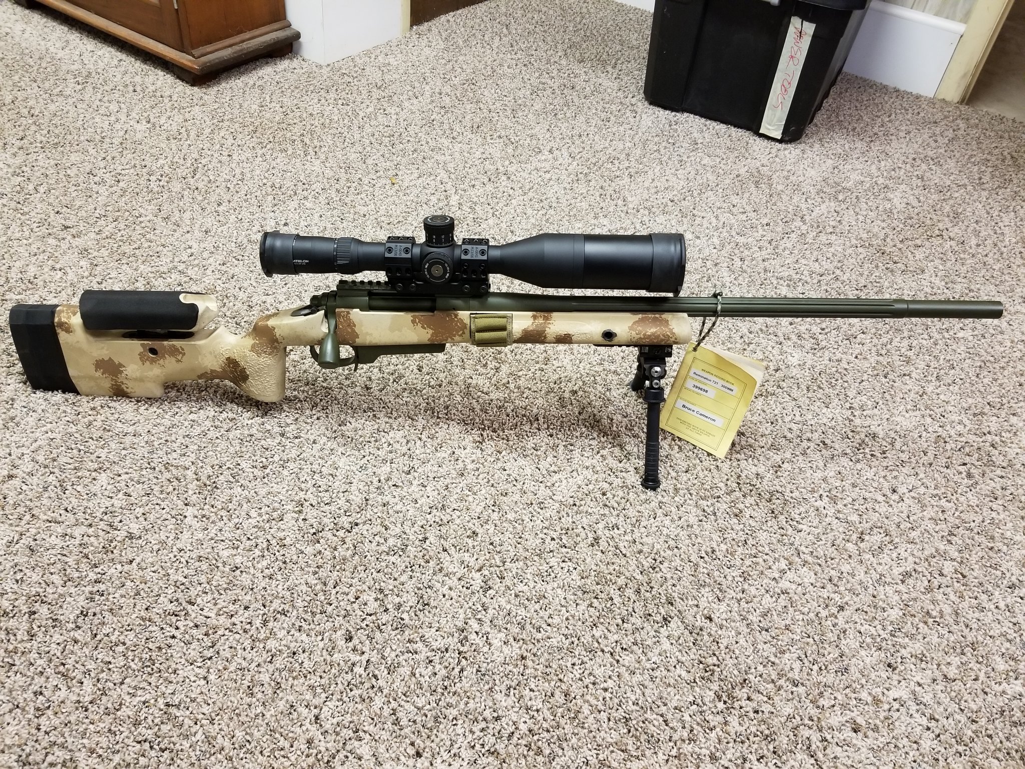

It's kind of apples to oranges but I had RW Snyder turn an old 270 Rem721 into a 300wm.
Before:
7098306
After:
7098308
