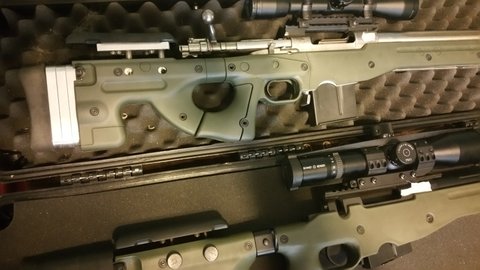

Is that yours?
I wish! It's John's rifle from Sterk Shooting. I saw it posted on his fb page.

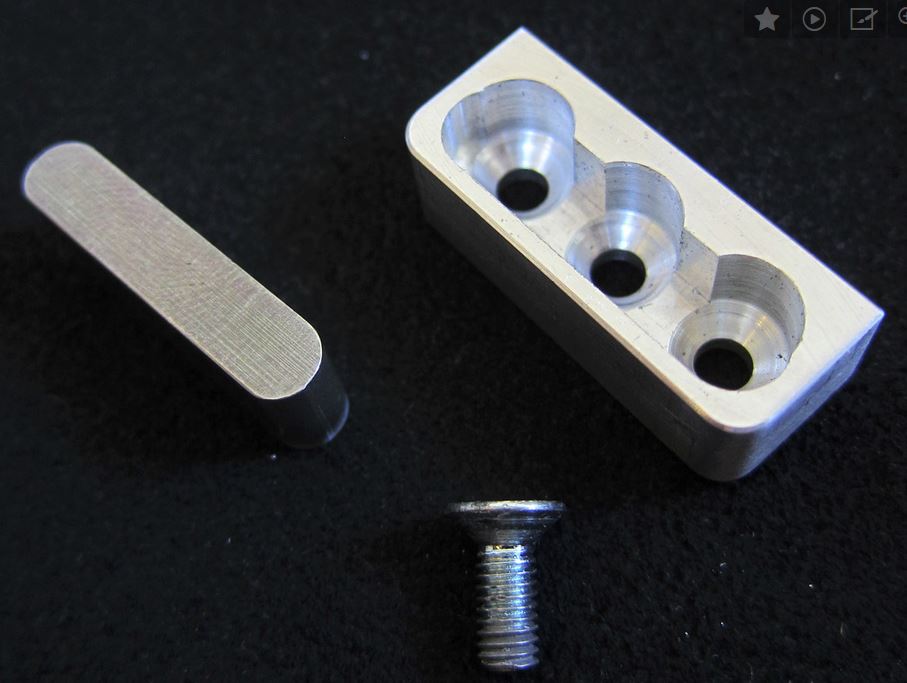

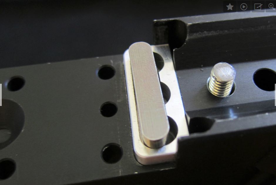

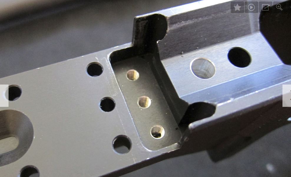

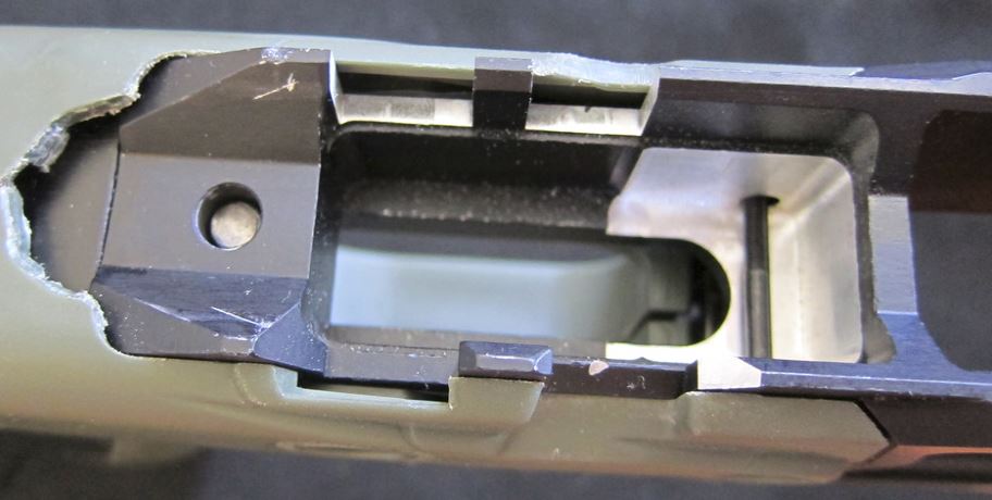

Here is a post he made on it:
"The recoil lug area needed to be worked to suit the Tikka style, a new front action hole (rear action hole worked fine), some material removed for the Tikka trigger, and notches for the Bolt handle and safety. Magazine clipped in and fed without any work."
Reactions: cannoncrossfire

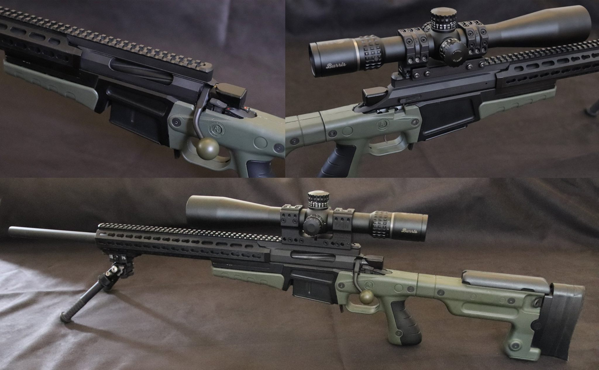

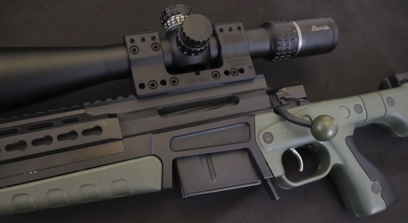

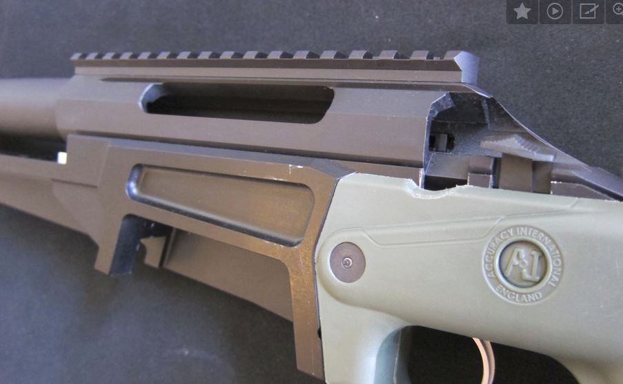

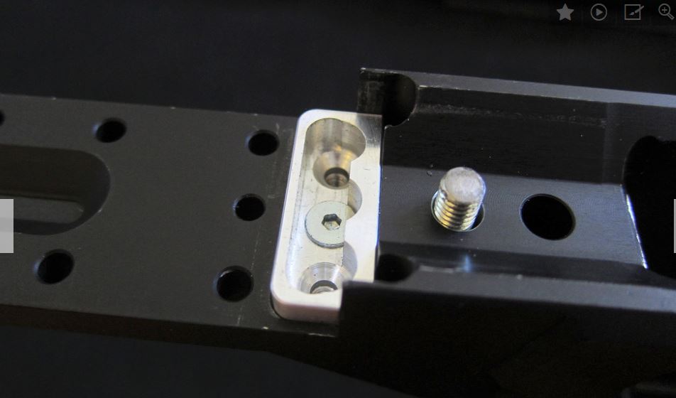

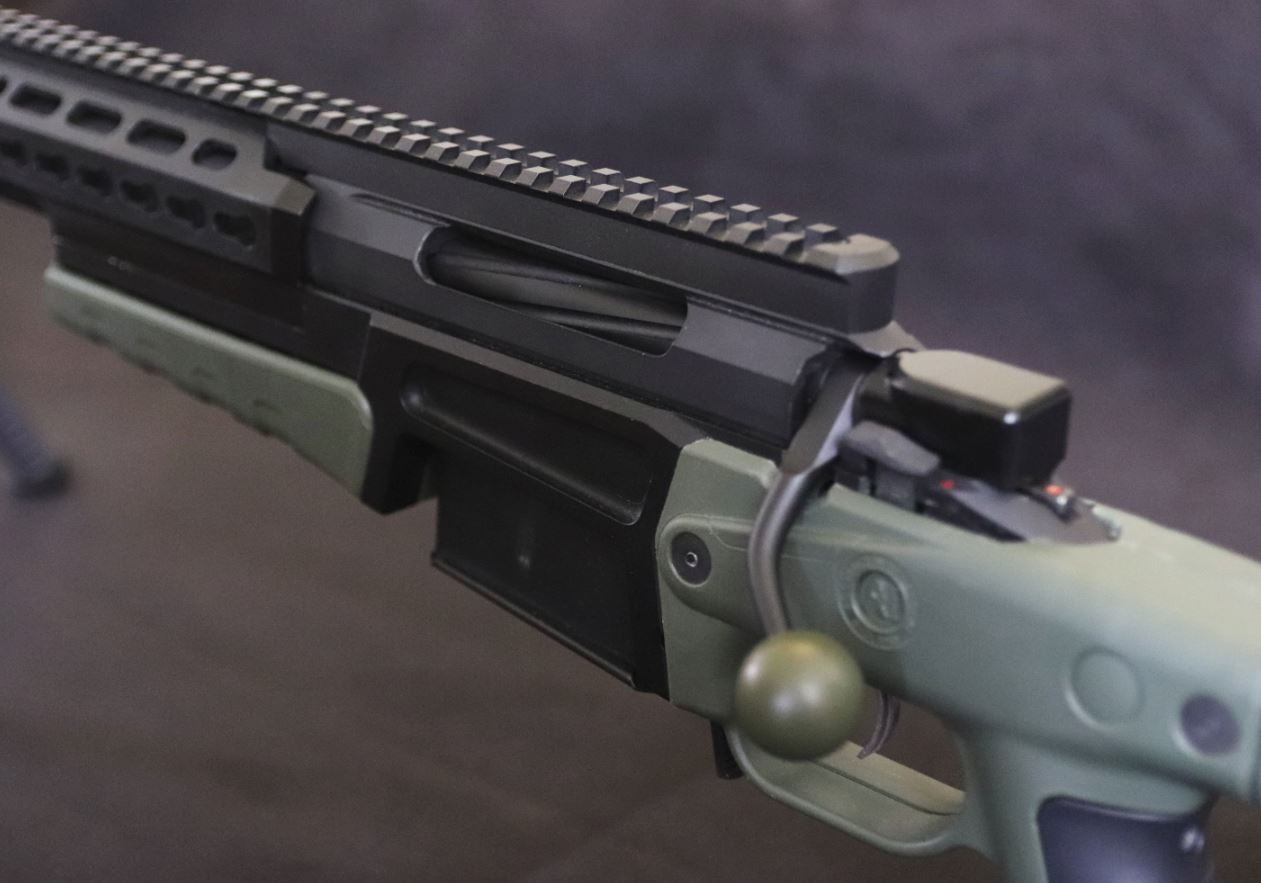

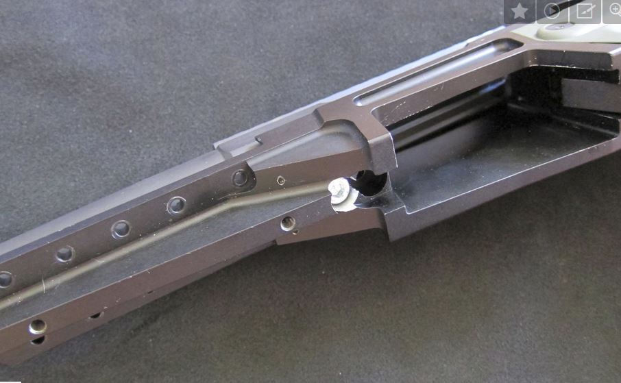

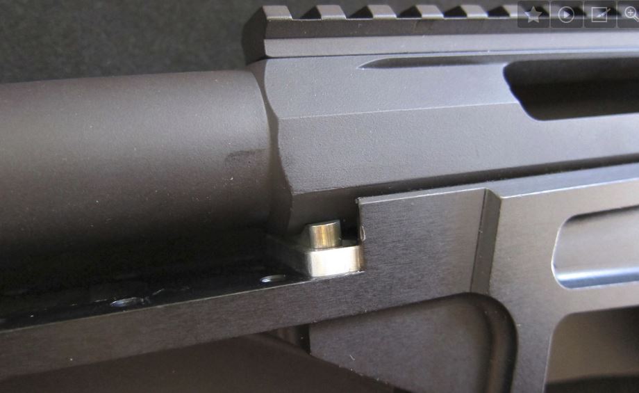

Yes it can be done, and yes that's my rifle.
I wanted a challenge after converting a Sako TRG chassis to suit a Tikka.
The Chassis is an AI AICS AX for REM700 SA. Obviously it's a pre 2014 fixed version.
People have modified the traditional AI AICS to fit Tikka T3's, and they all require the same type of modification.
Use the existing Rear Action screw
Mill front area of trigger cut-out in chassis
Drill new front action screw hole (and counterbore to suit cap screw)
Figure out what you want to do for a recoil lug - I drilled and tapped a 'well' made of 7075 Aluminium into the hollow area for the remington lug.
I then used Titanium Devcon to bed it into place with the 3 screws that hold the 'well' down being covered in epoxy. I then needed to machine the normal Tikka recoil lug to be a bit shorter (used a heat treated surface ground aftermarket lug I made). This was then bedded into the aluminium 'well' and the rear tang was also bedded at the same time.
In my case I wanted to go all out and so I not only got the AI front forend rail, but then machined from a picatinny blank - a matched rail for the top of the Tikka action that even had the correct lug spacing so it blended in seamlessly. I even needed to custom make 4x screws for the rail too, I used some long M3 screws that had some blank shank on them, put them in the lathe and got them to the correct size before running a 6-48 threading die over the shaft and cutting to length.
No i'll never sell it, the chassis are hard to come by in Australia, and expensive. AI is not releasing any chassis for a Tikka anytime soon (they just got a contract to replace rifles in Germany - good on them anyway).
Also the shroud is a 3d printed prototype.
AX mod 1.JPGAX mod 2.JPGAX mod 3.JPGAX mod 4.JPGAX mod 5.JPGAX mod 6.JPGAX mod 7.JPGAX mod 8.JPGAx mod 10.JPG

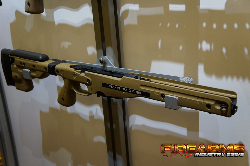

Wasn't AI going to make a chassis for the Tikka a while back I thought I read that somewhere a while back......
AI did have a Tikka AT chassis at SHOT a few years ago. AI had a part number for the Tikka AT chassis out to the vendors not long after that; I put one on backorder as soon as the part number was available to backorder. About 8-9 months later I get an email saying the backorder was cancelled because the item had been discontinued. I wasn't even aware any even made it to market-- I figured they never went into production although a few apparently made it out the door. Ended up using a KRG Whiskey 3 instead, which I really liked, but didn't match my AIAT.
First shown in 2014 and never again.
Accuracy International have enough going on without worrying about an extra chassis inlet. It is a shame because plenty of shooters would be all over it. I think any questions about it at shot show would be quickly deflected. The option left is to modify the rem700 inlet or make a clone or find someone that does make a clone. I have had both the Roedale version and Wombat Ordnance, I preferred the Wombat by a large margin. I no longer own either and am sticking with the AX chassis.
I just watched a video from Shot Show 2022 that AI IS making chassis for Tikka T3x and T1x. I cant find the video now. :(
Yeah but they also had a tikka chassis at the 2014 shot show and hows that one coming along? They're just a bit late to the tikka party.

Can confirm the AICS AT-X chassis will be offered in T3x and T1x inlets, or at least that’s what the guys at the booth said.
Seems the cost of the chassis will be no different from the R700 at $1250 before any other add-ons. Realistically, you’re probably looking at close to $2k all in between NV bridge, weights, folding adapter, etc. Pretty much on par with the rest of the newest chassis offerings anyway.
