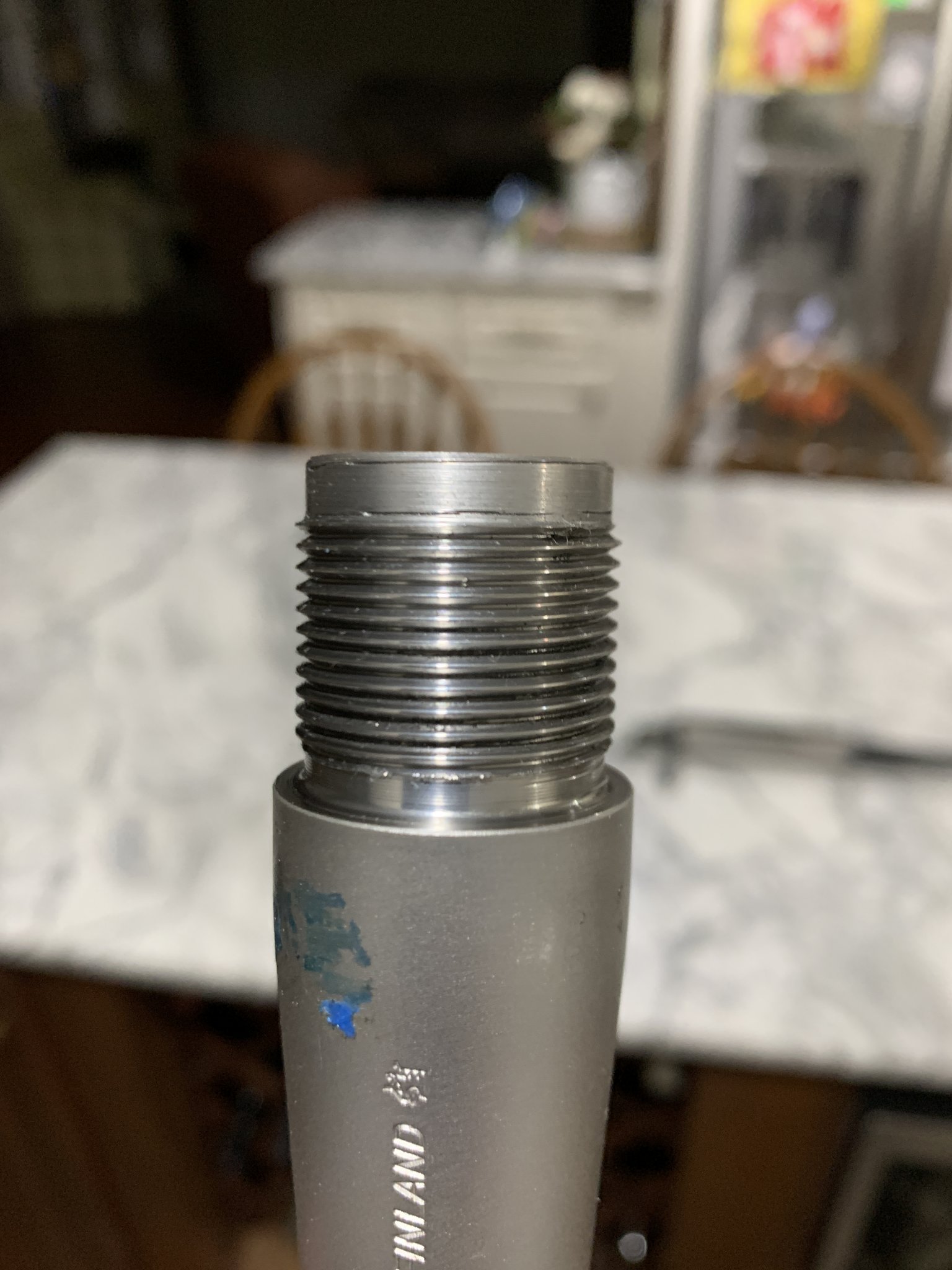

Gunsmithing Tikka barrel removal, what happened here?

I've heard Tikka barrels were tight but wasn't expecting this. After breaking the action free, it took considerable effort to unscrew all the way off. Anybody ever seen anything like this with Tikka? Im leaning towards something going wrong during assembly at the factory and they just muscled it on thinking it would never be taken off.

This was a exterior wrench, not clamped real tight. We even moved it around thinking it may be pinching on the threads.
The attached picture is how we got the barrels back on. The last 3 threads were so bad they wouldn't clean up. Almost lost an action.

Ive pulled the barrel on three Tikkas and one Sako TRG. I clamp the barrel right in front of the shoulder and use an outside action wrench and grab the action as close to the union as well. The Tikkas take a whack with the palm of my hand to break free while the Sako TRG took a couple moderate whacks with a rubber mallet. They all broke very easily. In my small sample, only the very last thread near the shoulder of the barrel was slightly rough. Just smoothed out with a small file. Wouldn’t need to do that but did for insurance.
@wareagle700 did you possibly overtorque the action wrench when clamping your action. I snug the bolts by hand andvery lightly bump the clamping bolts with a wrench. The flats keep the action from spinning. All you do with the bolts on the action wrench is take out the slack. Anymore than that will put unnecessary and damaging pressure on the threads of the action and barrel and could cause galling like you experienced.
Are your action threads damaged? I can’t tell by the photos using my phone?
EDIT: i missed your post just above mine. You answered my questions there.
Reactions: Northfl
The tikka barrel I sent you was by far the hardest one I’ve ever pulled. Most of them are like wade said. One good whack and it’s free. That bad boy was tight but completely free one it broke loose. I’m like you, I think it was tight when it went together and tight fits with SS really tend to gall if no lube is used. I always use lots of grease fitting SS actions onto SS barrels.
