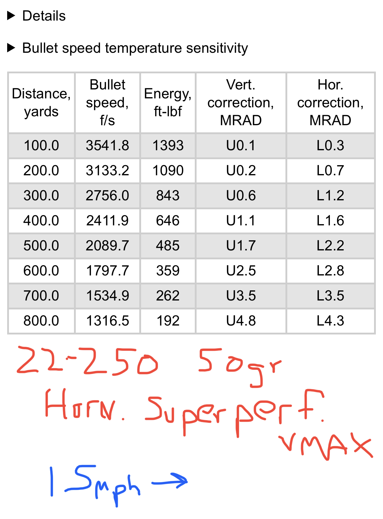

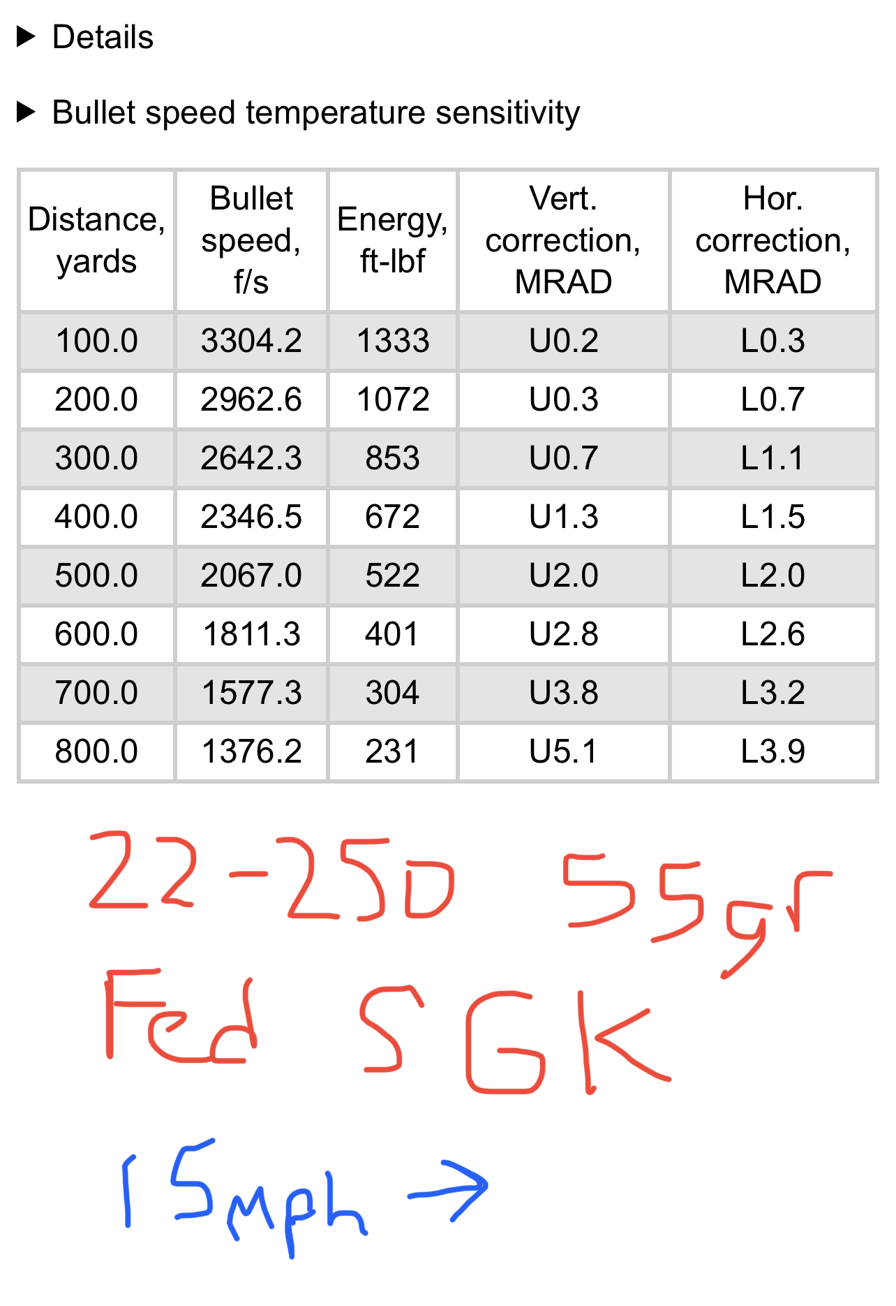

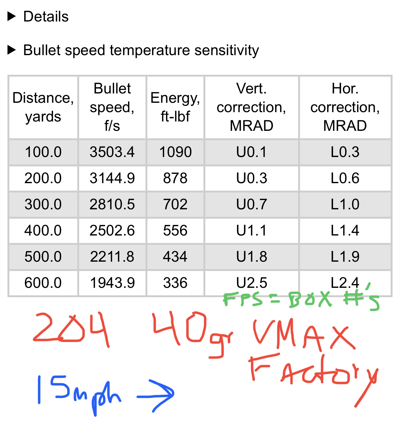

As far as perfect pdog calibers, I’m in the 204 camp. Way better barrel life, equivalent ballistic/wind performance. Energy on target is down a tad, but I get plenty of backflips and explosions. Less recoil so I can better see the show in the scope.
I know you said you don’t give a crap about barrel life, but (mentioning this for others; I’m sure you know) some folks burn out a 22-250 barrel in one overzealous day in the towns.
Factory box speeds on the 22-250’s:
The downside I’m finding out is the ES/SD Hornady 204 ammo is…less than great. Maybe it’s the batch I have. That might be the same problem with factory 22-250 too.
Also you can’t usually buy a Tikka factory 204 barrel as they discontinued making them years ago.
