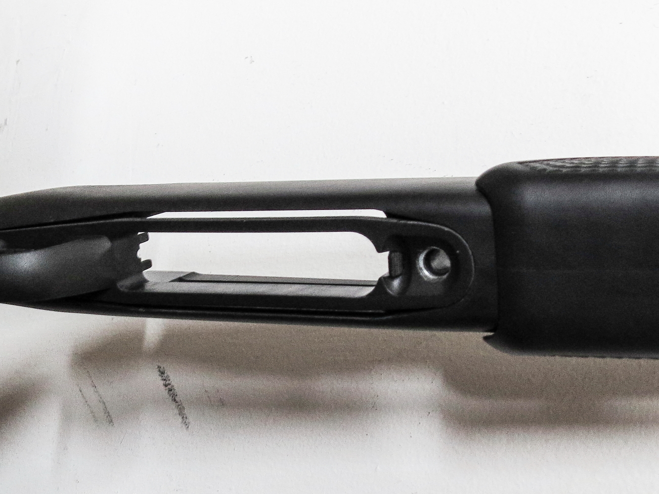

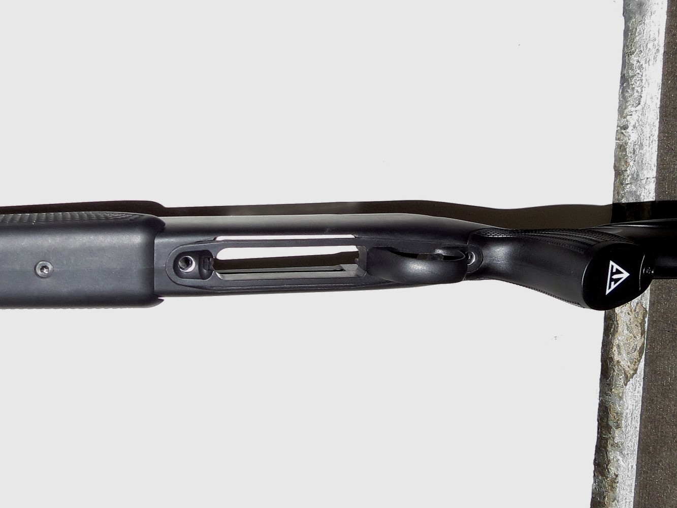

How big is the gap between the CTR stock and the T3x bottom plastic?
Standard T3 sitting in a CTR....
