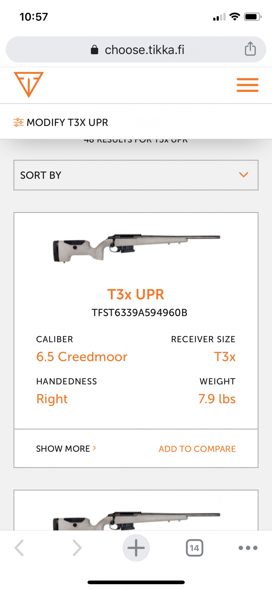

I would wait a few months and see if Tikka adds some new calibers. Rumors of a 6.5 PRC would be good if true. They also have a new model in a stock that looks like a Bravo. The UPR.
