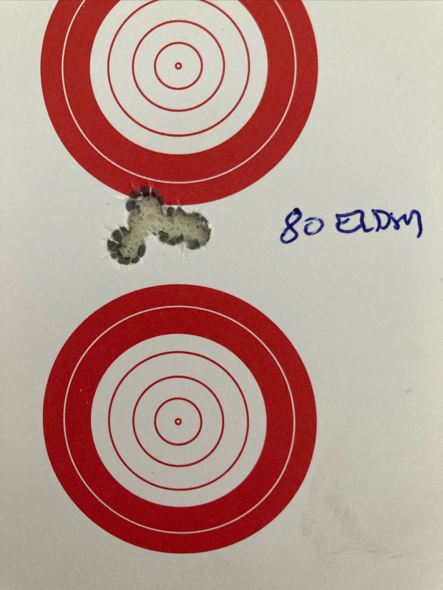

I asked a similar question a while back in another thread, Tikka Varmint 8 twist. I had pretty good results with 77gr Nosler CCs but 75 and 80gr ELDMs were very dissapointing. Lots of folks have reported very good results with them though.
75s and 80s have been great for me. Shooting 75s out of a 20.5" at 2805fps and 80s at 2704fps. 80s are actually more accurate for me. Could probably get more from the 75s but once I get to around .5moa I don't bother chasing tenths.

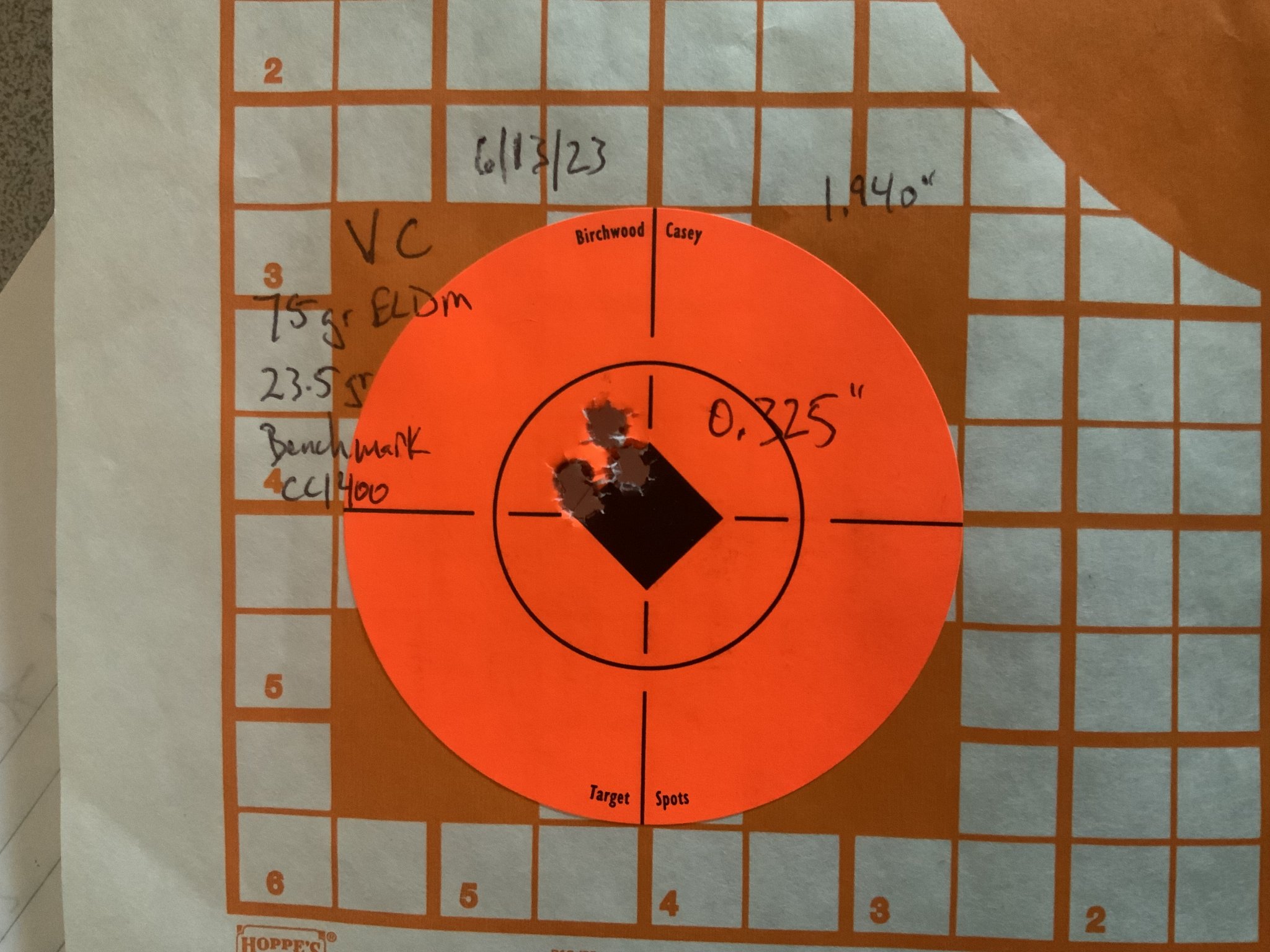

I’m having great success with a stainless T3 Varmint with Benchmark and 75 gr ELDM. 2935 fps and .6 or so MOA.

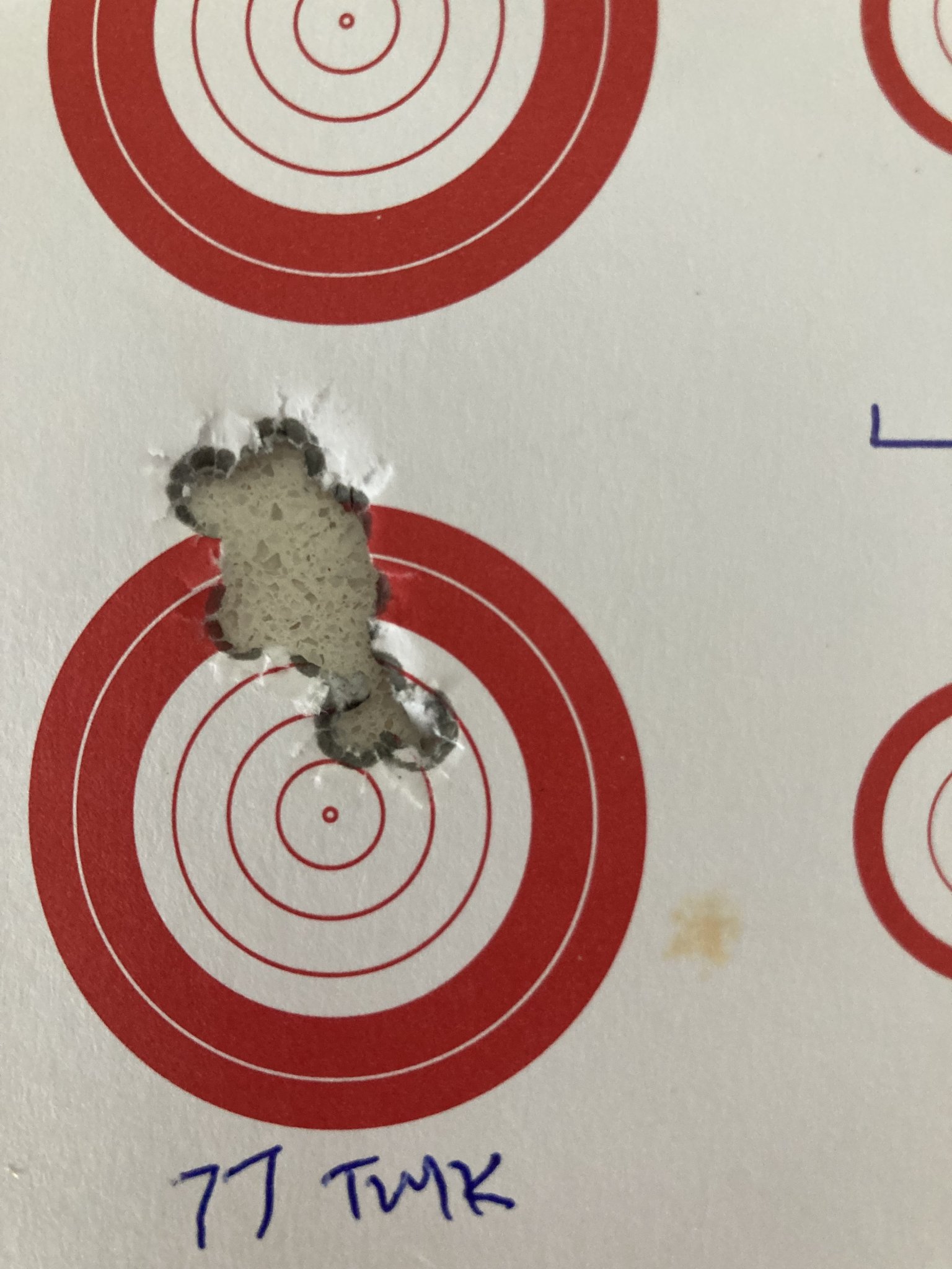

I’m a huge fan of my Tikka CTR 223 but the short throat makes it difficult to load anything heavier than the 69 SMK without impeding on case capacity.
Entertaining the idea of having the throat extended a bit since I have a pile of 77 TMKs I’d like to use up.
