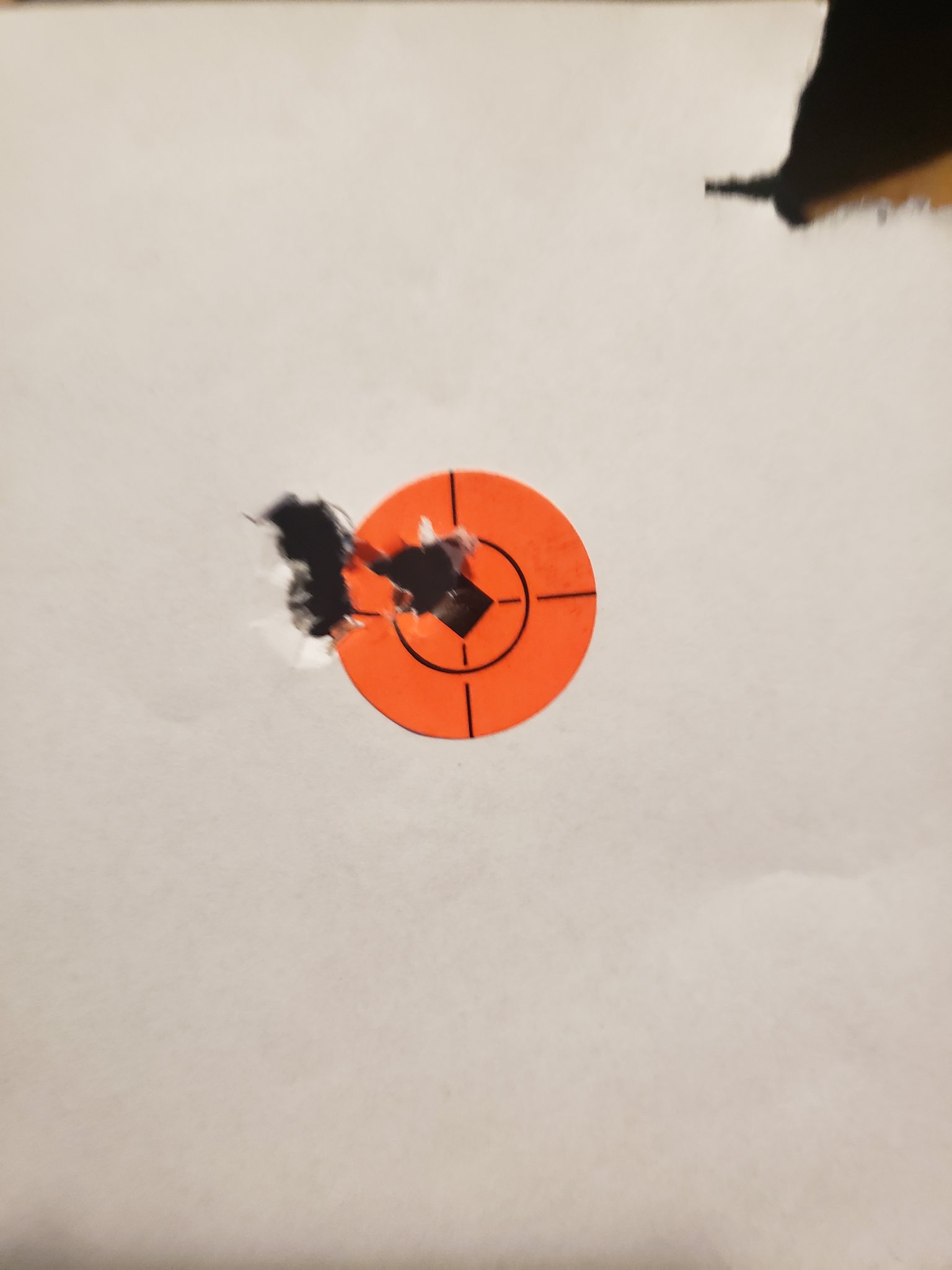

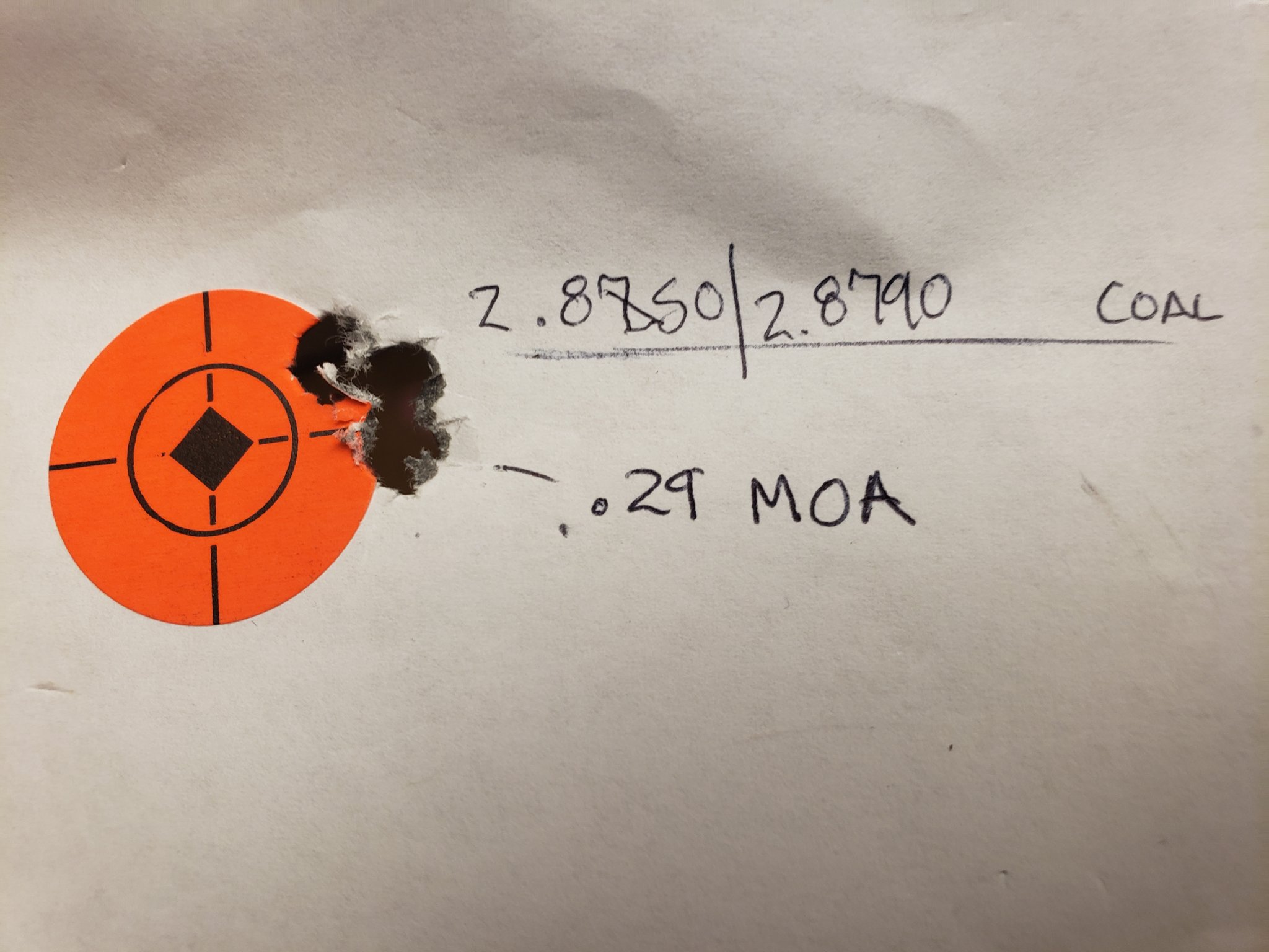

I have. I'm just over a 100 rounds deep. I broke it in with federal premium Berger hybrid 140 grain and ended up grouping around .45 moa (first picture.)
I then ran an OCW test with alpha brass, H4350, and Berger 140 elite hunters .020 off the lands. located a good spot around 40.4 grains at 2620 fps, all my groups shot under .75 moa, and my load with charges of 40.1, 40.4, and 40.7 all shot under 0.5 moa at close to the same velocity and vicinity on paper. I just adjusted my seating depth and found a nice spot about .060 off the lands that landed me at .29 moa (Pic 2). I'm going to do another load development with the 143 eld-x soon, and will also play around with my brass since I can't seem to get very high velocities in the alpha brass without showing some pressure signs early.
In short, I'm loving this setup.
