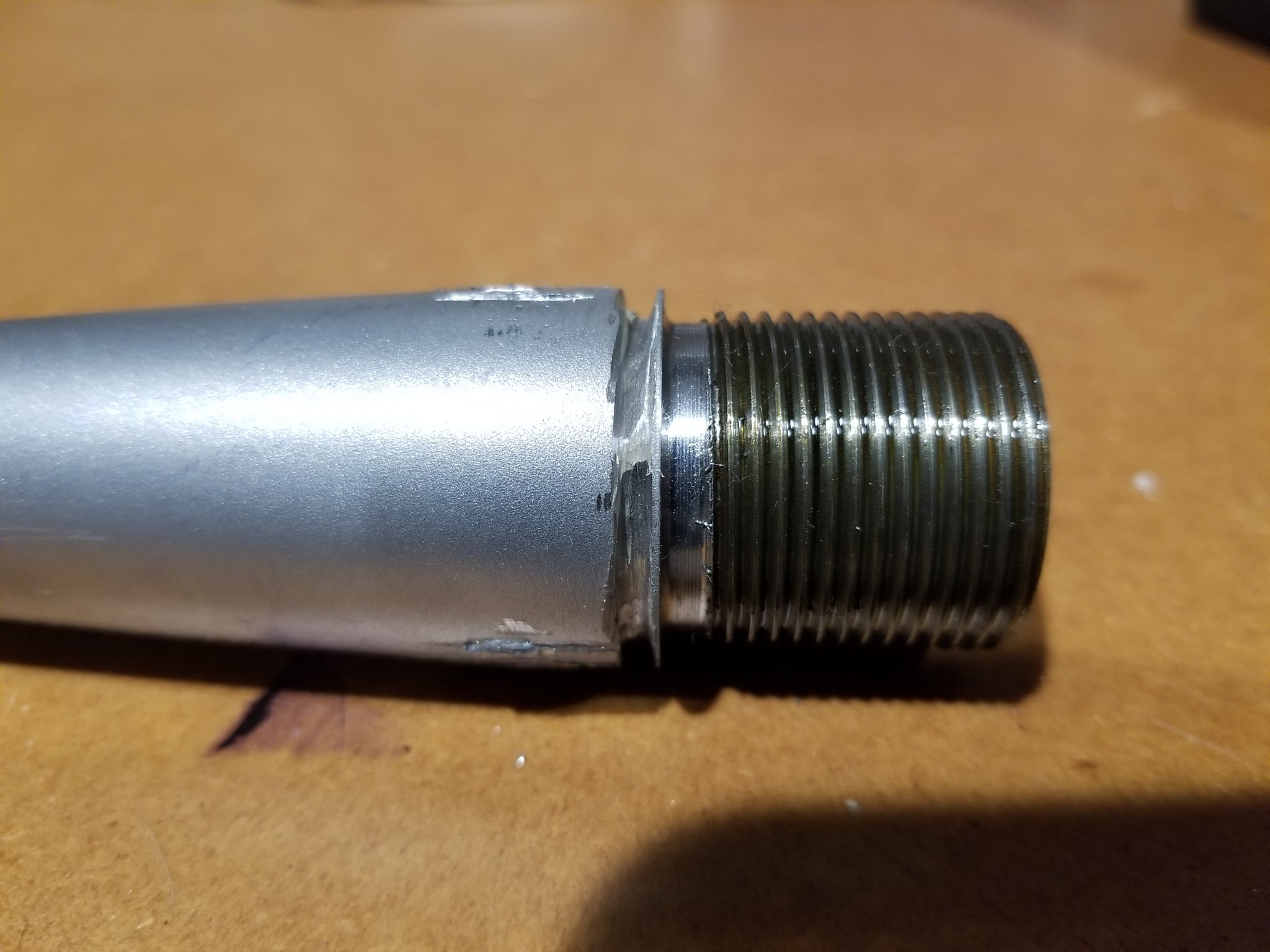

Tried again tonight and thought for sure stuff was gonna break before it came loose. I cut close to the action with a hacksaw and then opened it up and cut to depth with a dremel. Took me maybe 25 minutes. Put the wrench on it and the just the weight of the wrench spun it. Penetrating oil was all the way down the threads.

That works
