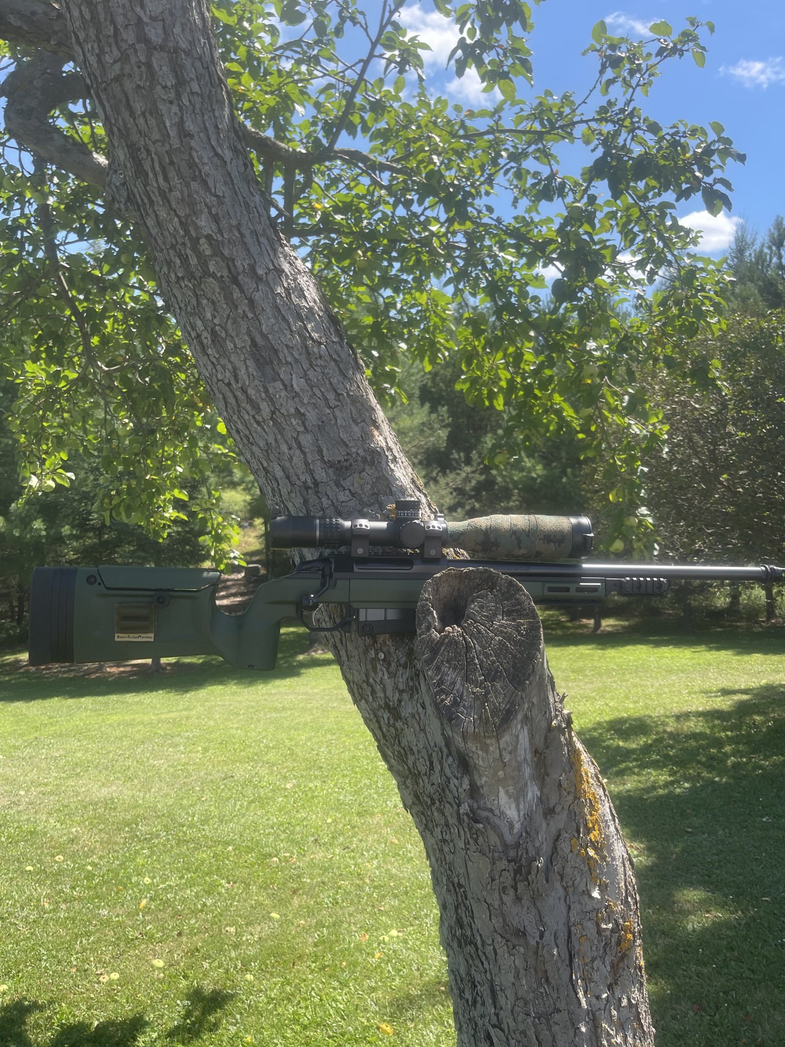

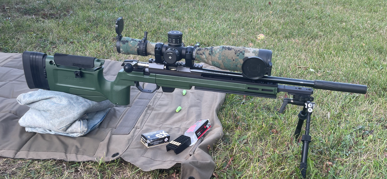

    Having owned several tikka and a B14R I say go the Tikka route. However mines the CTR. So it uses the 10 round double stack mags. My other which is a T3X Alpine Veil uses the plastic tikka mags. I’ve never used one with an AICS setup
    The CTR in my book is as close as you can get to stepping up to Sako or AI rifles in factory form.
    I haven’t used the exact models you listed though so take my opinion for what’s it’s worth overall
    I like short bolt throws like the tikka or AI over a R700
    The trigger in my tikka is awesome. Even better if you swap the springs but I’m at 1 lbs and have no need to. I put a trigger tech in my Bergara cause the trigger even adjusted had creep and wasn’t very good. So factor that into there
    I have my CTR in a bravo. I also have his little brother the T1X as well

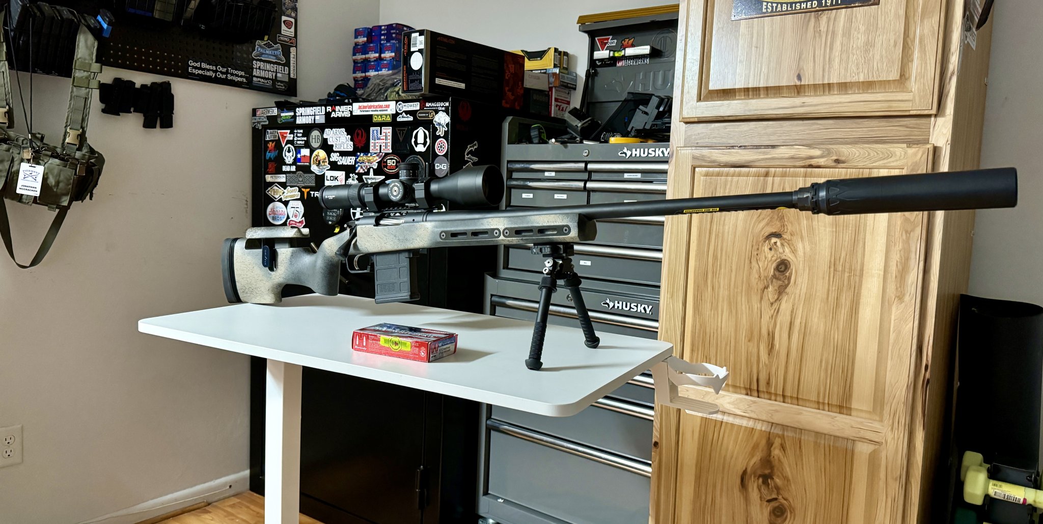

    Went to a local store on lunch and came out $3500 lighter. they had a bergara premier ridgeback in 6.5 and some NF glass but ended up with a athlon Cronus btr they had. Never had athlon but this looked very clear.
    Hoping to drop a few dear with this and my S&W 6arc this year.
    Hope I don’t regret it.
    The premier series is a nicer action, your chances of a perfectly fine rifle are higher than the normal B14. Just do the usual - if you haven't already, pull the action and scope mount screws, degrease everything, clean up any overspray paint, torque back to spec, and you should be fine.
    I put on a scope base and scope last night & cleaned the barrel. Took it out this morning and it would throw a random flyer with 2 different types of ammo. Like 4” to the right, but the next 4 rounds would be where I was aiming and in .5” or less groups. Besides those random ones, the rest of the rounds shot very tight groups.
    I’ll check action/stoxk
    Try without the can
    Try without the can
    Ill do that as well.
    I took the action out of the stock and the front action screw was all but finger tight. The back action screw was pretty snug.
    That may be the issue there. I did sand down the pillars to get the paint off and make a smoother mating surface. Ill probably end up bedding this stock at some point anyways.
    Very good point about the suppressor, I personally wouldn't remove it so much as I would make sure it was completely tight, but yes I've seen a loose can throw rounds.
    The loose front action screw will 100% cause the issue, as well. Glad you got that identified and corrected. I half suspect the reason why removing the paint seems to help so many folks is because it forces a re-torque on the action screws... but don't mess with success, I guess.
    I have a different Grayboe stock than the one that came with your rifle, but yes, I would recommend it be bedded eventually as well.
