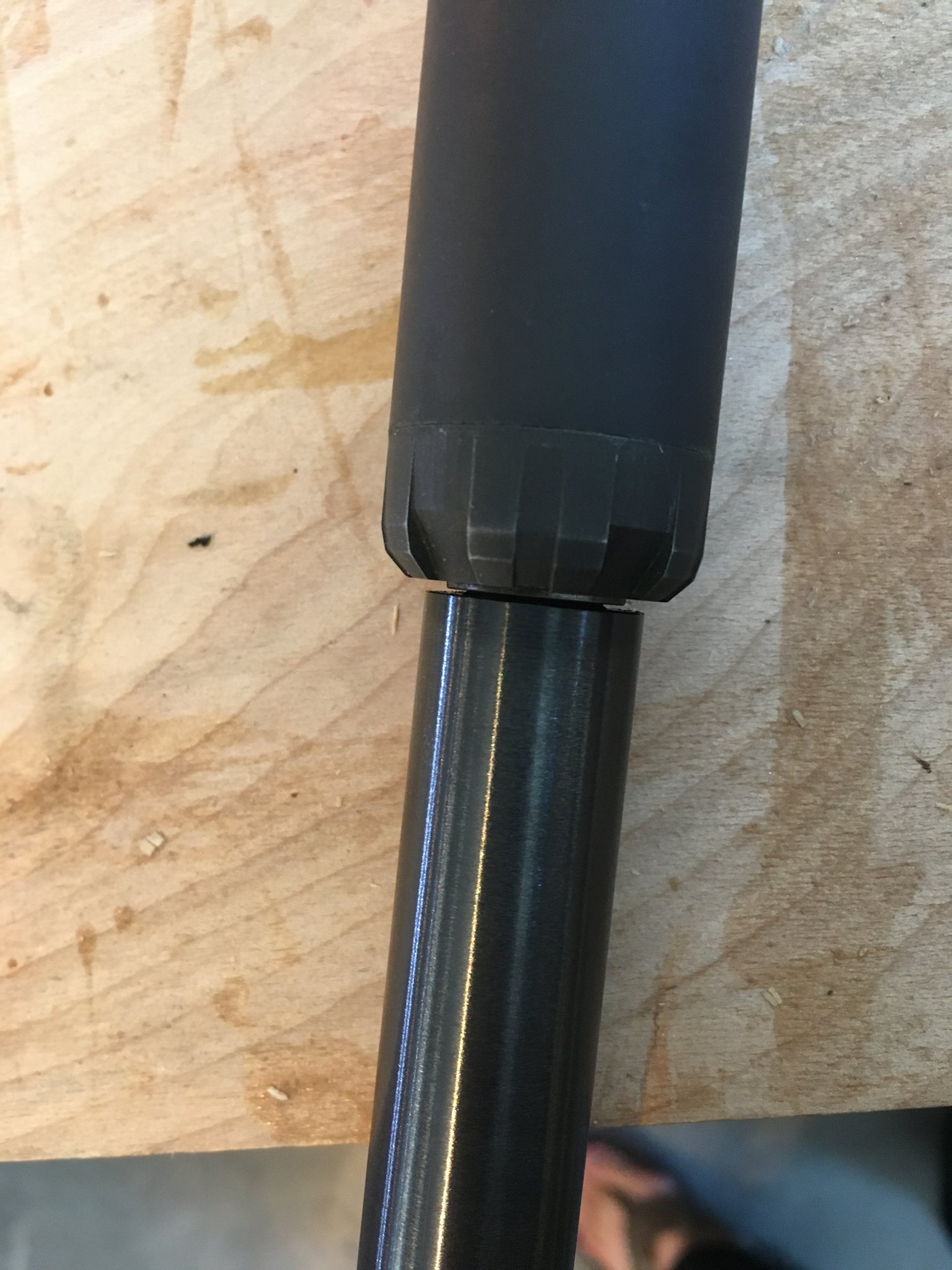

    Does Anyone running a SS sparrow suppressor on a t1x notice the back of the can doesn’t meet the shoulder or the barrel??? Anyone have repeatability/accuracy issues at all?
    This is what I’m seeing... it shoots well but I haven’t taken it off and back on to see repeatability yet..

    I run one, and haven't had that issue. If you've used the can much at all prior to install, there may be some carbon or lead in the internal can threads that are preventing it from seating all the way. you shouldn't need a spacer. Actually, if you use the spacer that's hiding in the Sparrow box, you'll end up with very few threads engaging the can. I had a similar issue with a CF can, and that's what it was, some crud int he threads. A good cleaning and chasing the threads inside the can fixed it.

    What he said about built up carbon and crud, happened when I tried installing my Spectre can to the T1x. I have taps and dies for all my popular muzzle threads just in case but solved it with CLP and installing/removing it multiple times and wiping off the crud. Now the can shoulders as easy as it should and comes off without any hassle.
    Update: it’s actually the oring... when I cleaned it all out the threads are chewing into the o ring which is preventing it from shouldering up to the barrel.

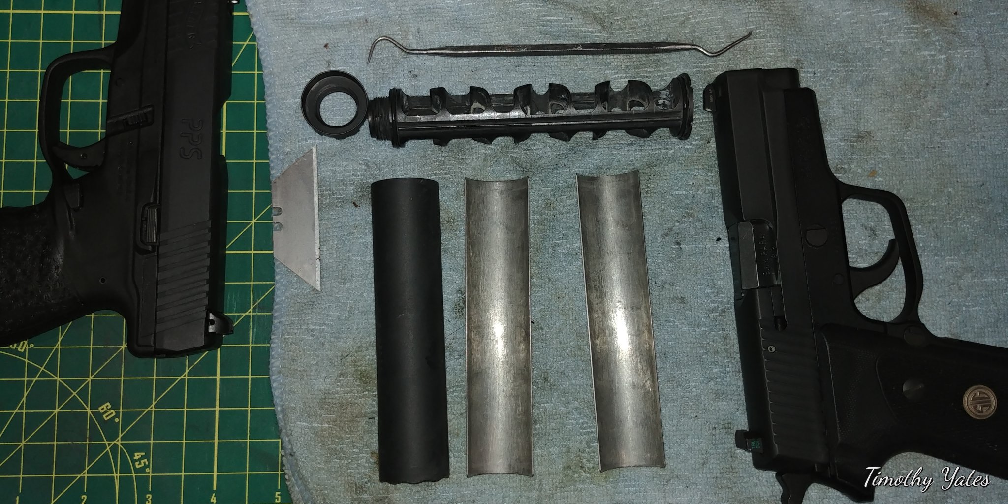

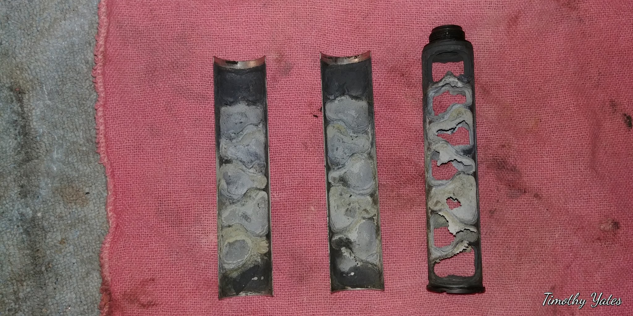

    This is how my Sparrow usually looks before cleaning it. Round count, at least 2,000.
    After cleaning.

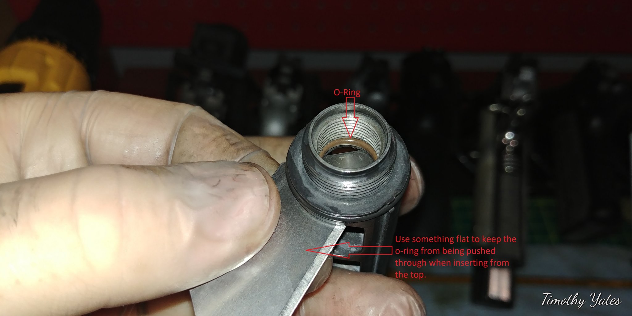

    O-Ring locations and who my o-rings are from. BTW, my hands look freaky because I have latex gloves on.

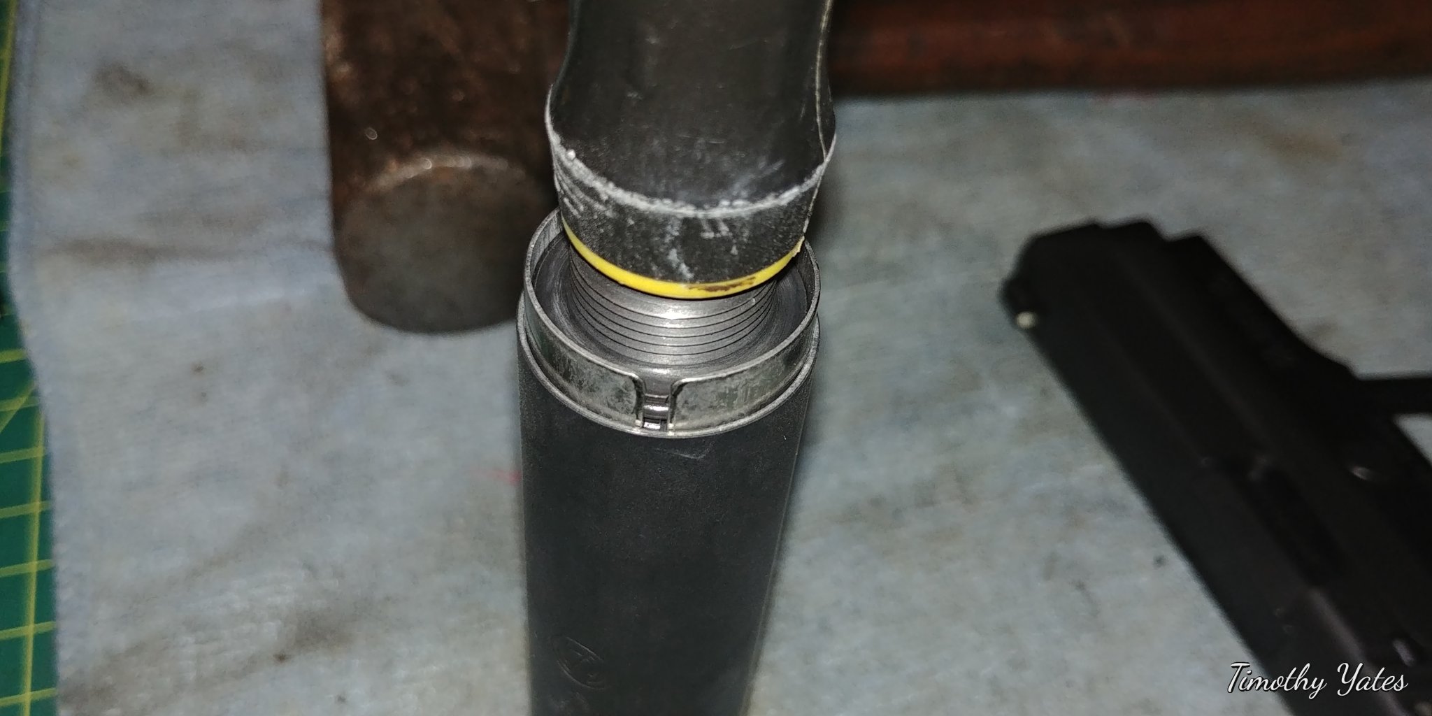

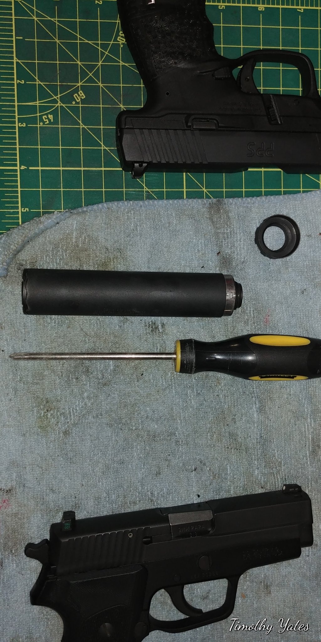

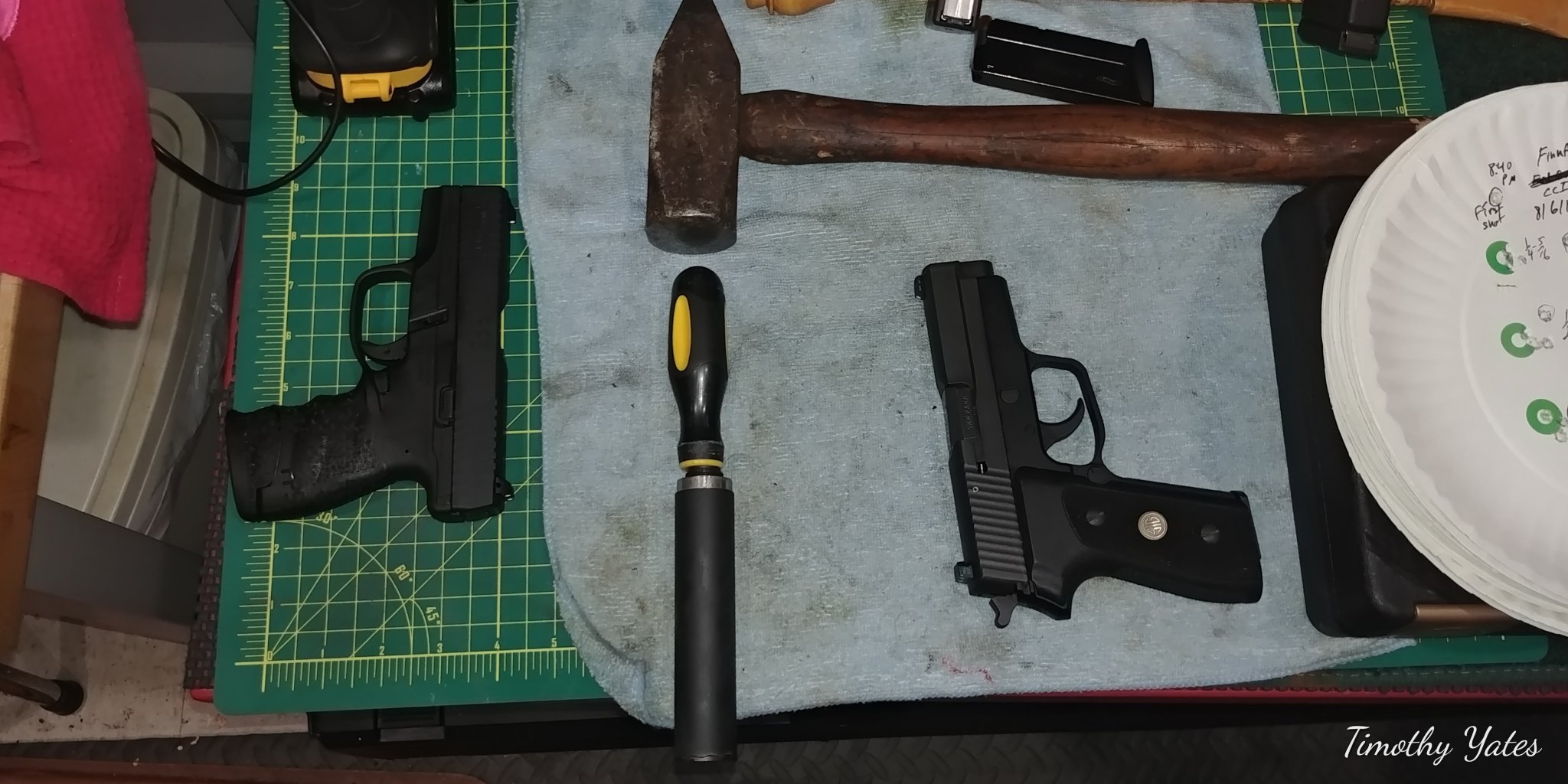

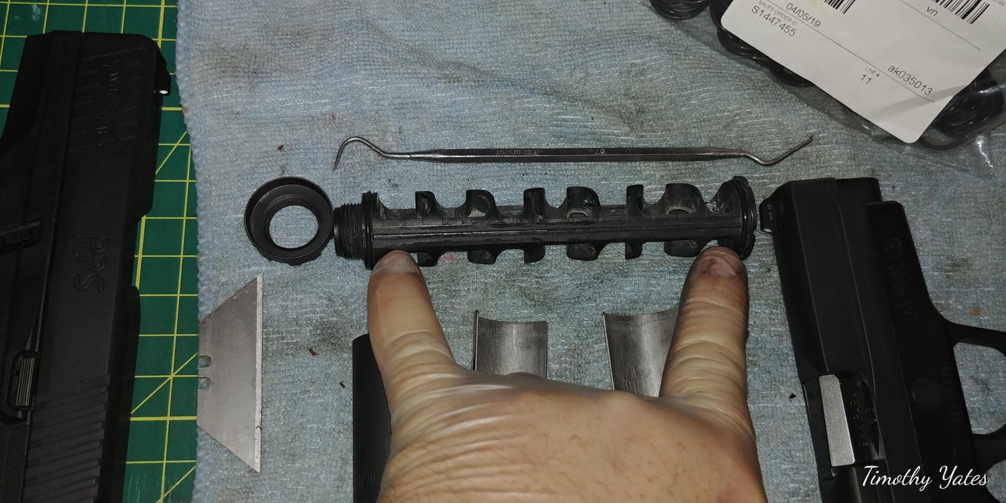

    Disassembly method.
    KOD, buy some of the Dielectric grease discussed in the other thread and you won't need a hammer or screwdriver anymore to disassemble. Coat everything inside and out with it (except the outside of the outer tube, of course).
