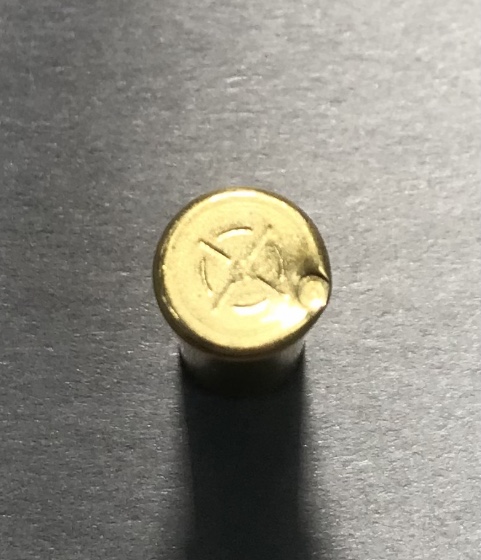

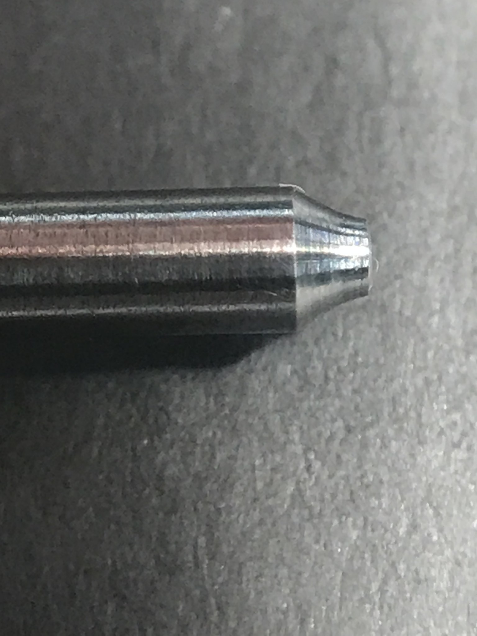

Hi Chris,
I would just like to know how to get one of your firing pins. My firing pin broke before I even got a chance to shoot it. I was dry firing it to smooth out the action and noticed the breech face was impacted by the firing pin. When I took the action out to adjust the trigger, I noticed a cam pin dropping out of the action. I was trying to find the place where the cam pin went when I realized it was the tip of my firing pin. What a shit design. To not be able to dry fire any rifle made during the last 50 years is just nuts and huge design flaw!!! There is no reason a firing pin would ever need to travel far enough to impact the breech face under any circumstance. Had I known this, I would have never purchased the Tikka and would have gone with CZ instead.
Thanks,
Graham
Hi Chris,

This is not typical, contact Tikka and report it.

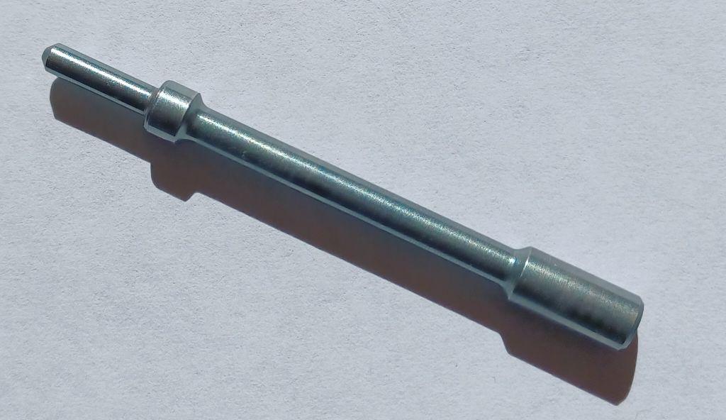

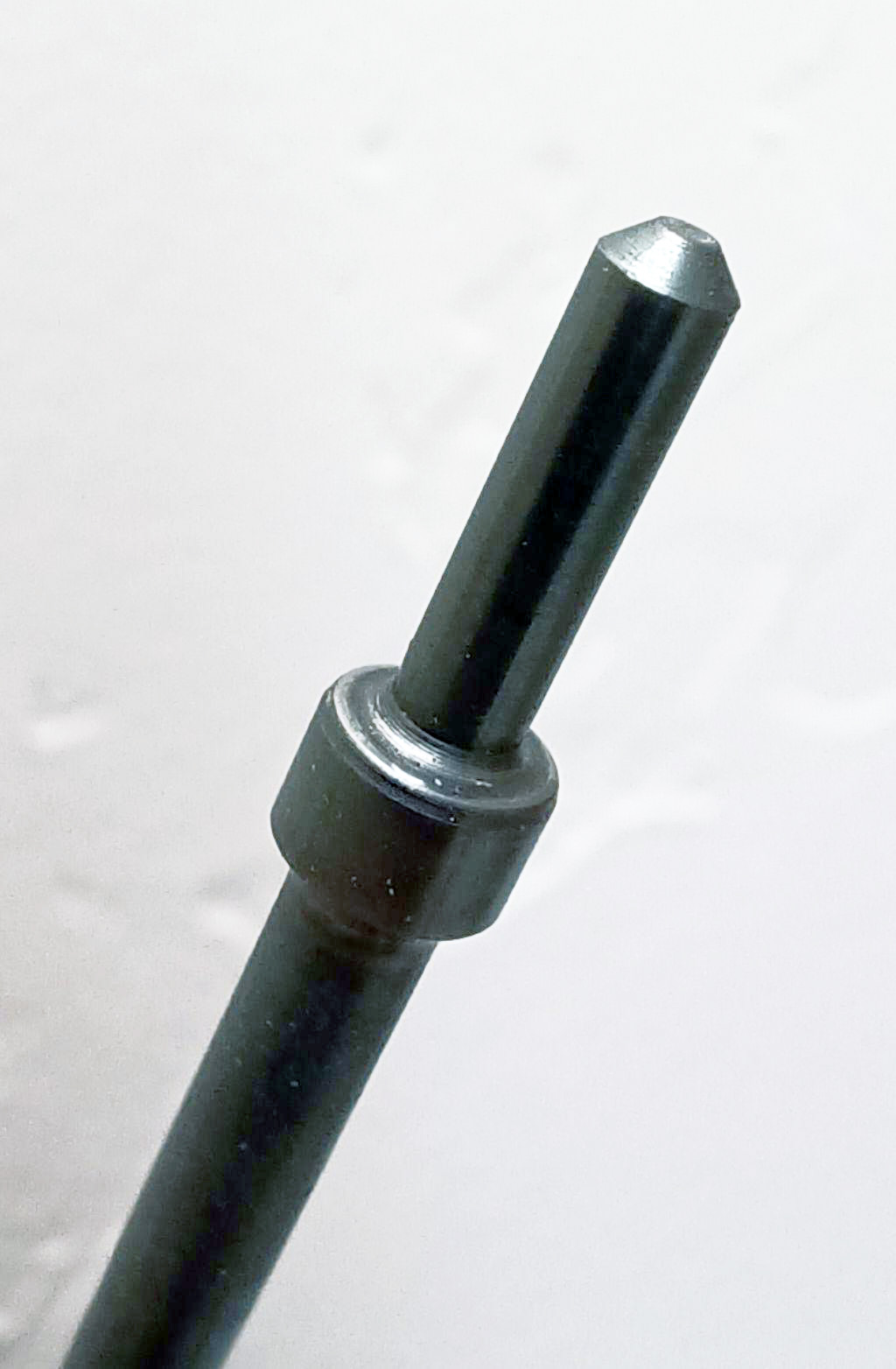

Can anyone point to an example of a two piece press-fit firing pin that has a history of reliability? I think inconsistent surface finish and/or improper heat treat is the main issue with the stock pin. The factory pins are heat treated in the blue brittleness zone (marked by a blue oxide layer from the temper). I do not know what grade of steel the factory pin is made of, but blue parts after HT intended for impact use is usually a bad sign...
I believe Jerry Stiller presses the tips into his 2500X actions, probably one of the most accurate rimfire actions ever made. I'm sure the factory pins are made from 4140 or something similar but I am unsure of their exact heat-treating process but it's very likely the temper is more than that (Straw yellow 430 Deg. F) and then black oxide coated (blued)
The only way to improve the stressed area of the one-piece firing pin is to increase the radius between the tip and the firing pin body but if you go to much that is where the direct impact will be when it strikes within the bolt.

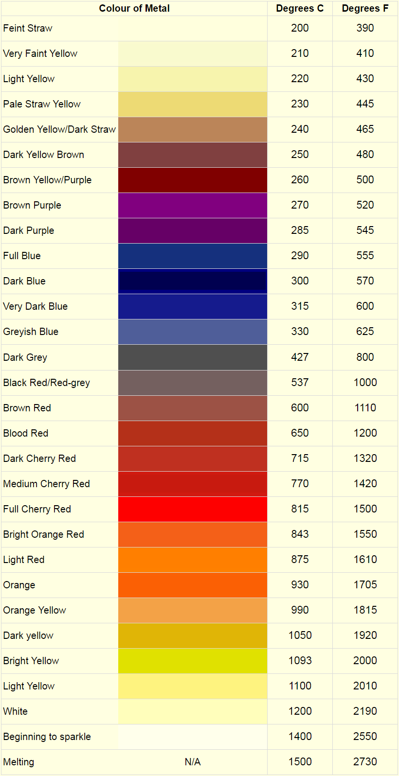

Here's the oxide layer color chart and corresponding temperatures:
The stock pin has a generous radius, but a poor surface finish. This plus the blue oxide layer means it's embrittled and thus compromised and I'd expect it to break prematurely. Hopefully Tikka can get those two issues resolved and then I'd expect stock pin breakage will become a problem of only very heavily used rifles with high round counts.
My opinion, YMMV, etc.
