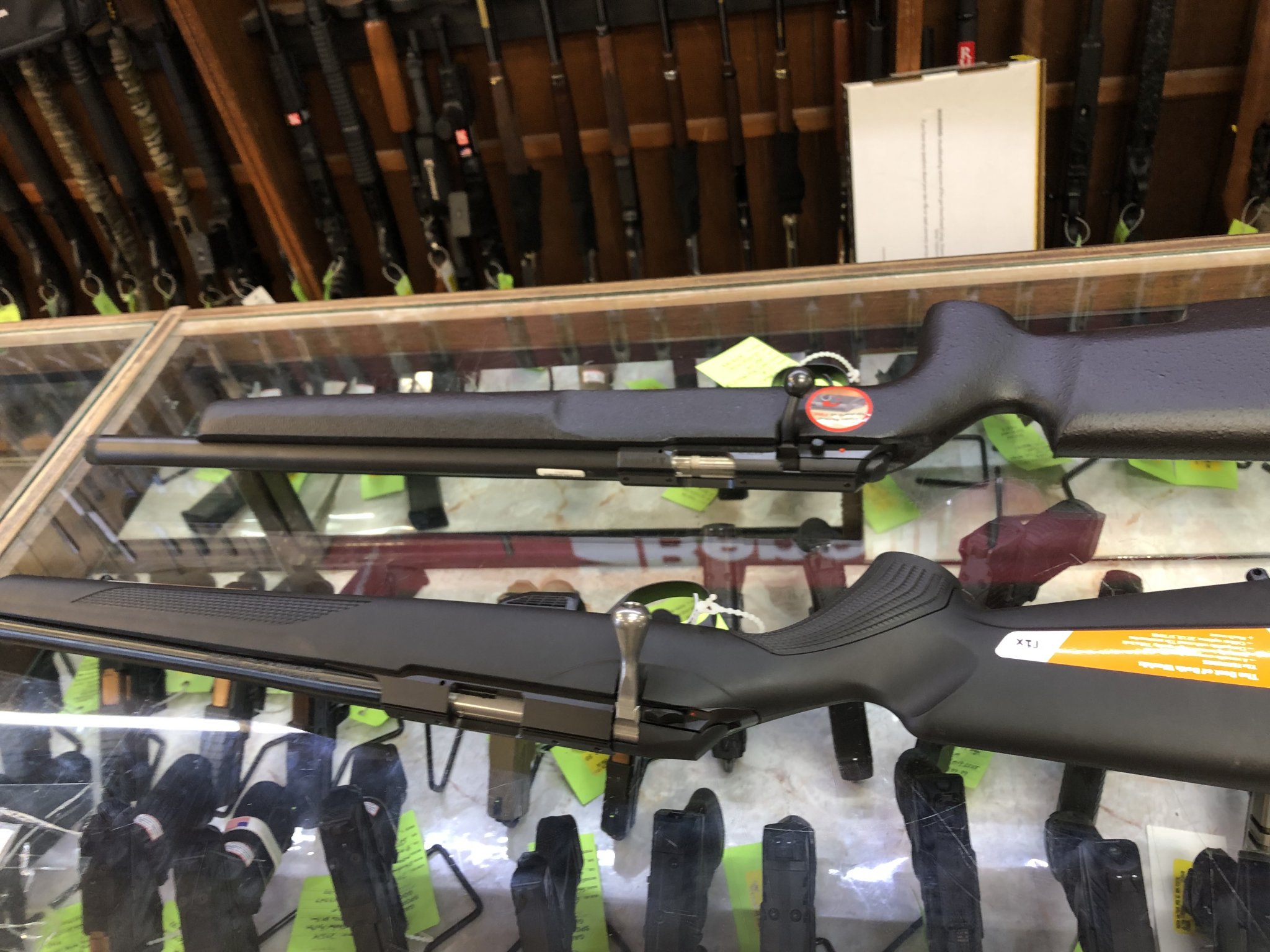

I did see a T1X 16” at a local gun store here in GA for $579 and the CZ457 $679
