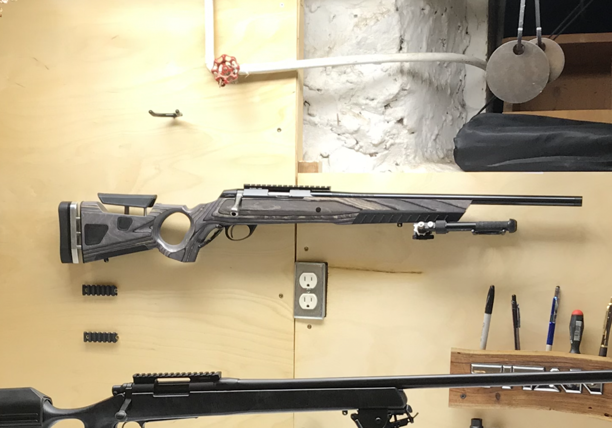

I have a couple thousand rounds threw my Tikka, first thing I did was dump the stock and put it in a Boyd then glass bedded it and reworked the trigger. With pretty much and Lapua ammo it’s sub minute groups at 100 yards and 200 yards. I shot a 8” steel gong at 300 yards and in the near future going for 500

Before you go threw all that check out Boyd stocks $200, I bought one and love it but I bedded and pillared it as well. Somewhere in one of these forums a guy posted a ejector spring modification i adjusted my spring and the chambering of the round is perfect every time because that ejector spring acts a bit like a guide as well

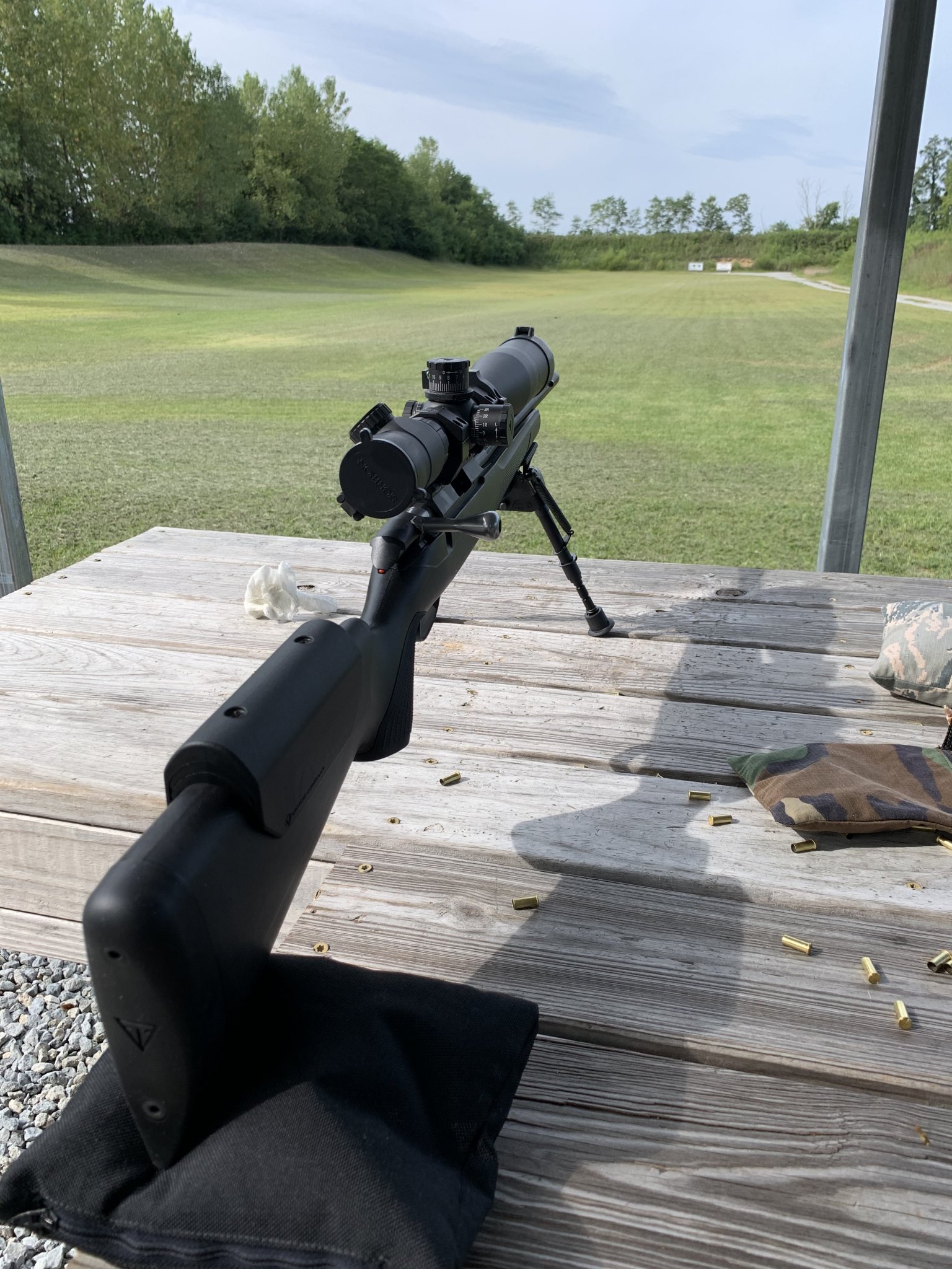

The LOP and comb height were too short for me as well. I did the T3 recoil pad, and it adds about 3/4”. I would prefer it to be longer still. I added Titan universal cheek rest to the comb, and it is good with the standard three spacers. I also added about a pound of lead to the stock, which I really like. The vertical pistol grip is okay at $20, but nothing special. The Boyd’s AT-ONE stock for $200 is tempting.
