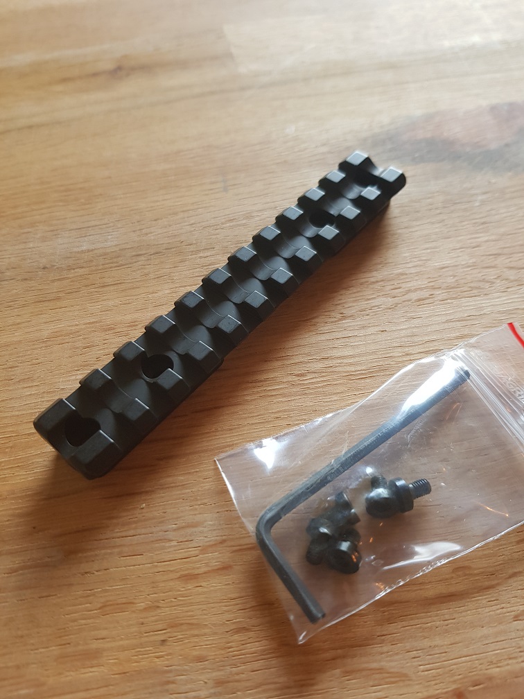

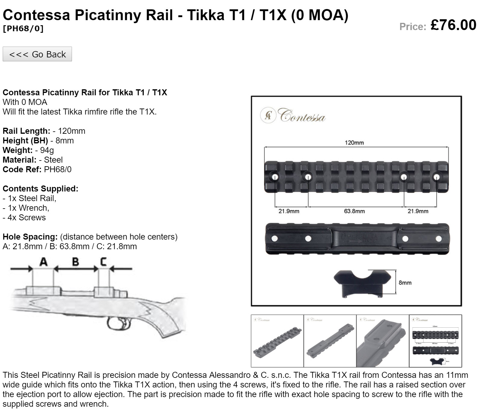

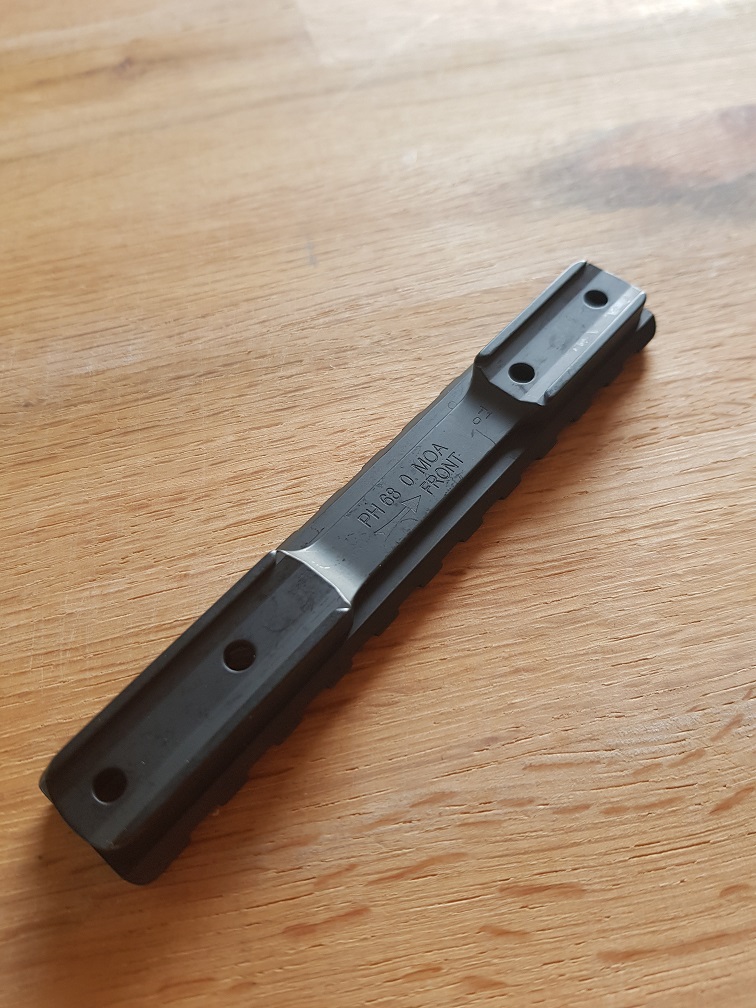

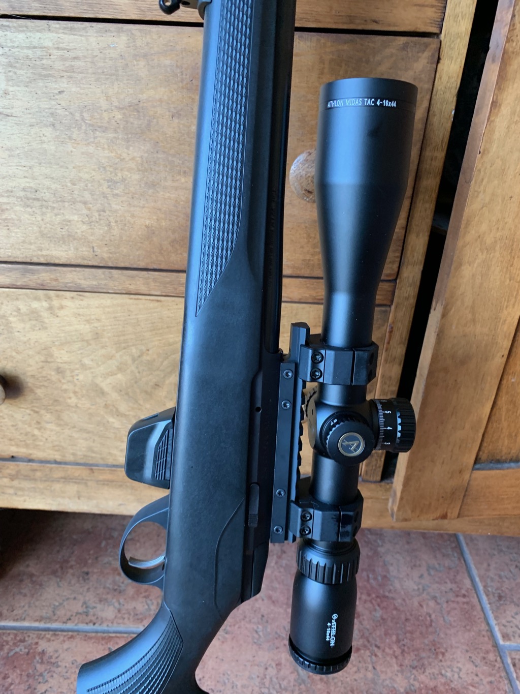

A Contessa pic rail was in the mail today.

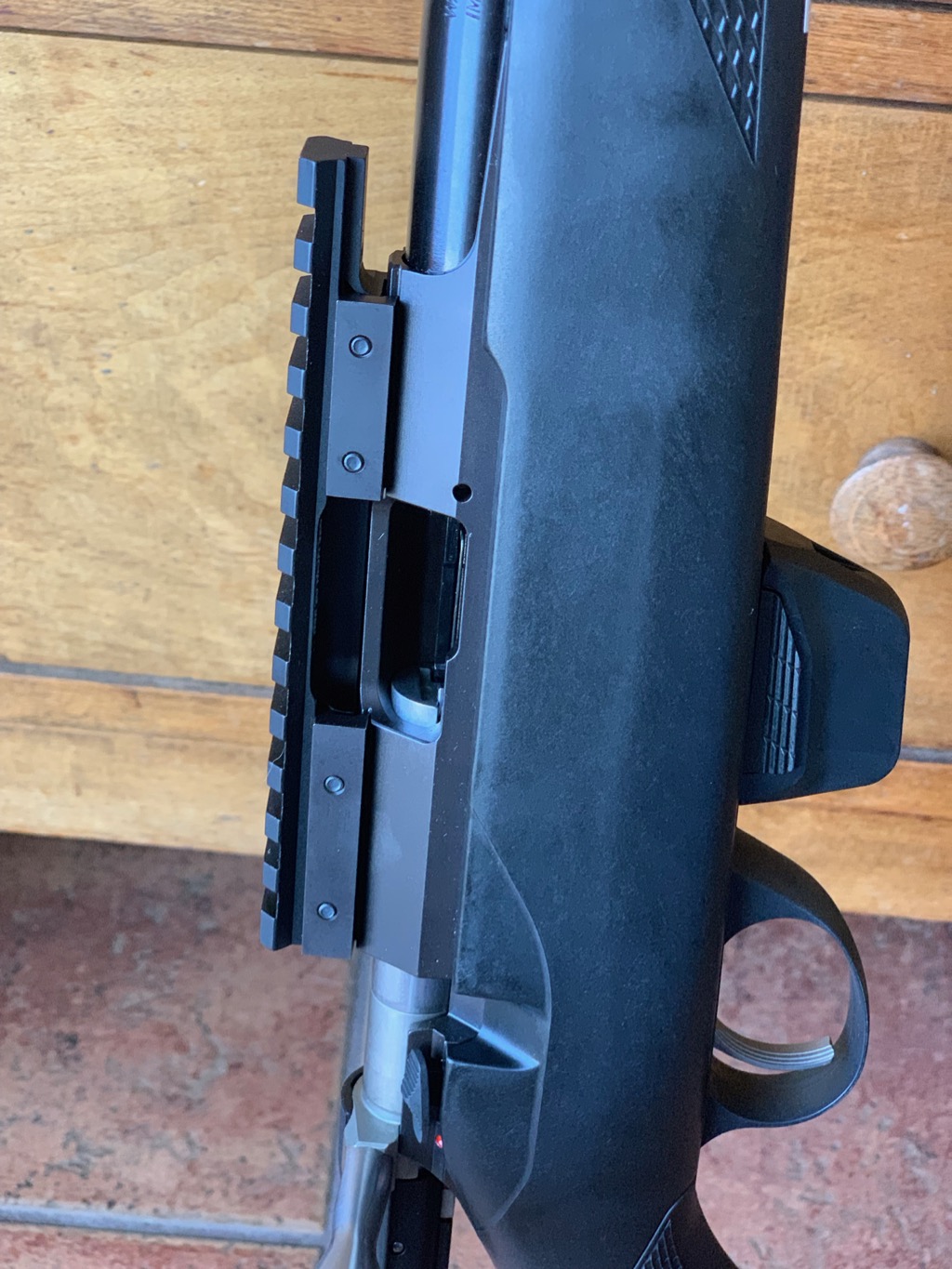

There are a few Australian companies making rails for the T1x, but they don't appear to have any canted ones yet.
Failing all that there qre plenty of 11mm rings available like Warne 22/7.3s that work on the T1x, and Talley lightweight T3 rings work also.
Finally, if you wanted you could just buy a T3 rail and drill and tap some new holes for the forward moubting point.

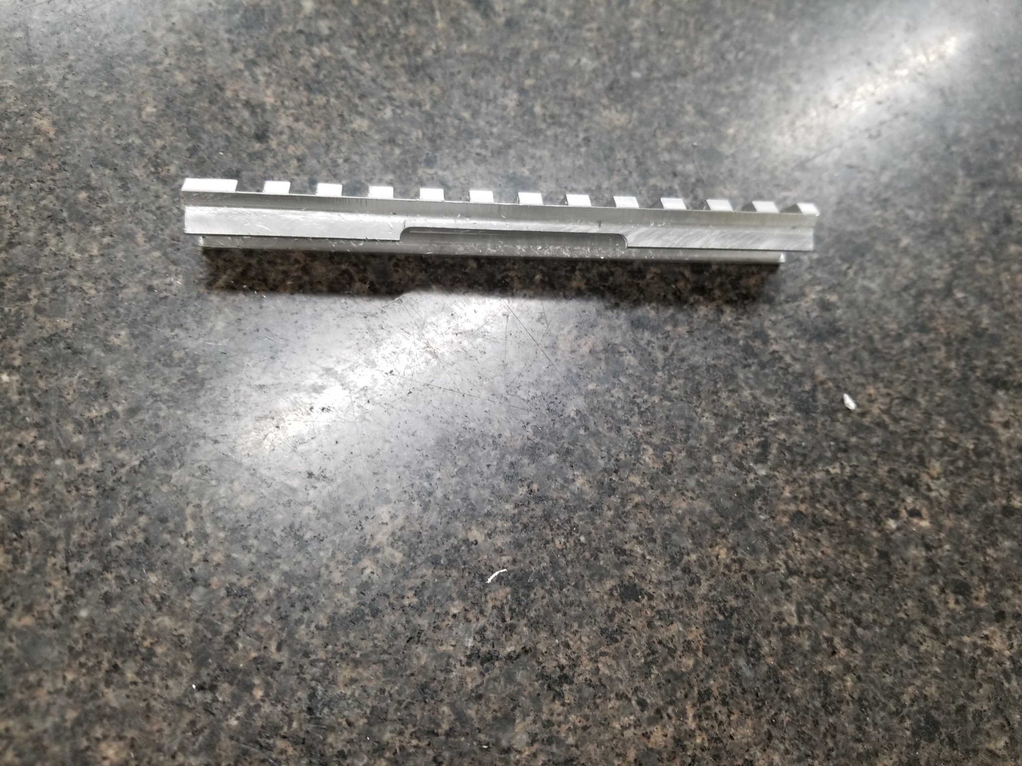

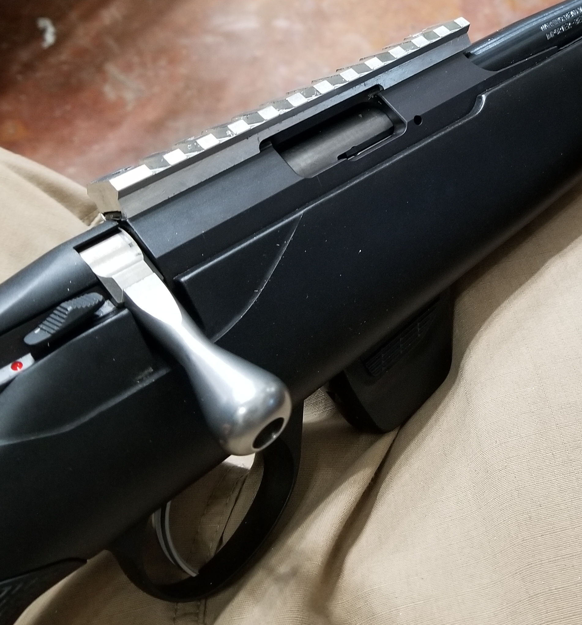

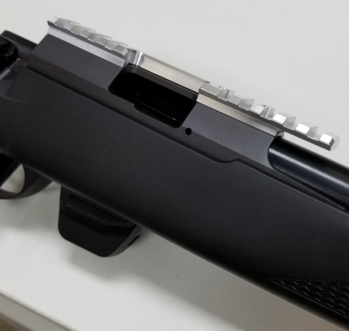

I wanted as low as possible with a 30 MOA slope so I made it myself...
Nice job! My EGW rail is definitely high for the factory stock. I checked it with the MPA chassis today and the cheek weld seems good with it.
You may have a market for those here if you plan to make them available for sale.
I think I would just mill a little material off each side of the rail you have. You only need to take 1mm off. As long as it is aluminum standard woodworking tools should do the job.
