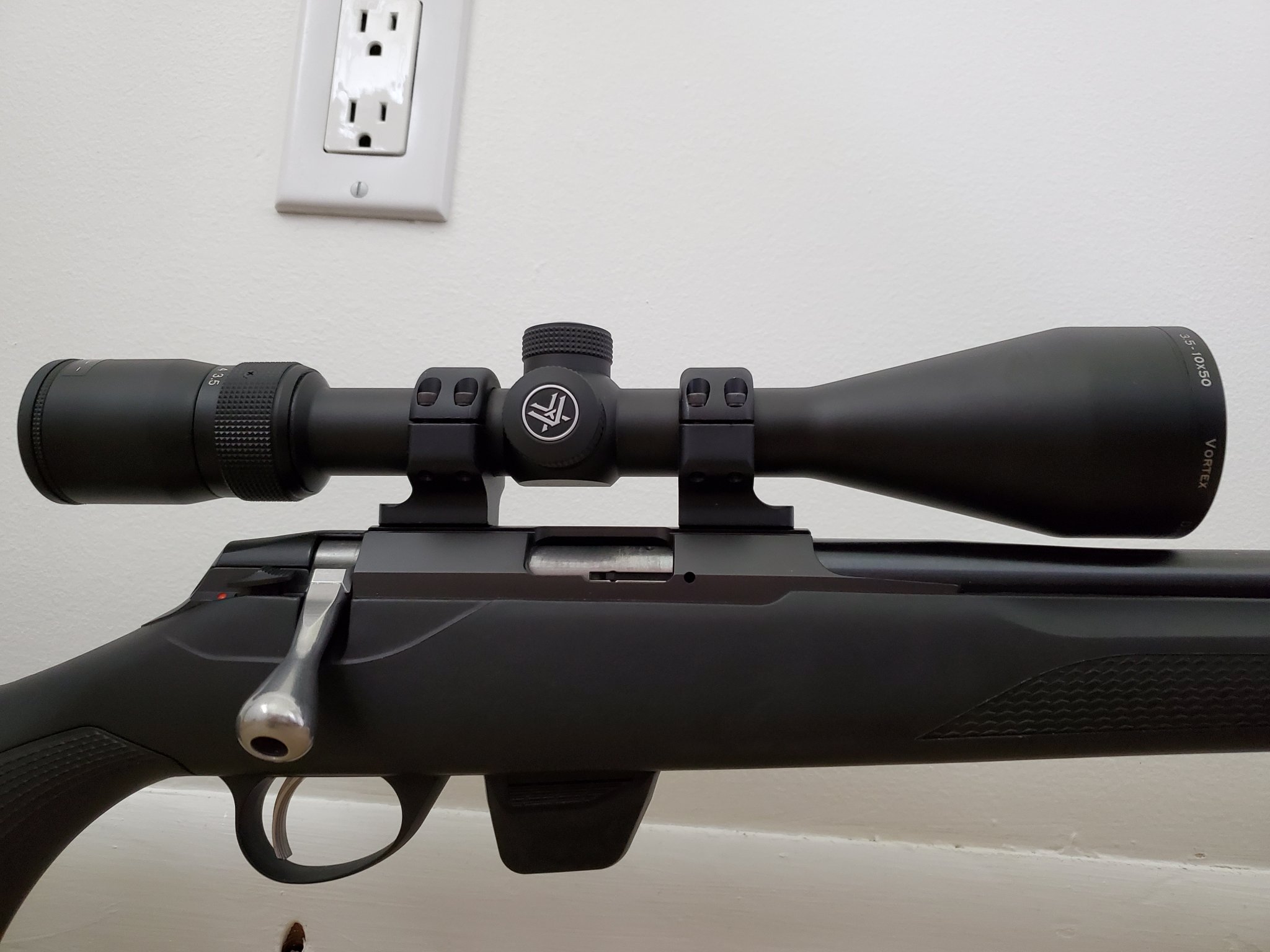

Im not sure if you got your answer. This is a 30mm tube and 50mm objective at 1.06 to center. I have a bit of play here, but I would imagine high rings would be a good fit with covers
