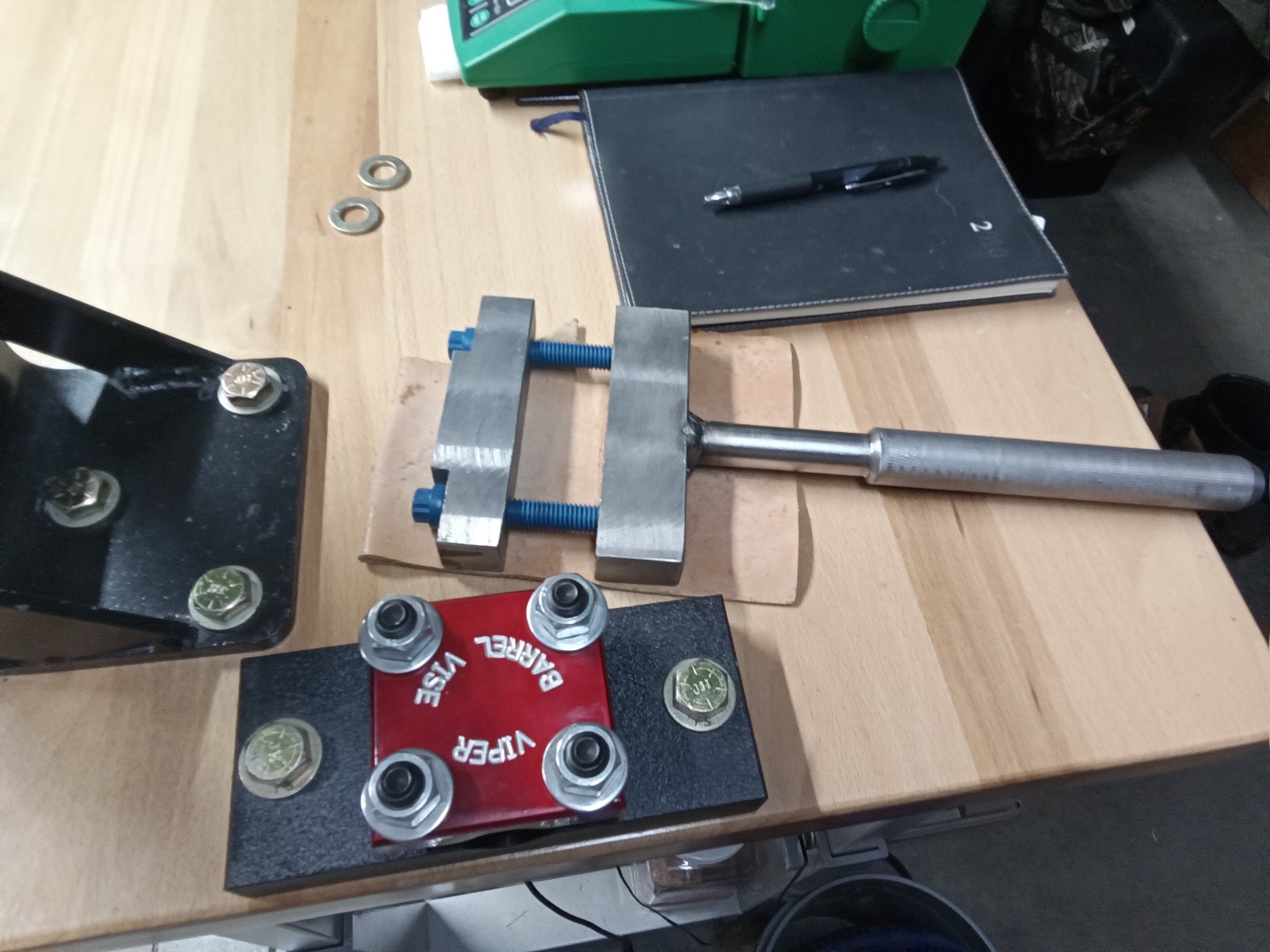

    Some take aways after struggling with a tikka barrel. I have tried several different methods over a period of days, and I understand what works now. There really is a process and if you don't follow it there will be a struggle, or worse, a broken action and or marred finish. Follow this and you probably won't have to do a relief cut. I know there are some threads on this but here you go anyhow.
    1. have the correct tools for the job. I would not rely on an internal action wrench, try to get a hold of an action wrench like the wheeler #1, that has a big flat area to grab lots of surface on the Tikka actions. a rubber or plastic mallet is a must. The addition of a cheater bar and barrel vise are going to be key. Get some powder resin, this will be important for the barrel vice to get the right amount of grip.
    2. Take your time, meaning get things set up correctly. Use some WD40 and shoot plenty of it around the inside of the barrel where it meets the action, let the barrel sit for a day or two with the barrel pointing down so the oil sinks into the action threads. It will penetrate given enough time. This stage is crucial as the oil will allow the threads to break free. This step will make your life a lot easier, trust me.... once I had my action free I could see the oil had penetrated all the way through. Prior to this step it was nearly impossible getting the action off.
    3. Use a generous amount of resin inside the barrel vise surface, and make sure to tighten the barrel vice down with as much force as possible, it must be very tight, as tight as possible. A little painters tape or even duct tape on the contacting surface might help prevent some marring, but if done correctly marring will be avoided.
    4. Once barrel is in vice and action wrench is torqued on to action, try torquing the action off, some good taps from a mallet on the action wrench where it meets the action while working the action wrench handle will provide some shock to knock things loose. Do not go with powerful whacks, this is over doing it. If the action is not budging try this with the addition of a cheater bar. If the barrel is rotating in the vice, it's too lose and needs further tightening. If it's tight and you follow these steps the action/barrel will separate.
    Good luck and may the Schwartz be with you!

    I noticed the OP said torque the action wrench bolts. This is incorrect and what I believe is the mistake people are making. Finger tighten the bolts while wiggling the handle until all the slack is out. A simple pop with the palm of my hand on the wrench handle has broken loose three Tikka barrels for me.
    DO NOT TIGHTEN THE ACTION WRENCH BOLTS!!

    The action has flats. The wrench won’t slip hand tight with all the slack removed. If you bumped ever so slightly with a wrench to feel a bit better like you said then I’m sure it wouldn’t make a difference.
    All three T3x broke with just a bump with my palm. I was literally prepared for war considering everything I read. Two were CTRs and one was a light. I also broke 2 Sako TRG barrels which I read where monsters. I held tension on the action wrench with one hand and two to three moderate wraps on the action handle with a rubber mallet and the barrels spun off. I can’t relate to what you guys are dealing with. I have one more that may get done soon. Maybe that one will be tighter. I doubt it.

    When I said torque, I didn't mean 50 foot pounds so that needs to be clarified, more like 5 foot pounds.

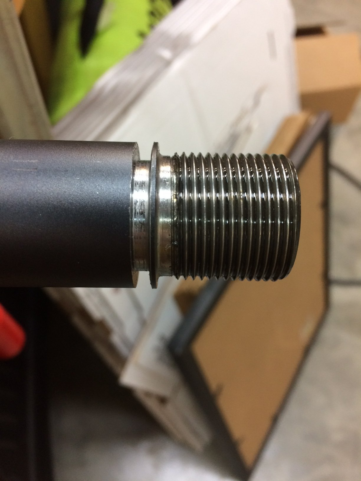

    I broke the barrel off of a Tikka T3X lite in 300wm this morning. I finally found a tight one like several of you come across. I had to really crank down on my barrel vise and beat the heck out of the action wrench handle with a rubber mallet. I was swinging the thing like I was trying to hit a fastball. It did break free and still didn’t take more than a few minutes but it was much tighter than what I previously encountered by a decent margin.

    Dunno about Tikka and Sako barrel removal, but my friend @GBMaryland does and I believe it took a relief cut to get a barrel off. Seems like difficult of removing barrels with these brands is sort of all over the place from smack with palm to 10 ton press! ;-) haha
    The Sako/Tikka receivers are warmed up and the barrels are chilled and then screwed in.
    This makes removing The OEM barrel from the receiver extremely difficult.
    The procedure seems to be cutting a relief in the barrel right in front of the receiver so that the metal will spring forward and the barrel will come off.
    Barrels installed after that are easier to get off and don’t require that.

    I've done 4 or 5 tikkas with a viper vise and wheeler #1. Since the stock tikka barrel's shoulder is tapered, the viper vise can match its contour and actually grip it. If you try and use a different vise, I think you'll have a hard time. Also, time the gun so you can just lift with your legs, and a hammer isn't really necessary.

    Clamp as close to the reciever as possible, of course you can't grab on too much of a curve of the barrel so tighten on as much surface area as possible. Use some thick cardboard shims with rosin so you don't mar the barrel. I highly recommend using WD40 on the barrel/reciever joint and let it sit verticle for at least 24hour, repeat a few squirts over six hour intervals or at least three times during the 24 hour period, you would be astounded how far the WD40 penetrates into the threads. Give it a shot after these steps are completed. The WD40 part is crucial. Both my TacA1s were a bear until I got this process correct.

    Well then it's all set. For smaller diameter barrels I like to cut a cardboard tube like for holding posters, it's thick and tough and I make the bushings/shims out of that, once the rosin is on there it gets really grippy. But you should whore on if you think it will give you more grip.

    A couple of points. First, the Viper is a decent vise but from my experience the coating limits it's grip at the limits. Second, roughly half the Tikka factory barrels I've removed have required a relief groove to be cut just past the shoulder to relieve some of the tension. Lastly, and this is not unique to Tikka, is when certain barrel/action phosphate coatings are applied, there can be a chemical reaction that allows salts to form/migrate into the barrel tenon threads which act as a thread lock.
    You might get a barrel that pops loose - I hope that's your case. However, be prepared to abandon removing the barrel without getting on the lathe and cutting a relief groove. You can permanently twist the action with an action wrench if you apply enough force.

    Just snug the action wrench onto the action. Do not over tighten as it will add pressure to the barrel threads underneath. Tighten the barrel in the vice to where the action wrench handle is parallel with the floor. Hold solid pressure on the action wrench handle with one hand while rapping the action wrench handle sharply with a heavy rubber mallet held in the other.
    I have broken several Tikka barrels with some breaking free with jus hitting the action wrench handle with the palm of my hand to a few requiring nothing more than one or two raps with a rubber mallet. Factory TRG barrels took a few more hits with a mallet but also gave no trouble. I bet you will be fine.

    Ok, I've come to report my experience(s). I just took two t3x actions off their factory barrels today. The first was from my old hunting gun (308) which had maybe 600 rounds down it. The second was a brand new rifle I bought in 7 rem mag (replacing the org barrel with a factory 7 rem mag which is threaded - %150 new from AnJ).
    So by myself I was unable to remove the factory barrel from the 308. I wailed on that action wrench (external, of course) while shoving it as hard as I could with 1 arm. Nothing at all. This was after soaking it with wd40 (repeatedly) for several days barrel down. So I got creative and called in a strong back to help me (my 18 year old son). With me hanging off the action wrench like a monkey, with 4 or 5 solid hammer blows, performed by my son with a heavy engineering hammer, it broke free just like that. Piece of cake, no marks on the action despite my pounding (or the barrel). The new action was easier. I hung off the action wrench again (hey, I can do 10 pullups at a time) and it only took one "medium" whack from my son to break it free. Again, no marks or damage to barrel or action.
    I think there is something to be said for those who break their tikka barrels free and reattach them as new as it was easier for sure. I think the easiest way though is to apply as much torque as possible and then bang, though I would certainly try firmness and a hammer blow or two first just in case it isn't necessary. I think the key is in not tightening the action wrenches too tight. I coated the flats of the action wrench with duct tape as a pad and tightened the wrench hand tight only. It was more than enough and there were no marks on either actions doing that. Better than clamping that too hard and squeezing the action threads onto the barrel.
    Oh, and heating the action did nothing for me (though I did heat it periodically when reapplying wd40 for the soaking process).
    So my advice would be (mirroring much of what was said), it is easy enough once you figure it out. Grab a buddy and a six pack (for afterwards, probably, maybe?), torque the barrel down like it owes you money (I used a breaker bar on the nuts on my barrel vise), making sure that the action is positioned so the barrel is at 300 degrees or so (a slight angle upwards is nice), hang off of it like a monkey, and have your buddy whack on it like a red headed step child.
    Hope this helps.
    Cheers!
    P.S. My action wrench was the Wheeler #1 with the triangular cut outwards - ie I used the flat side of that and gripped the action by the flat sides of the tikka action right close to the barrel. A little duct tape (or anything, really) to keep any marring away. I did have to get longer bolts, however, from the hardware store. The ones which shipped with it weren't quite long enough.
    P.P.S. The threads were all intact and perfect too, on both actions and barrels. Just for peace of mind.
    Reactions: Bakwa
