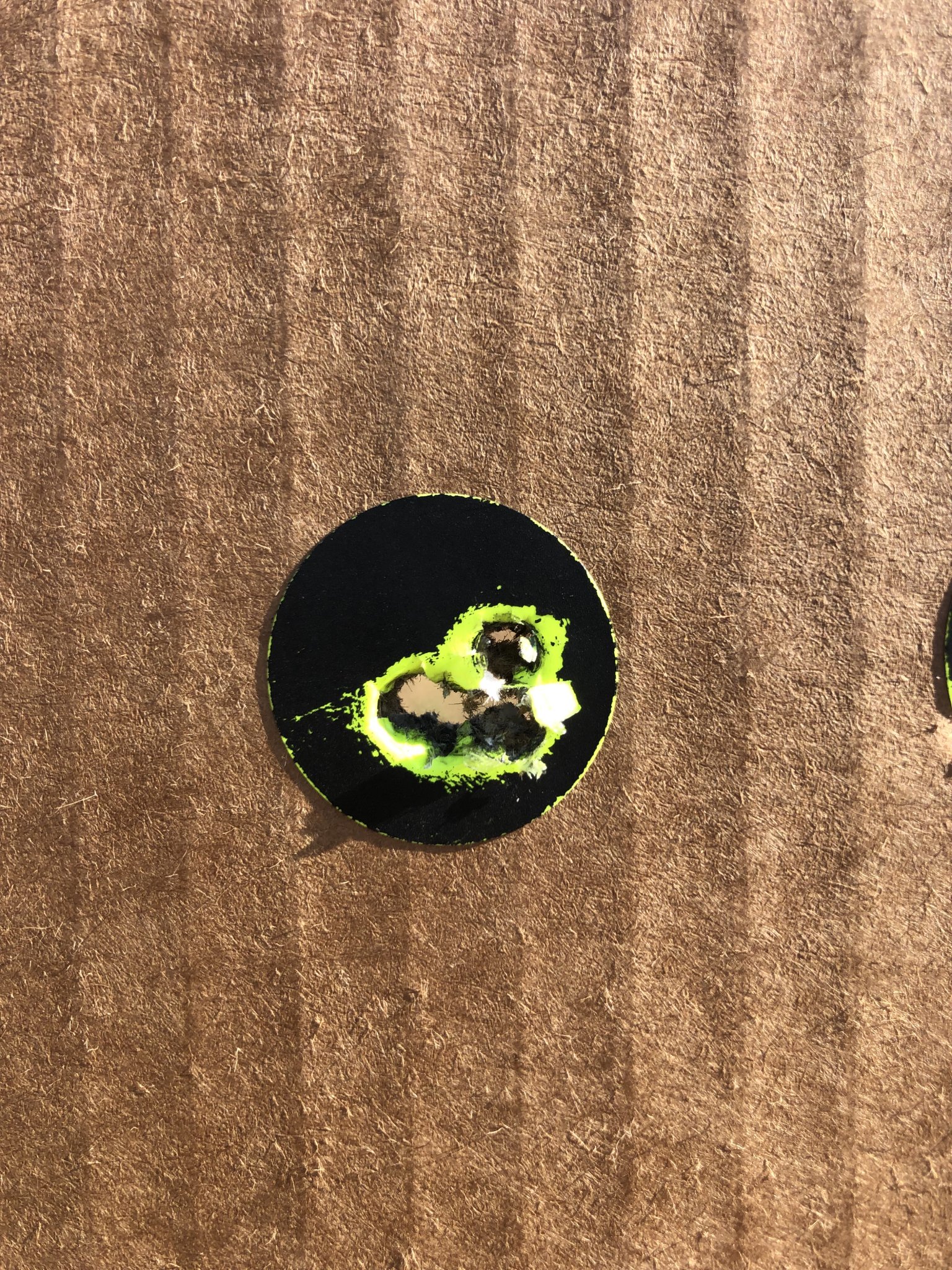

Getting around to shooting my tikka again. 32.3g of Varget and a 107 smk. Can’t argue with results
Reactions: Estes640
