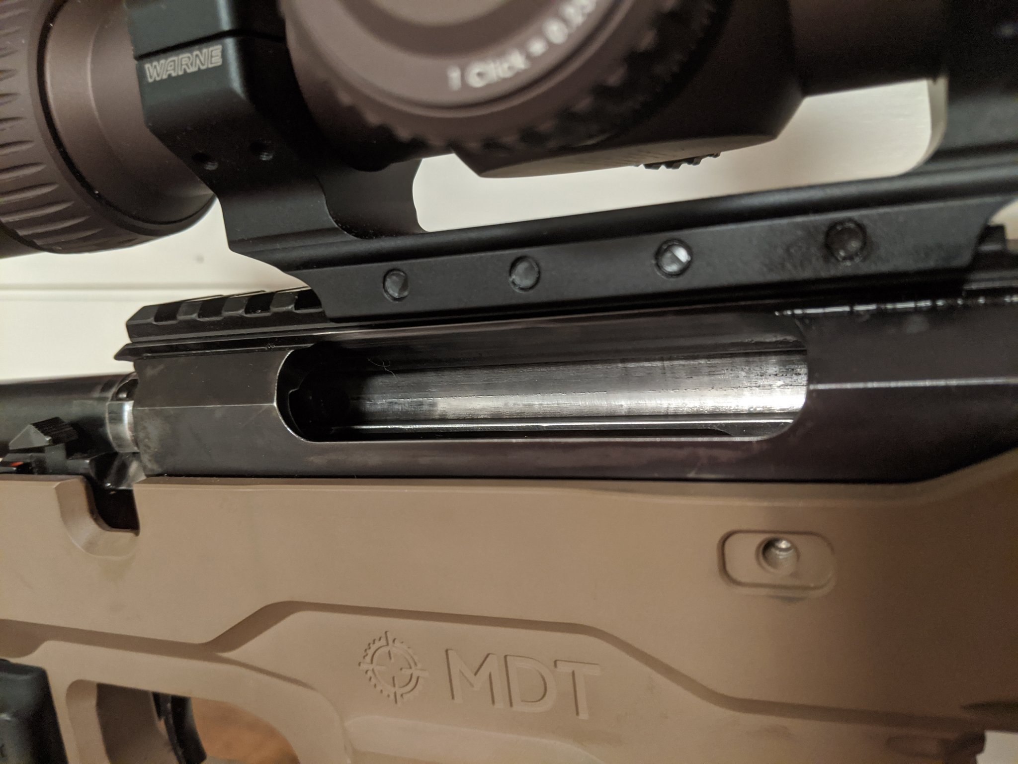

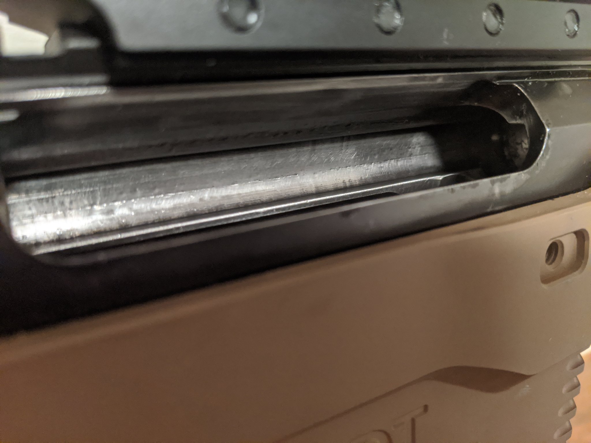

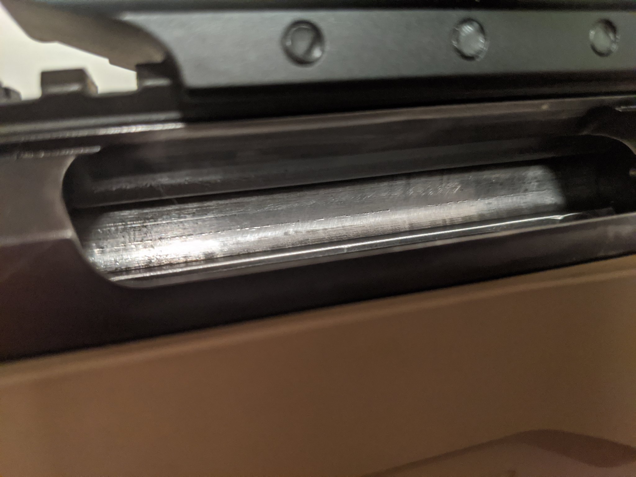

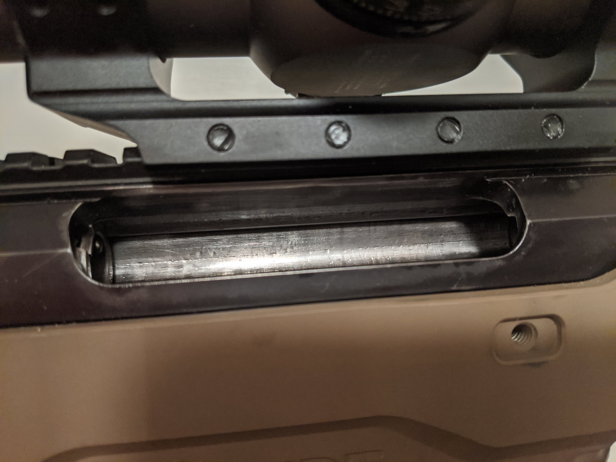

Man.. I got to watching them youtubes and pretty sure I jacked up my action. I polished it pretty damn smooth and now it runs like doodoo.
Bought a used tikka T3X and the action seemed a way more rougher than my other one.. so down the rabbit hole I went.
It sticks if you get off at an angle at all.. If I lube the crap out of it, it is tolerable. Its seems whatever finish is on the non Stainless get really sticky if you polish it.. not sure..
Is there any way to fix that? I was thinking maybe get it coated.
Here you go.. Hopefully that helps.. I noticed that "tooling" line across the middle there started to show once the bluing came off.
It really looks like ass up close like that.. used dremel with polish compounds.. it's like the more I polished it, the worst it got.. I'm like, how is this possible. First attempt on a bolt action. I have done many ARs with no issues..
The bolt polishes up real easy..
I bought the gun used and the action was rough compared to many Tikkas I have been around.. Not sure what the deal is.
My understanding is that Tikka bolt bodies are actually nickel boron coated. I have some evidence to back that up as well. Polishing it would only take that away.
I think the post above is correct. I have a few Tikka actions that are Cerakoted and after running the bolt a bunch they are every bit as slick as they were before.
-Stooxie
Reactions: SB545
Well thats no way to polish it, the way I would polish if ever needed would by adding some fine grit paste and run the bolt back and forth for the longest time, sort of like lapping scope rings. I dont think your action is ruined its been roughed up by your dremel. I would try some grit first and if that doesnt work then would probably coat it.
That's what I did first, because that is what most people do it seems. I used some scope lapping compound, that is when the problem started..Tried the dremel after that.. made it a little better. May give it a shot again and see what happens
I’m curious as to why you even did this in the first place. Tikkas have the smoothest factory action. Was it binding before? How many rounds/dry fire had been done?
Ya... It wasn't what it was suppose to be when I got it..I wonder what type of metal that is.. It seems really soft. I think the lapping opened it up too much and now it is binding if you don't pull it back perfectly strait. It is still usable, you just can't do like rapid bolt follow ups, which is what I built it for..Thinking of just buying a new SS SA rifle for $600. Got too much in the chassis to change it up.
I have another tikka (not SA) that has no issues..
Put the dremel down!

I always clean it out with acetone.
Acetone on a rifle?
I've always been a believer of, if you can't hold the solvent to your nose it has no place near a rifle.
Never thought of just using mineral spirits?
If it was that bad I would of stripped the trigger off the action and dunked it in mineral spirits and used an old tooth brush on it. Then stripped the bolt and gave it a clean then gave it a tiny re-oil.
Didn't the rifle get sold to you with the owners manual? Plenty of information in the owners manual on how to look after it. And if that fails there is always common sense.
Hopefully you haven't done too much damage and a gunsmith can get it back up and running for you.
I finally figured out the issue after getting another action. It's the damn after market bolt handle that is angled back like 45 degrees. It was causing me to put uneven pull pressure on the bolt. I put the bolt handle on the new action, same issue almost, not as bad because it isnt as smooth.
this one https://www.anarchyoutdoors.com/tikka-t3-threaded-bolt-handle-upgrade/
Reactions: Milf Dots
Hmm, see I am experiencing the same thing. When I clean the rifle and relube it, it goes away, but comes back pretty quick. I used some 5000 grit sand paper, and then some polishing compound and just hand polished the bolt and after that is when I noticed it starting. But yeah, it's binding a lot in the same exact way. I've never heard of microslick though, but thinking I'll give that a shot.
Is that something I should get only on the bolt? Or on the bolt and the inside of the action?
I would clean the bolt and action with soap and water to get ALL the grit out. Non-Pro Tip: Dawn & water will take JB Bore paste residue out of a barrel better than anything else I've tried. Follow that with some WD40 to displace the water and lube the action as needed. Send the bolt out and get it Cerakoted. Change the bolt handle.
