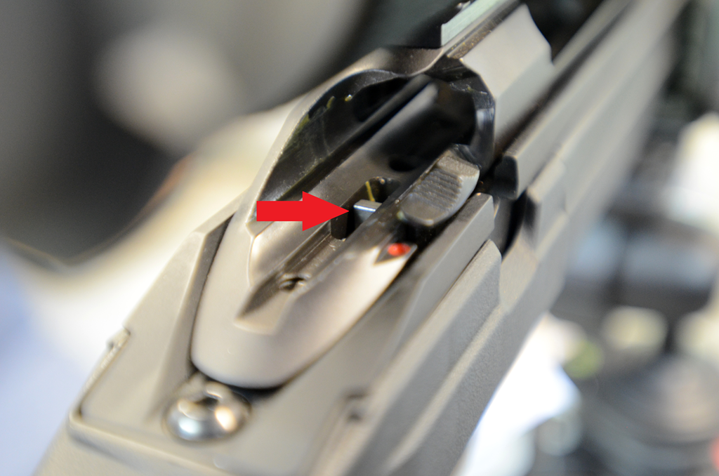

Check the top sear of the trigger for burrs or signs of galling.
7115157

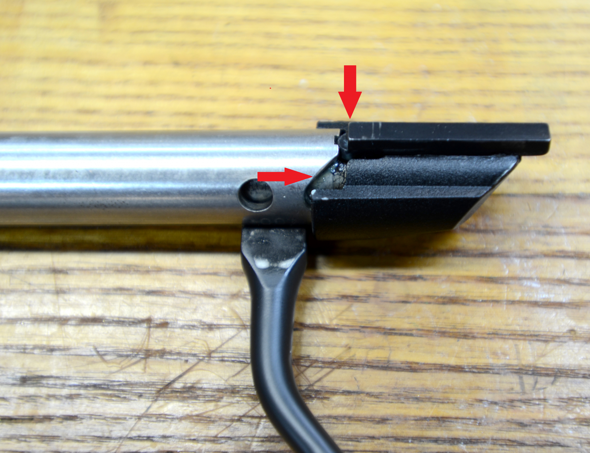

Next inspect the bolt - check the cocking piece and cocking ramp for any burrs or signs of galling.
7115159
Visible on my bolt are some faint lines on the cocking piece. This is normal, it is caused by the trigger top sear contact with the cocking piece after the firing pin has released (fired). If you find signs of galling or burrs on the cocking piece, you can try to smooth them out with a fine file. Burrs or galling on the trigger sear should just go back to Beretta.
Beyond this, you'll need to disassemble the bolt to inspect the firing pin. It isn't complicated, but depends on your level of comfort - the Tikka bolt can be tricky to reassemble without Tikka bolt shroud tool. Here again, anything you'd find should go back to Beretta.

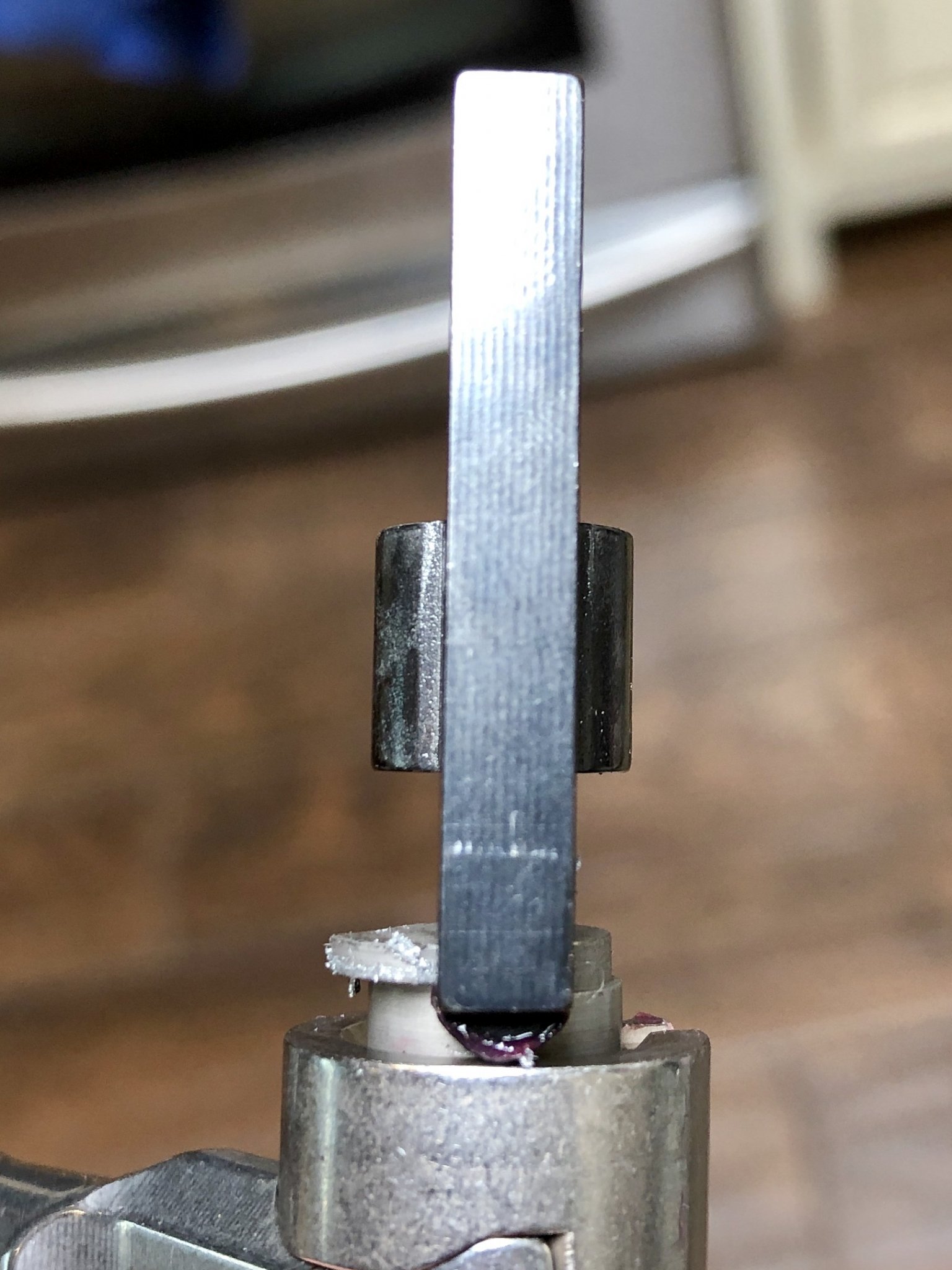

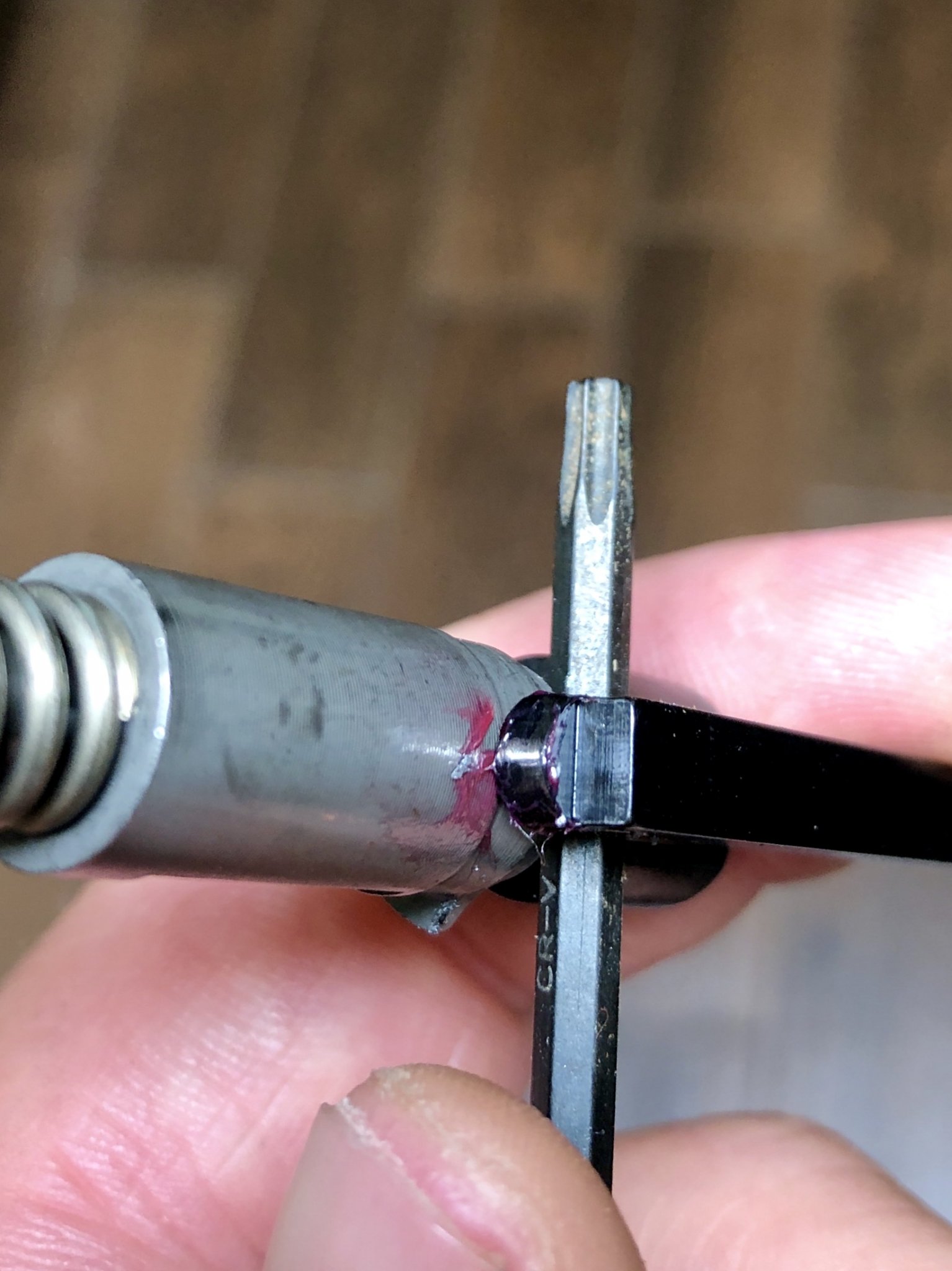

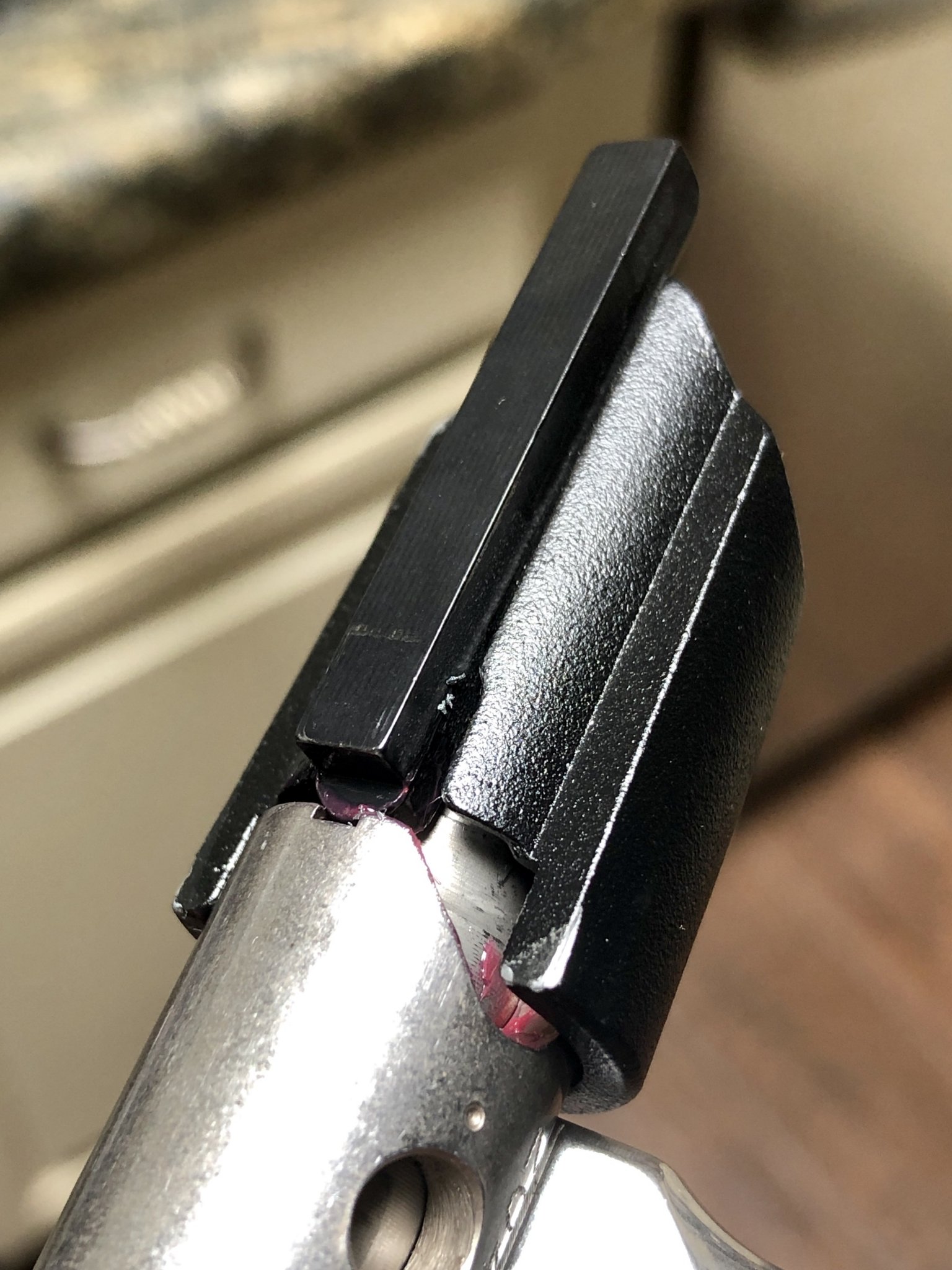

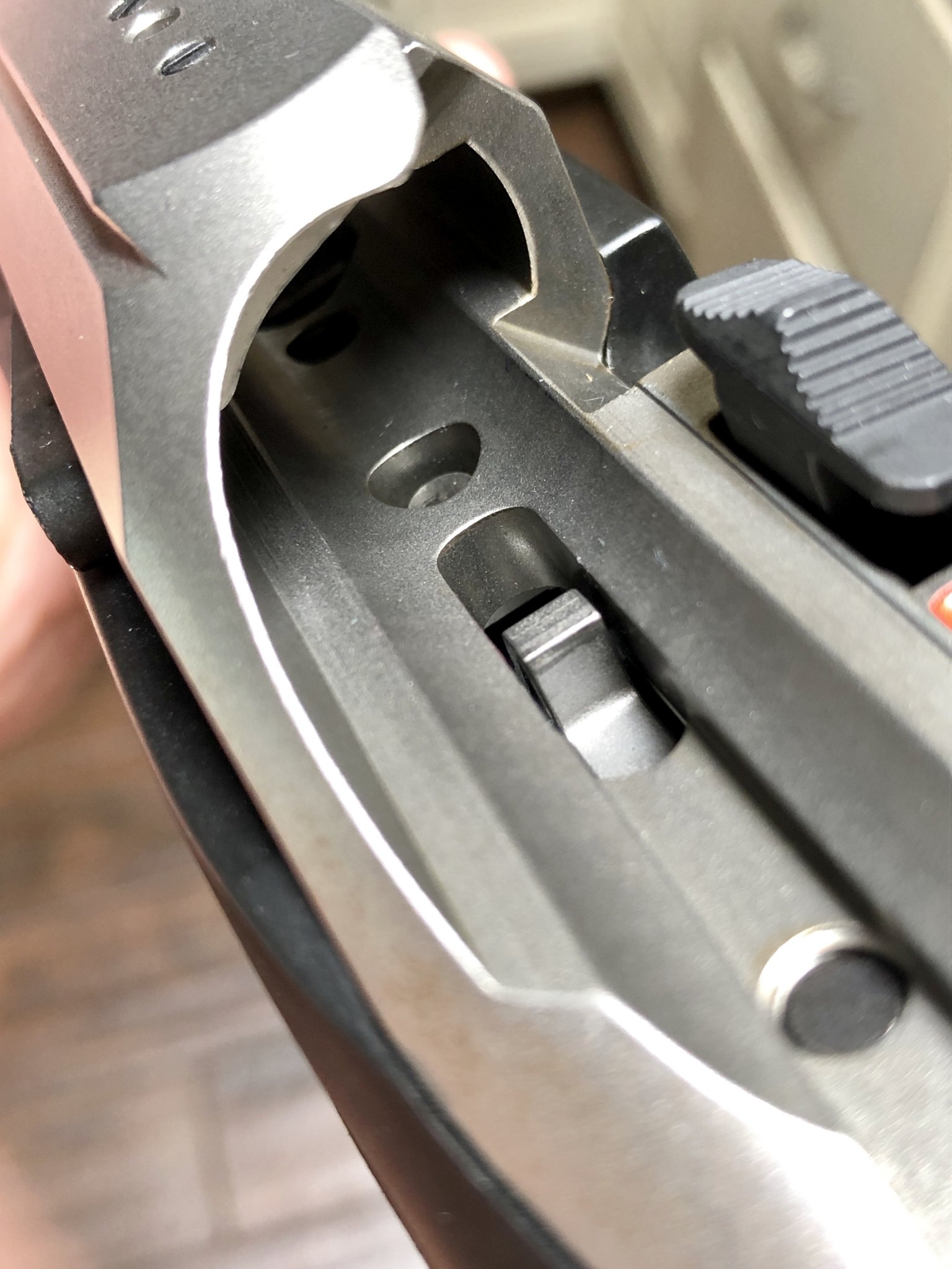

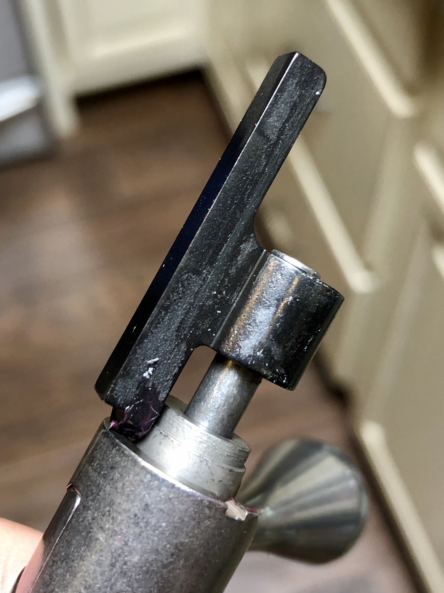

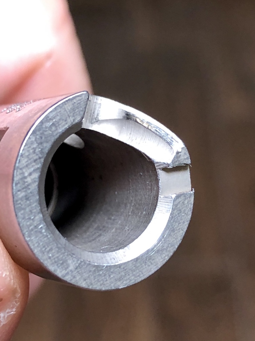

Thank you for the responses. Everything is smooth as glass with no firing pin (or no re-cocking). It’s only after it’s been dry fired and gets reset. So I pulled it apart and took some pictures straight out of the gun. There is definitely some metal shavings on the assembly. It looks like they might be from the aluminum bolt shroud, but I can’t be certain. The wear marks seem to be normal, but the loose metal shavings are concerning. Here are the pictures of everything straight out of the gun.

Everything looks normal. If the bolt action is smooth when the firing pin is held reward (unfired), it must be friction/binding when the cocking piece transitions up the cocking ramp. Did you wipe everything down, lube and reassemble? Anything change?

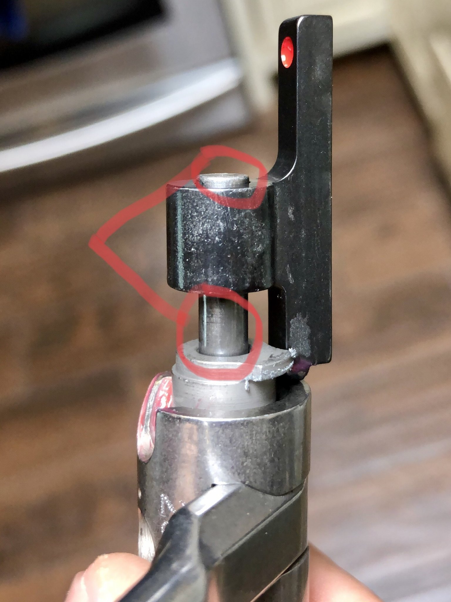

Gonna throw my 2 cents in if that's ok - there are 2 things happening when the rifle is re-cocked and the bolt handle is lifted.
1. The cocking indicator moves up the ramp.
2. The firing pin is sliding through the black metal bush (with a flat on it that the handle slides into)
If the ramp is smooth and the round 'nub' on the cocking indicator is smooth, and it's greased - then that's as much as you can probably do or see.
Here's the bit that I haven't seen anyone mention:
The pin sliding through the metal bush may be rough or require some oil so that it's not causing a heap of friction as you re-cock the handle and the pin is trying to slide through the dry/un-oiled metal bush.
When disassembling the bolt, use a small allen key or thin screwdriver through the bit between the cocking indicator and the back of the bolt - as you've done in one of your pictures with the torx wrench.
You can then wiggle/lever the allen key/screwdriver to compress the spring, exposing the part of the firing pin that needs oil - usually hidden in the black metal bush with a flat on it. Maybe even try clean that area of the firing pin before oiling, see if you find any loose bits.
Your video does show a bit of force is required - if less force is required after oiling this 'hidden' bit of firing pin, then at least you know it's that area causing the issues.

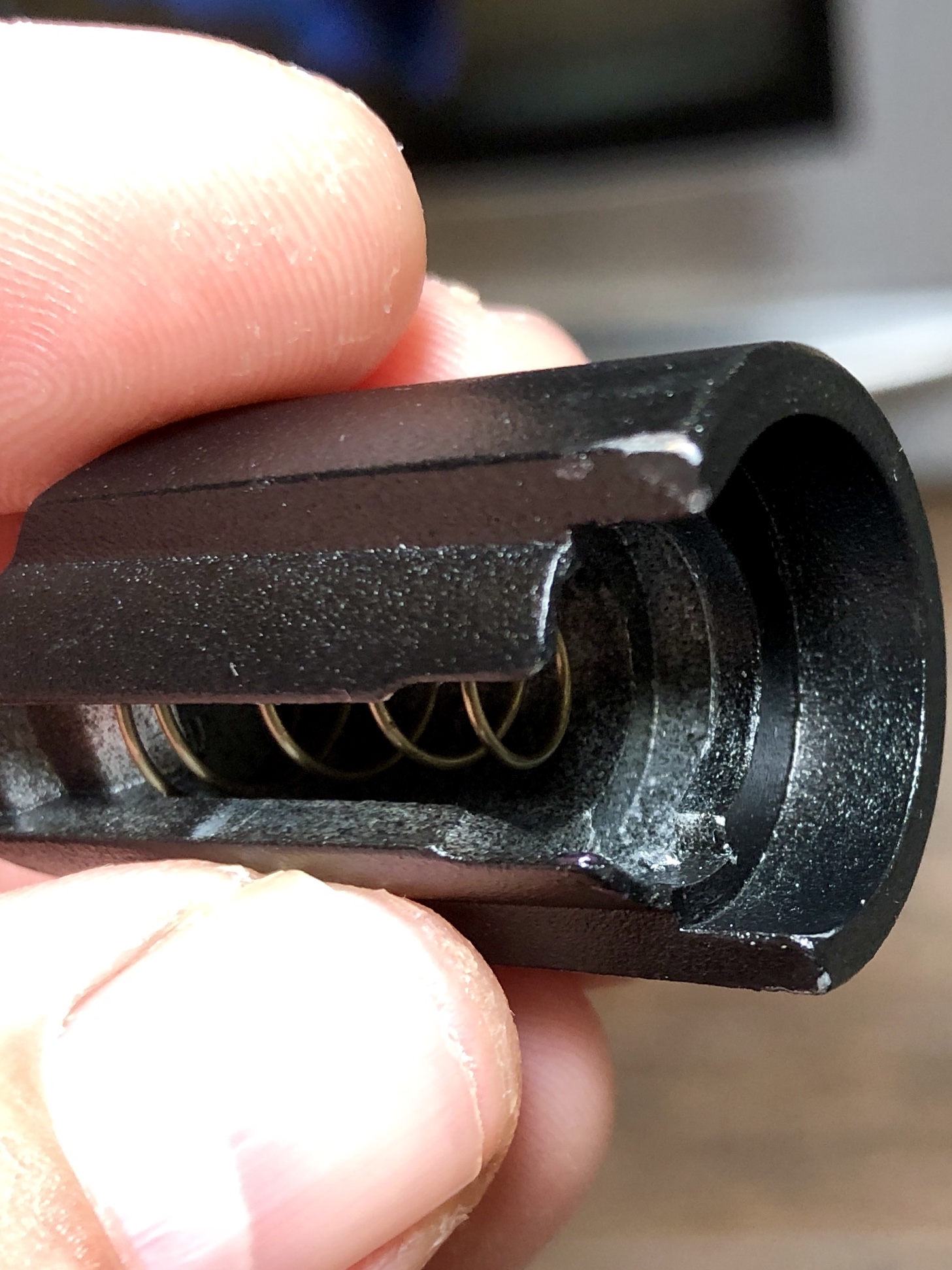

Again...Thank you guys for the replies. When I first got it I sprayed the assembly down with break cleaner then put a dab of oil on the part of the firing pin I think you are referring to cannoncrossfire. I have noticed some metal shavings on the top of the assembly, but I think they are coming from the aluminum bolt shroud. Just to make sure I have posted a picture circling the area I think we are talking about. Is this right? I’m going to clean it and lube it again and take it back to the range on Saturday. If I can’t get a group out of this thing and the bolt doesn’t lighten up I’m definitely sending it back. It would be one thing if it was a little sticky and it was keyholing shots, but if the thing is sticky and shooting 5moa not cool.

Not sure if you tried cycling bolt without shroud installed, but i had to trim the tension spring that goes into shroud cause it kept binding on me. Removing spring from shroud made all issue go away, but then the shroud has some play. The spring is also what causes the aluminum shavings by rubbing on the shroud.
The spring ends could be rough/sharp and galling the aluminum. If they are just smooth them with fine sandpaper or a fine diamond file. The spring ends may be flared slightly which would magnify the issue. Bending the spring ends away from contact surfaces a few thousandths wouldn't hurt either.

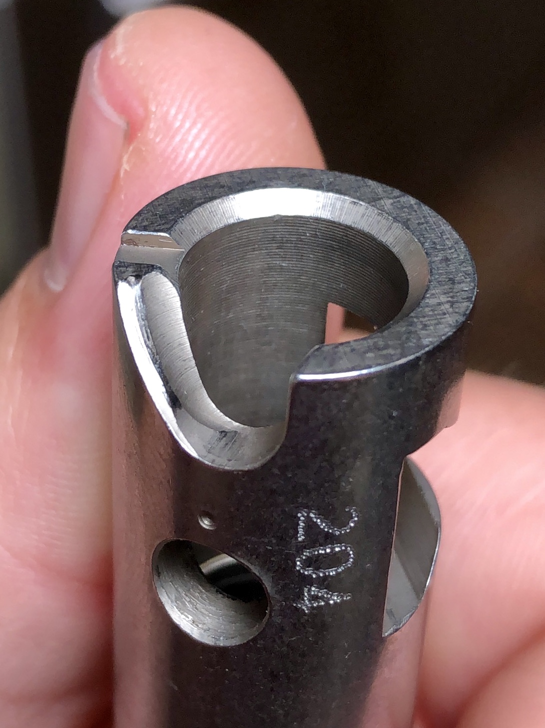

I got about 40-50 rounds through it now. I haven’t talked to Sportsman’s about returning it, but I did cycle a few of the same rifles (T3x superlite) chambered in a different caliber and they felt similar. I haven’t tried it without the shroud, but I will look into a bit more to see if that’s what is causing the hang up. As far as torquing the action down I followed that procedure to seat the lug then I torqued it to whatever the manual said...I think 40 something inch pounds. Scope rings are all torqued to spec.

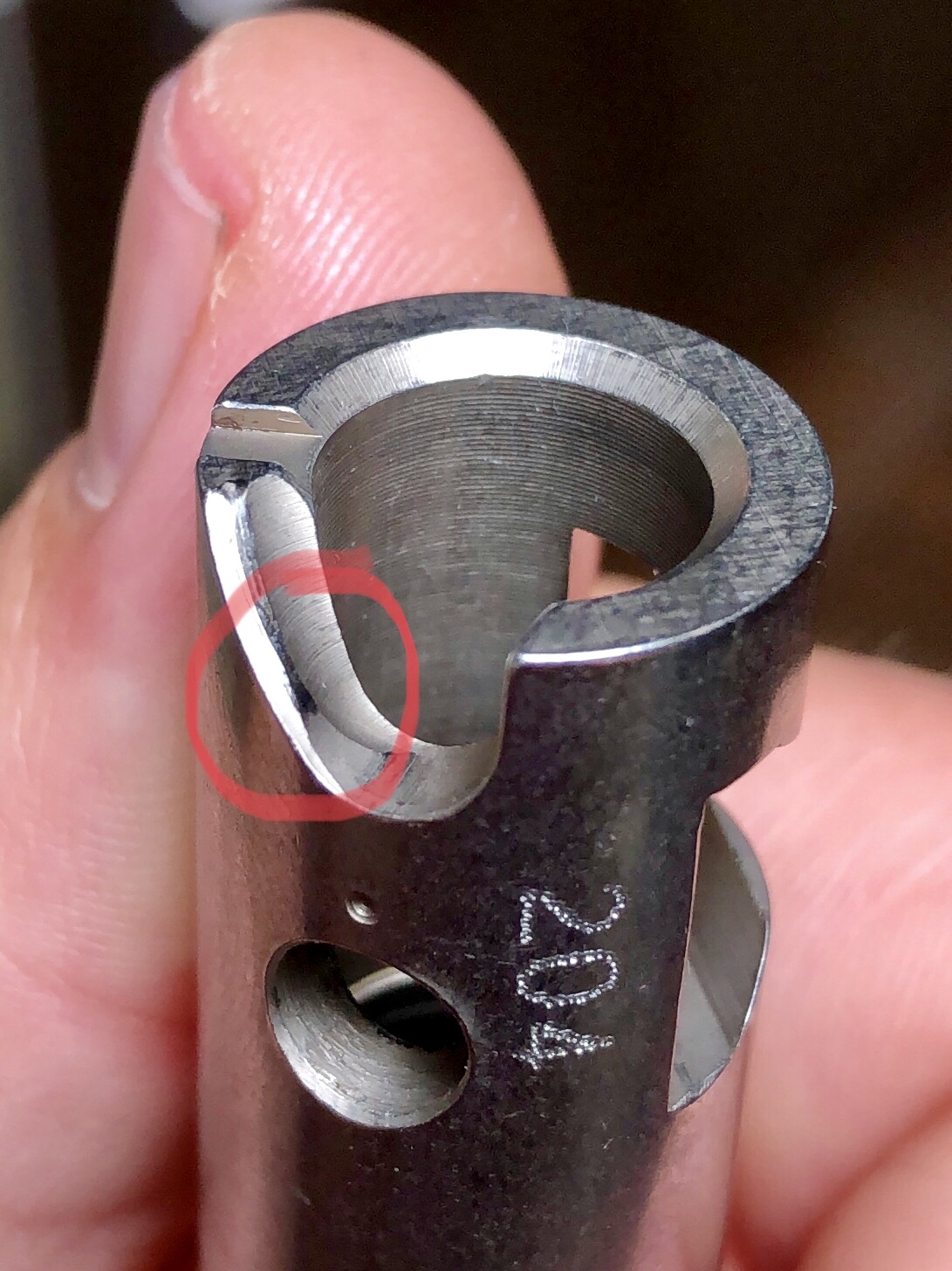

Let me ask you guys this...what if I were to polish this area circled on the feed ramp? It seems like the hang up is happening right where the wear marks start and that is where it is the heaviest. Could this possibly be the problem and is there any risk to doing this?
Minor deburring and polishing is something I do with most all of my guns. Diamond files, ceramic stones, and a dremel with felts and polishing compound are your friend.

Pulled the shroud and it seems like the hang up is coming from the first part of the ramp. Once it clears this spot it’s smooth. So I’m wondering if I hit it with the Dremel with a felt pad and some polishing compound it will smooth out?
Looks like it might take a little more that felt and compound. Maybe a small fine Dremel grinding stone or small round file. I have a few chainsaw sharpening files that come in handy for fine radius work. Also a wooden dowel with double faced masking tape and emery cloth or wet-dry sandpaper works.
If I go more aggressive with it do I run the risk of going too much? I mean within obvious common sense standards ha.
Without having the pieces in my hand I can't say. With most first time situations like this baby steps are safest. I'm talking a few thousandths, refit and test and repeat. It wouldn't hurt to mark the surface(s) you're altering with a Sharpie or Dykem so you can see the amount of contact on the parts.

I notice wear on the bolt shroud that looks like it is catching on the small tab attached to the rear of the firing pin body
That contact should not be happening
Clean up the shroud and apply sharpie pen to cover worn area and reassemble see if this is in contact
