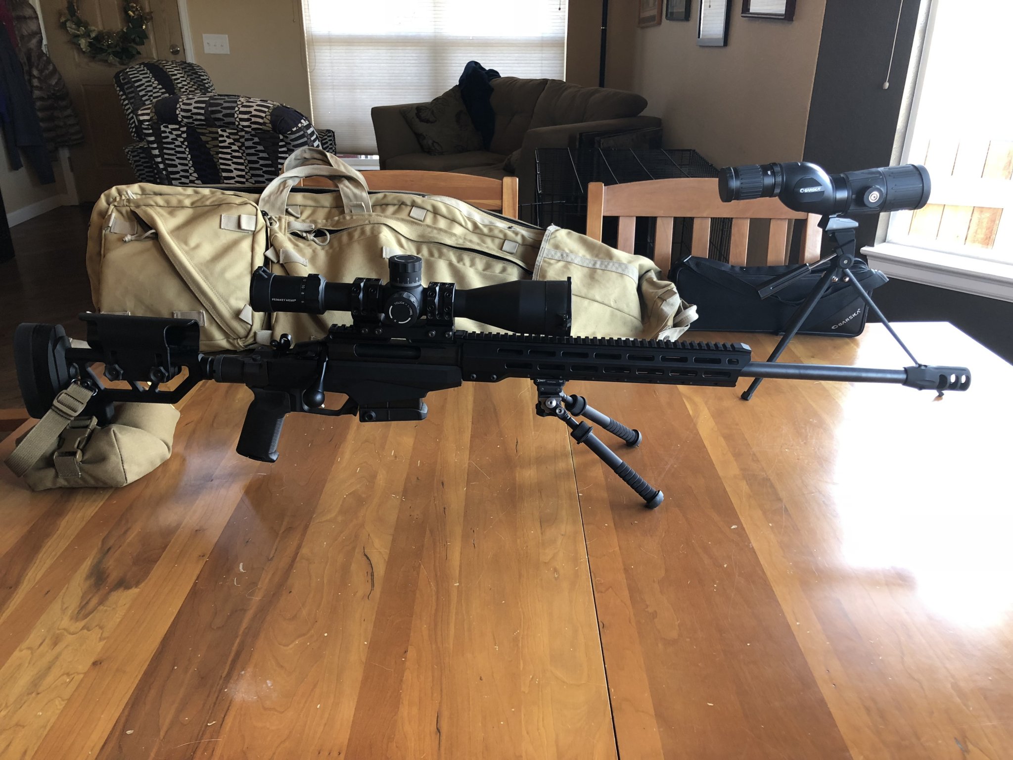

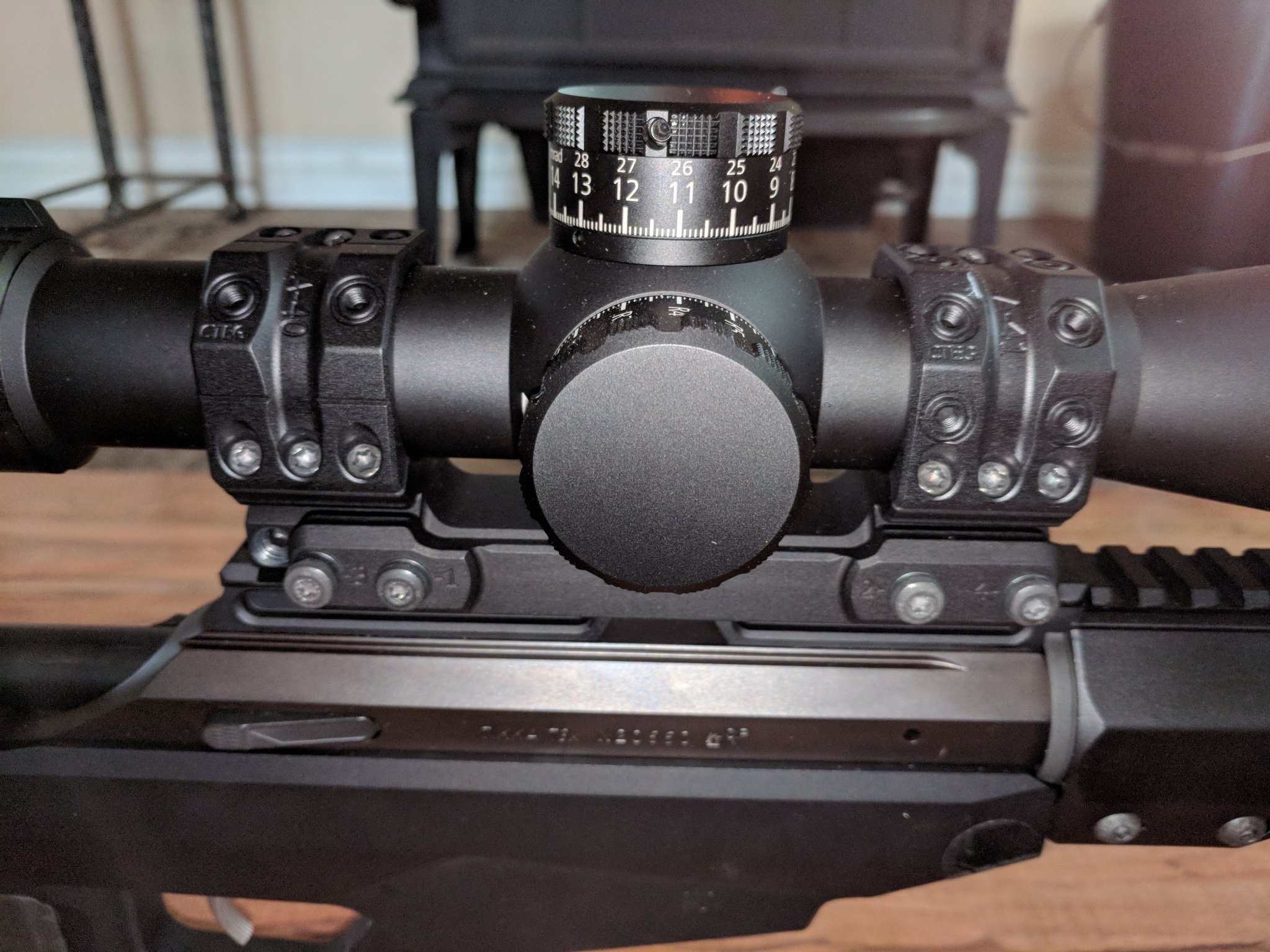

Spuhr SP- 4602
https://spuhrwebshop.com/en/isms/sp/34/6/sp-4602.html

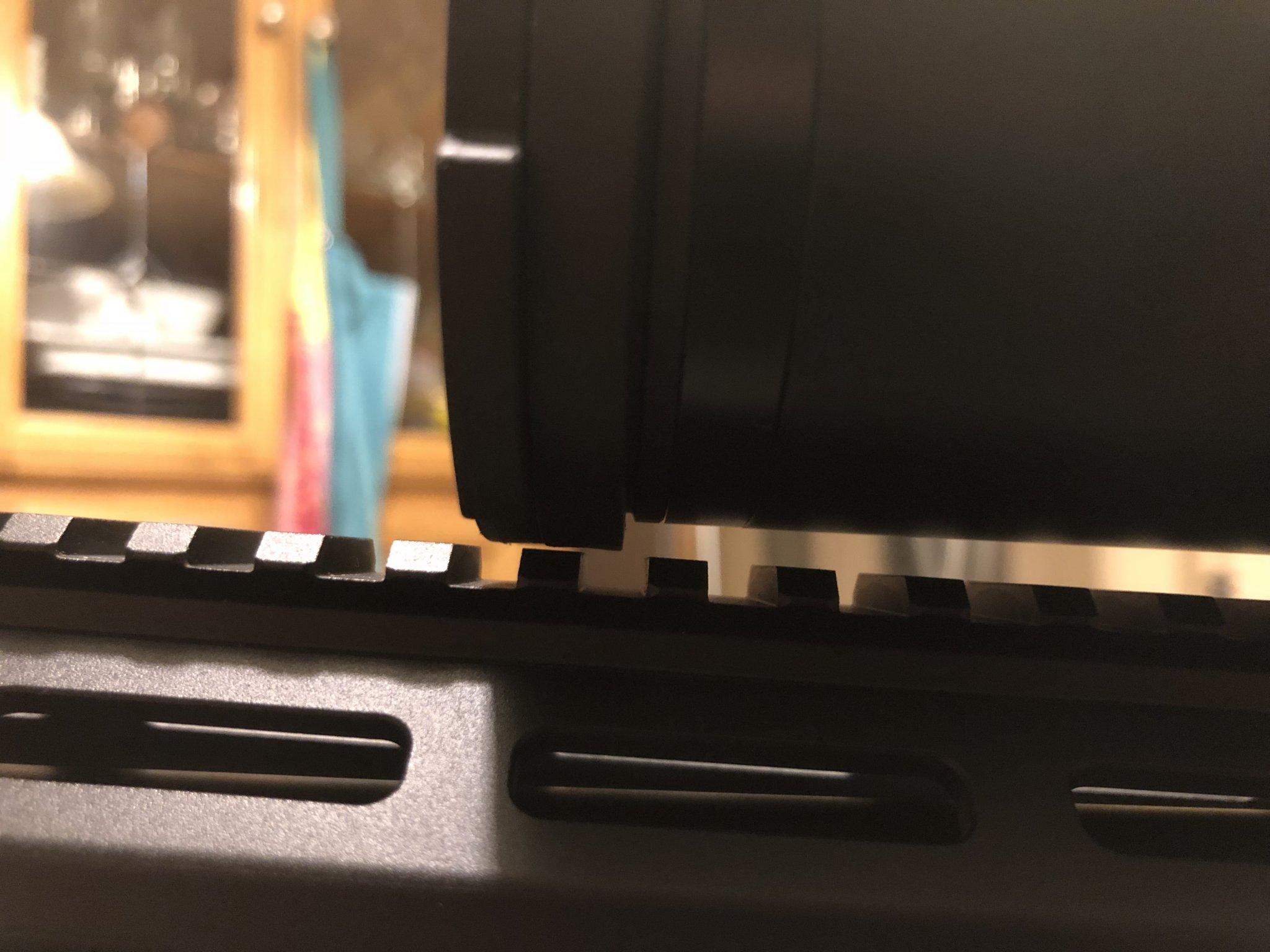

With the 44.4 Mia base (4902) it will still work, I have a S&B 5-25x56 on the same rifle and it works just barely.

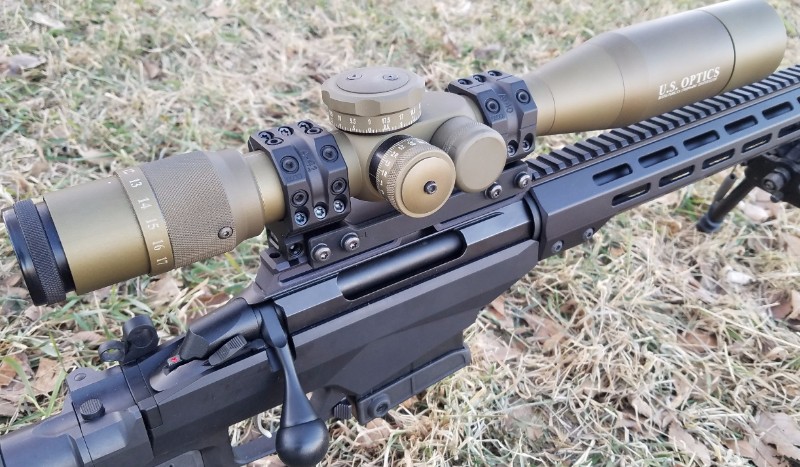

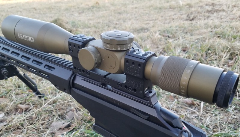

I went with a 20 MOA Spuhr mount on my Tikka, with how securely Tikka puts the bases on I didn't want to mess with removing it. My USO T-Pal scope caused another issue of having enough distance between the rings, but Spuhr has so many options, they had just what I needed.

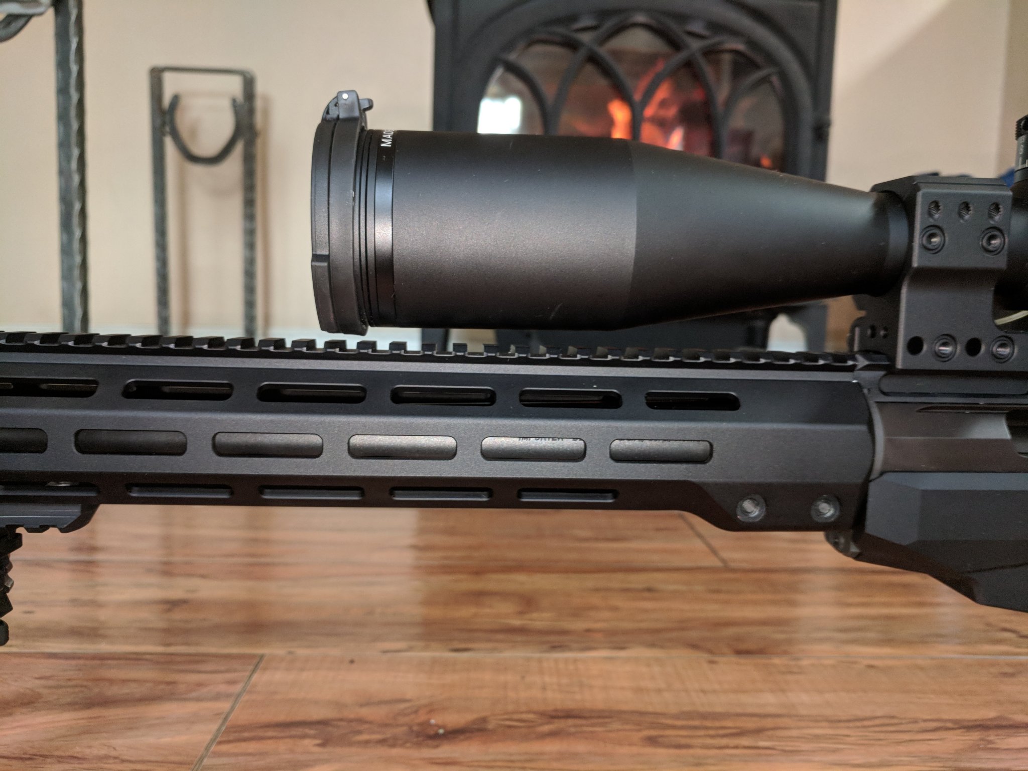

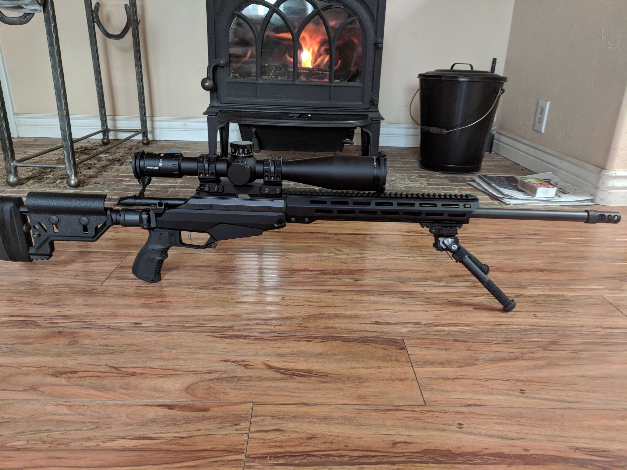

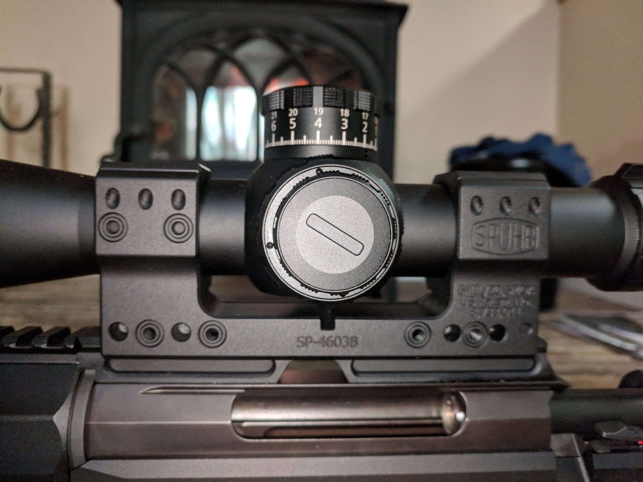

Very nice. I've got a Tac A1 and just ordered a Minox ZP5 5-25. Thinking Spuhr mount. Which one did you get?
I used Burris XTR Signature Rings to achieve roughly 30MOA of cant on my Tac A1. Didn't have to fiddle with the factory rail that way. 1.5" High, 30mm rings for my 50mm objective scope + lens caps worked well.

Got the SP4603B . Perfect fit with the ZP5. Best mount I've ever used.
