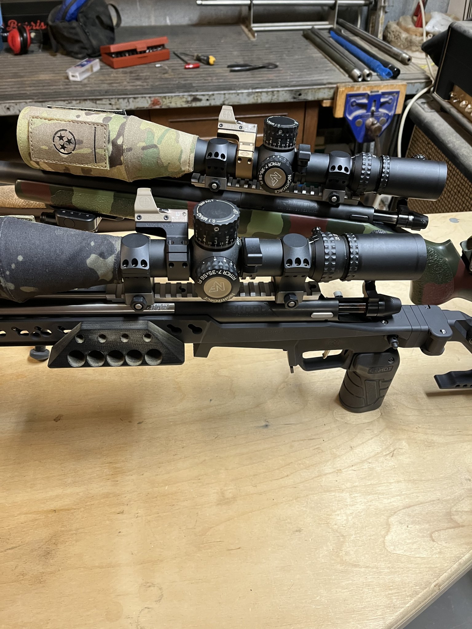

Scope height is an area in which you will have to play around in to see what you like. It used to be lower was thought of as better.
Nowadays many people, like myself, like a heads up position vs laying your head sideways on the buttstock.
For me, on most bolt actions, a 1.25” to 1.5” centerline height is ideal. This is measured from the top of the picatinny rail (technically, from the bottom of the scope ring, which is just above the top of the picatinny rail) to the center of the scope tube.
Some scope rings are measured from the top of the picatinny rail to the bottom of where the scope rests. So just make sure you know what you’re looking at.
One way to test a setup before you buy is to lay biz cards or coins on the pic rail and to carefully place your scope on there. Get behind it and can see what you like.
For rings, as a beginner, man, I suggest ARC Mbrace rings. Heck, I suggest his rings to everybody. They’re pretty popular.
They are, bar none, the easiest to use and are super-high quality. The scope tube won’t rotate as you tighten the ring bolts like in most other designs.
And instead of up to eight screws per ring (6 on ring caps, 2 for rail) the Mbrace rings have just two screws total per ring. Follow the directions, however.
Here’s a link. He has an illustrated penny method of figuring out scope height under the “Height” tab, down a ways on that page.

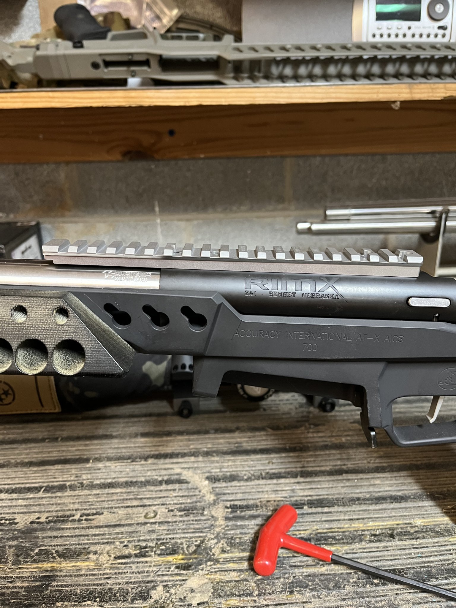

I second the Murphy Precision 20 MOA rail. I put one on my CTR and it was a tight fight with those two locator pins.
Secondly, I am disappointed with Mountain Tactical. I purchased an extended length 20 MOA rail and it went on beautifully. Decided I prefer the receiver length instead and bought another one of their rails. On this one 2 of the screw holes would not line up with tthe receiver. Sent it back to Mtn Precision and was told there was nothing wrong with it even though the rail would bow when trying to install it. Said screw it and bought the Murphy rail and am very happy with it.
Did not like the Area 419 rail. The recoil lug was not machined in and the hole on the rail for the lug was very loose.
