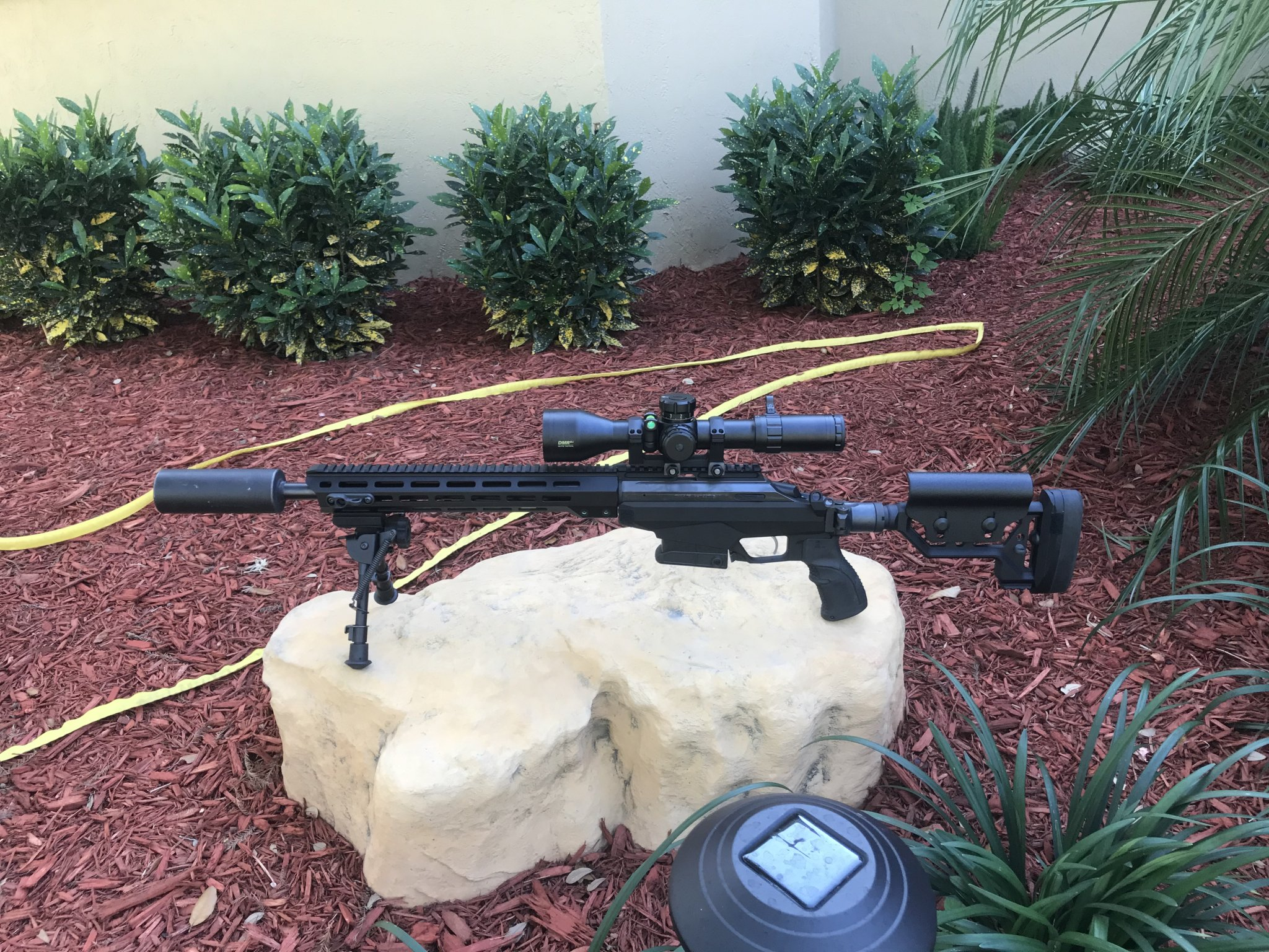

ADM makes some nice mounts you could check. Depending on caliber and how far you intend to shoot you may not need 20MOA. Which you could then run rings .Seekins precision rings are good. You can also get a 20 MOA rail from EGW for the Tac A1 they are kinda bitch to get the factory rail off though. I have the seekins rings on my my tac A1 at o MOA. Thought about changing out rail but for what I use it for 1000 yrds max it's fine. I will say I have a spur mount on another gun and it is very very nice. Pricey but nice.

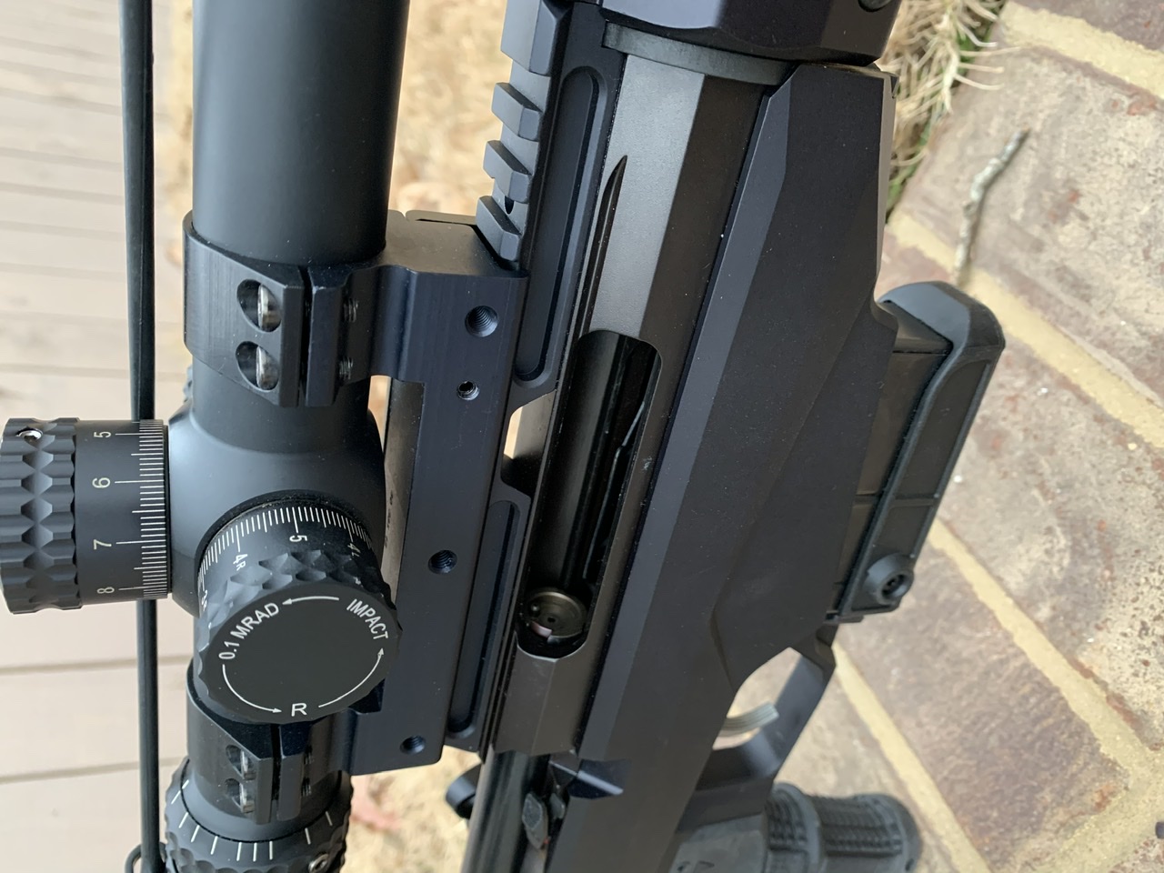

ADM Delta throw lever mounts are sweet and you cannot beat the tried and true Accuracy International 1 piece scope mounts. I do not know why these dont get the love and respect they deserve. They are $125 new from mile high and often under 100 here. I challenge any scope mounting system that can do what it does for the same price. They were used on the AW series for years and Im sure the old videos from Todd at AI and Bill at Tacpro showing the repeatability of them.
i have a pic on my phone of the AI mount on a Tac A1 ill try to post

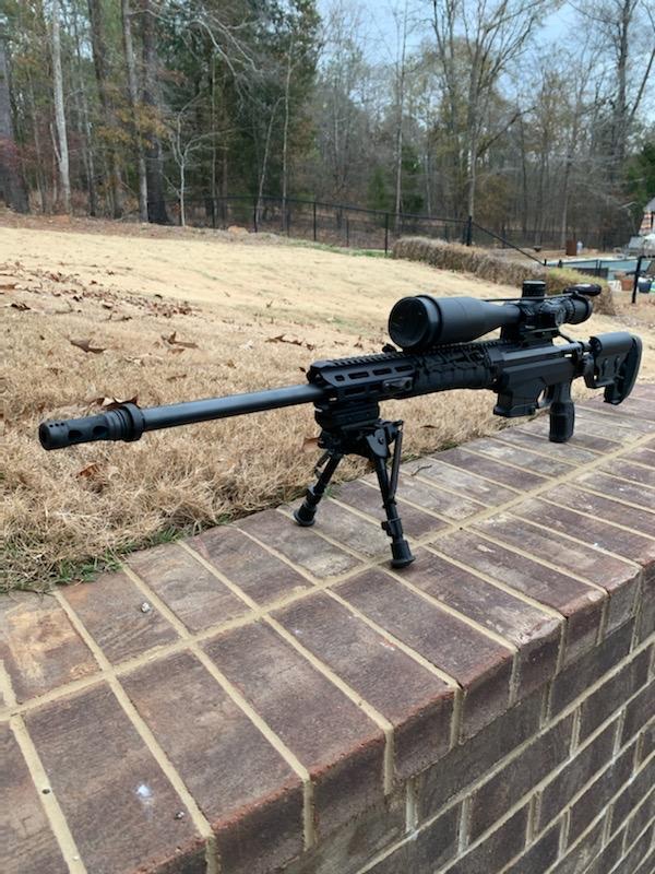

I had replied earlier but since then switched scopes around and now am now running a Badger Ordnance 1-Piece on my TAC-A1 with good results. There is 0 MOA in this particular mount but easily get to 700 yards.
