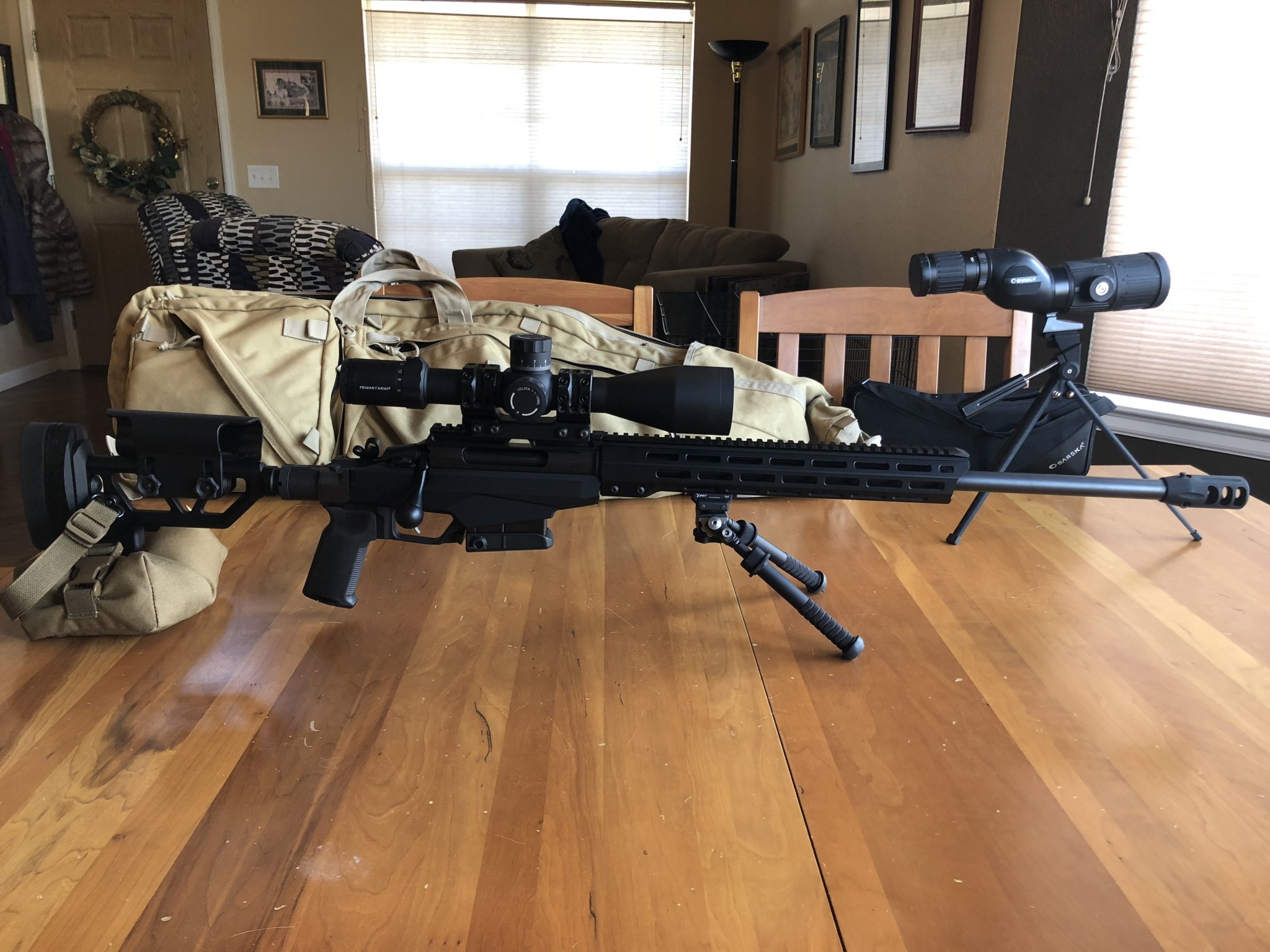

I went to the LGS to purchase the Bergara LRP today but wanted to take one last look at the Tikka. After handling the Tikka I decided to hold off on the LRP and maybe purchase this instead. The problem I'm having is that I want to go with the Vortex Razor Gen II 4.5-27x56 and it looks like with the 0 MOA rail and the picatinny rail the scope mount in going to be pretty tall. Does anyone have any pictures of this particular setup or give me an idea of what to expect. I don't want to buy any of this stuff twice so i thought I'd ask before spending the money. I've seen a few people mention a 1.5" mount but I'm not sure how that would affect overall head position or comfort.
Pics with a USO B17 and a Razor AMG. Both using a 1.57” ARC M10 Unimount. Started with the B17 but have switched to the AMG.
Both mounts are 30 MOA mounts.

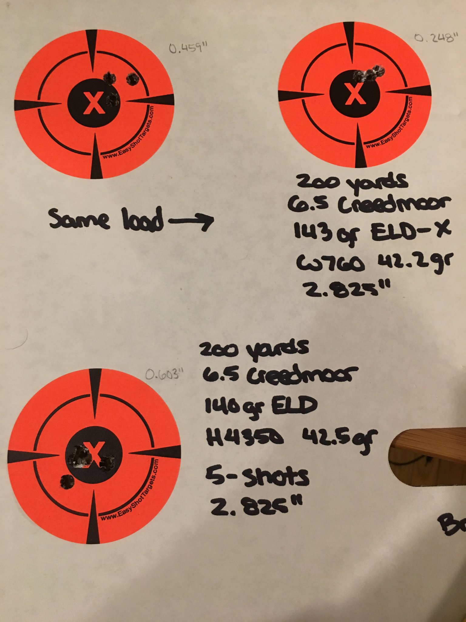

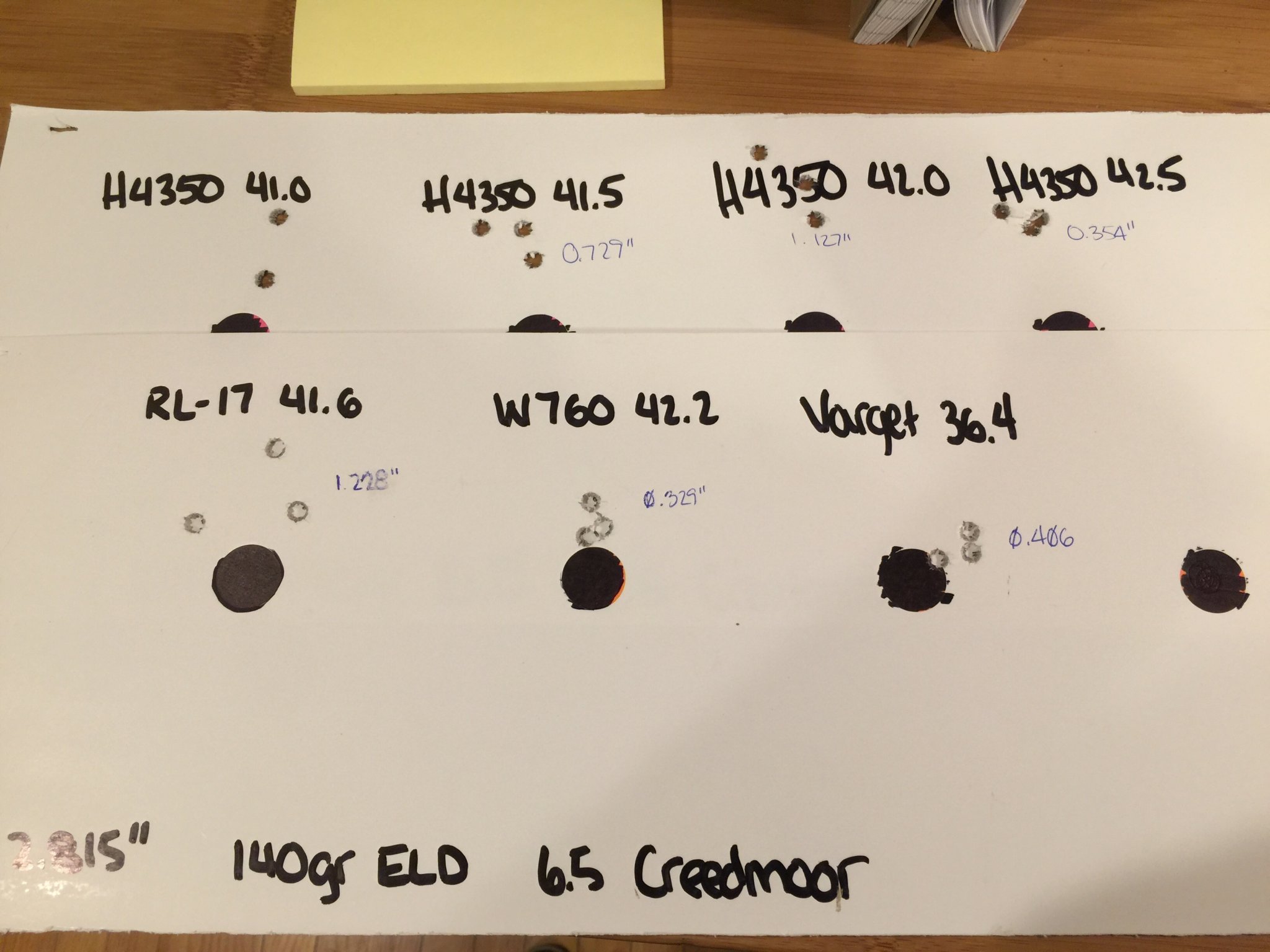

Here's my Tikka Tac A1 and some load development that I did. I ended up going with 140gr ELD Match / 42.5gr H4350 / CCI BR2 as my load because it had the lowest standard deviation.
This rifle has been an absolute pleasure to have the last couple of years. I'm at 650 rounds down the barrel and just did my first PRS match with it a few weeks ago. Thankfully there was no wind so I was able to get headshots on IPSC targets on command. It's currently sporting a Vortex Razor HD Gen II 4.5-27x in a JP Enterprises 0 MOA mount. I may opt for the Nightforce 20 MOA mount eventually, but for now it's plenty. I swapped out the brake and put on an APA Little Bastard Gen II. At this point, I can spot my impacts from almost all shotting positions as long as I'm not being a magnification whore :X (not shown in photo)
Also - Installed a Yo Dave trigger spring as Frank recommended in his video. AMAZING upgrade for $10. The trigger went from good to great with that upgrade as it smooths out the first stage and allows you to get the pull weight to under 1lb if you desire. I left mine at 2lbs, but it's a super great feeling trigger.

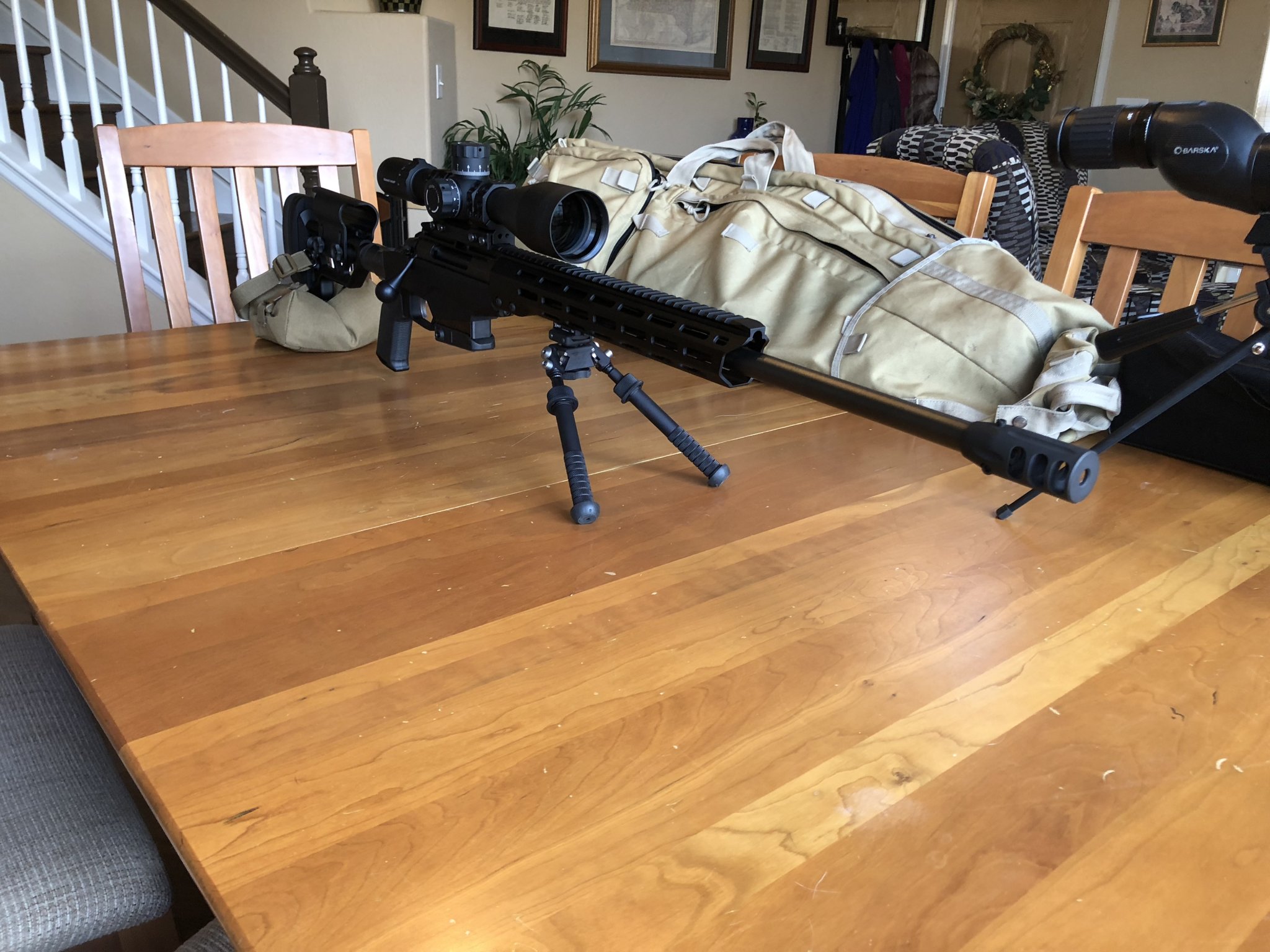

In the unlikely event that the OP is still looking for a photo of a Vortex Razor Gen II 4.5-27x56 mounted on a Tac A1, here's mine with AADMOUNT caps. With a Spuhr SP-4603B mount (1.496" high, 20.6MOA rake), the objective cap clears the rail by 0.0750" -- six playing cards (0.0690") will fit in the gap, seven playing cards (0.0805") won't.

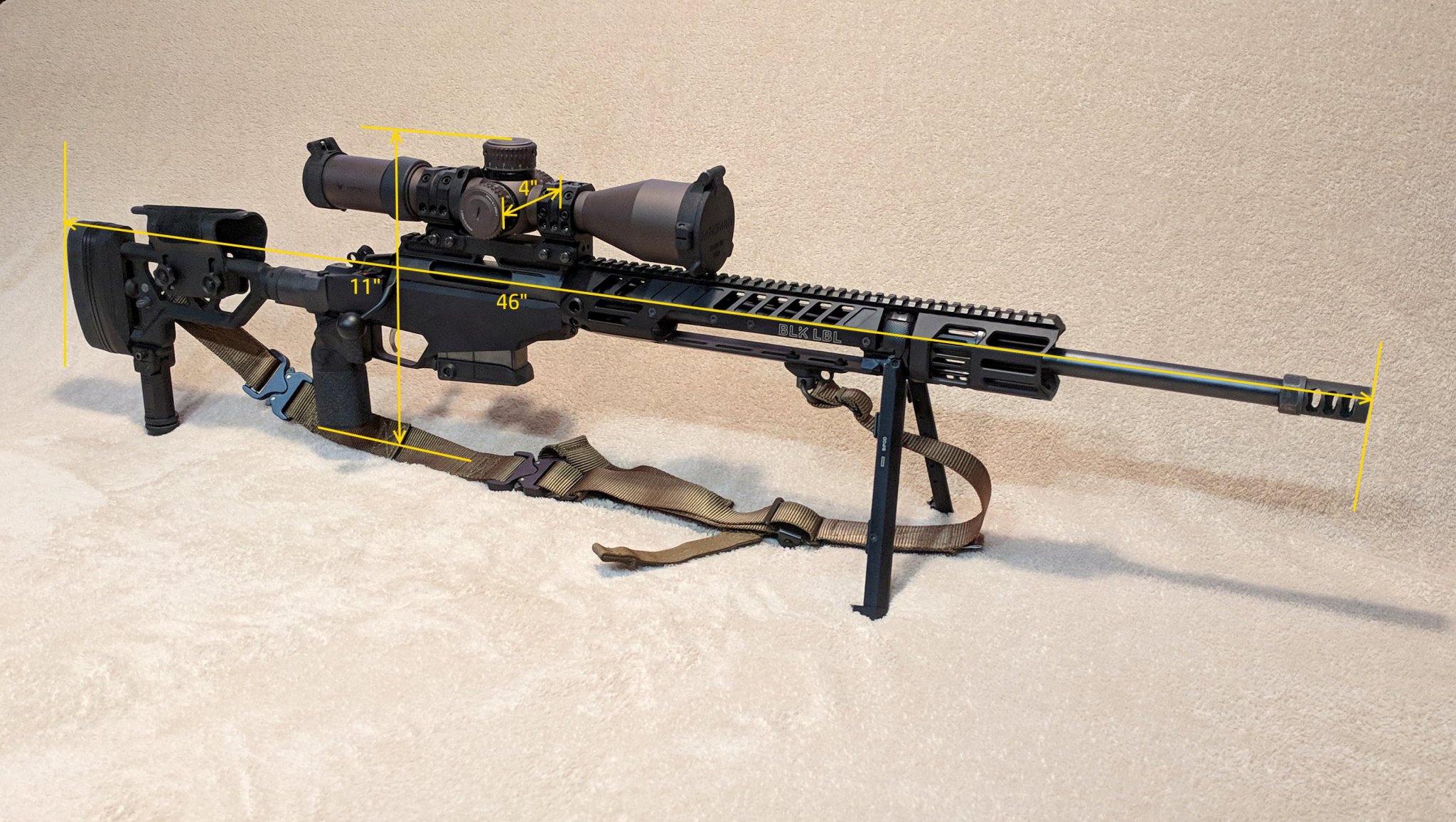

would you please be able to tell me the total dimensions of the Tikka with the Vortex Razor Scope (LxWxH) (especially the height, since I am wondering if this rifle with this scope would fit in a NcSTAR VISM Rifle case/Shooting mat)?
L: 46" (with maxed-out LOP and a Little Bastard brake)
W: 4" (across the scope windage/parallax knobs)
H: 11" (base of my MPA EVG grip to the top of the elevation turret -- I think the factory Tikka grip is slightly shorter)

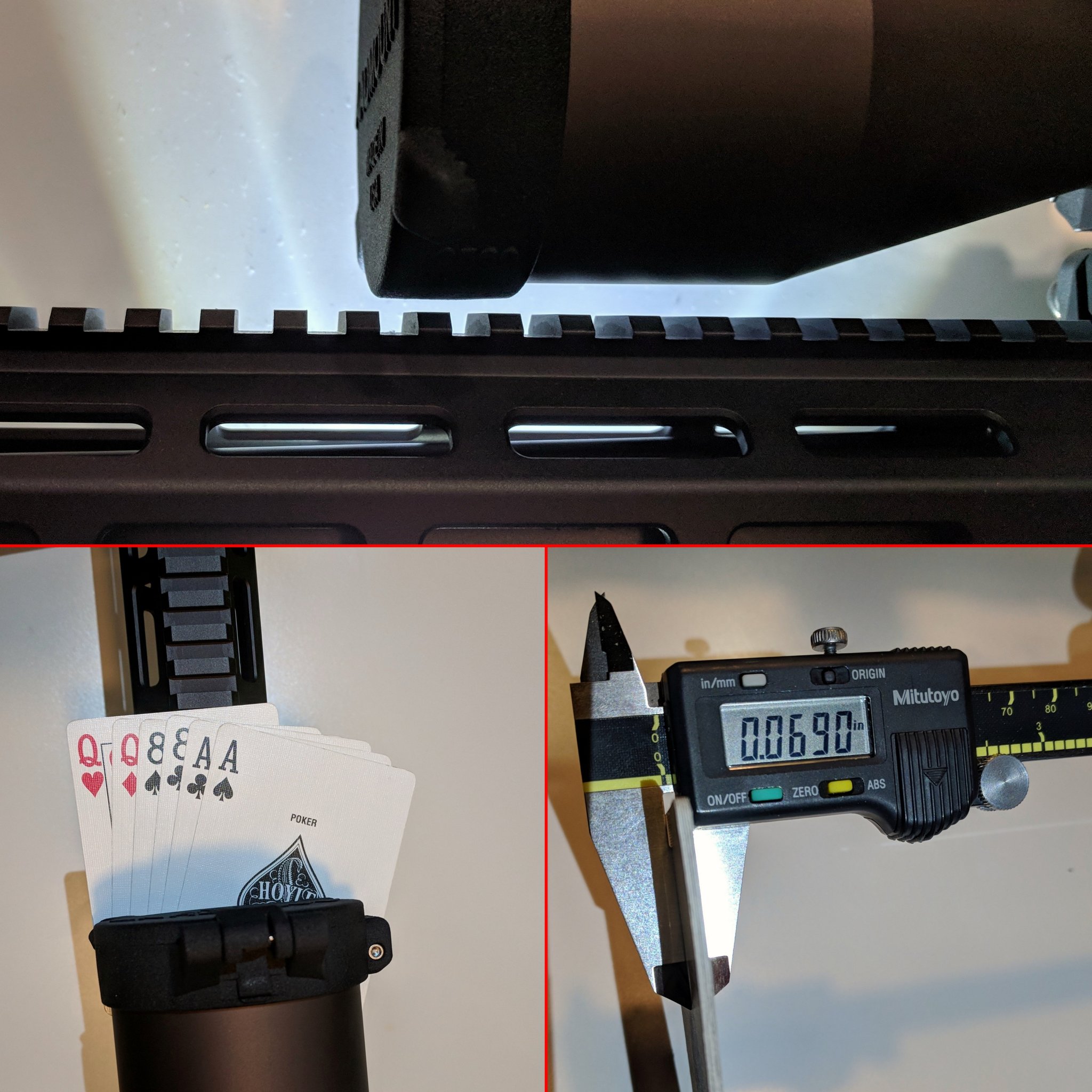

does the sun shade still fit?
I haven't tried, but it should fit. Without the shade there is 0.075" of clearance. The shade adds 4" to the length of the scope, so at 20.6 MOA it will use 0.024", leaving 0.051" of clearance.
