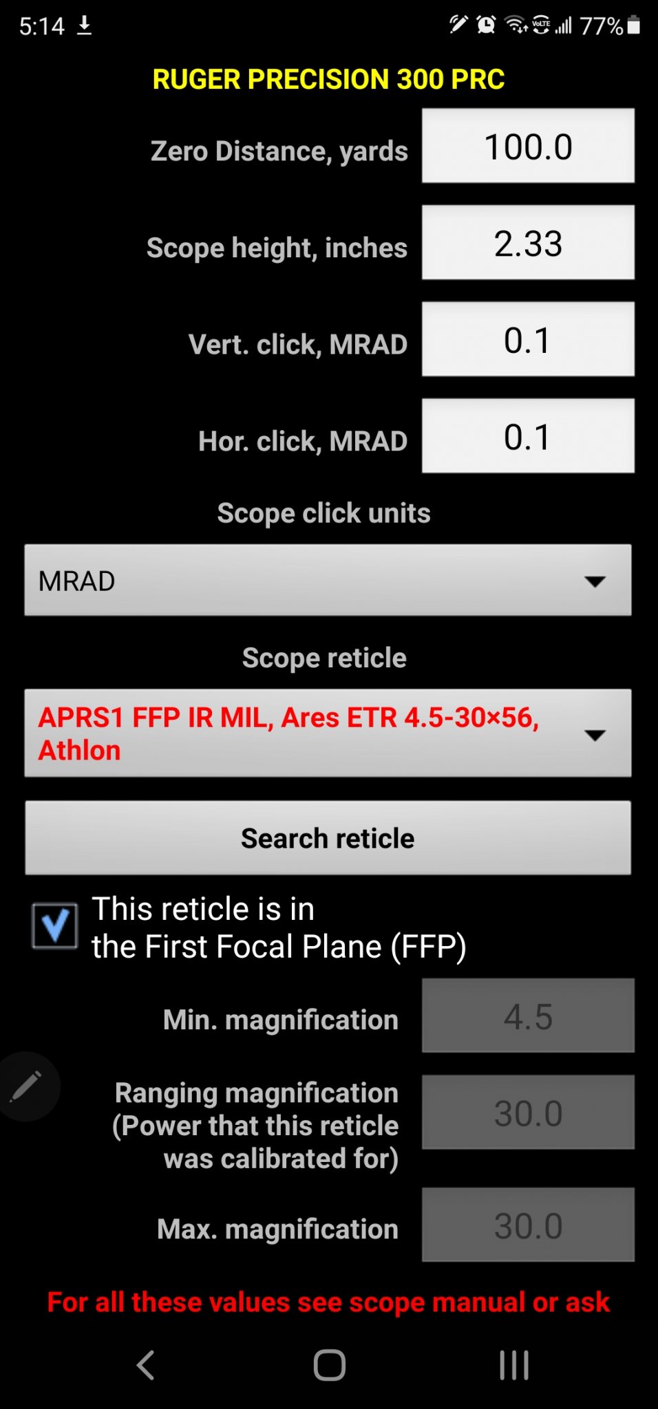

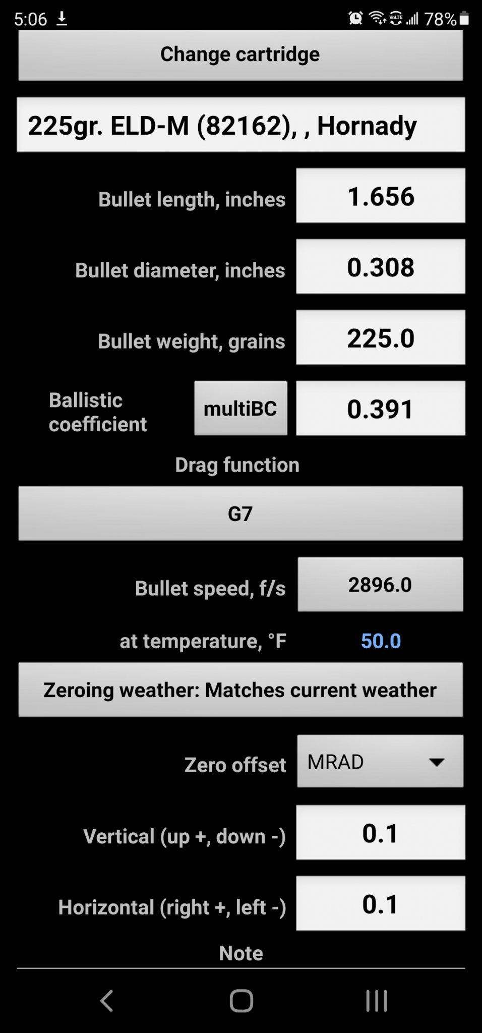

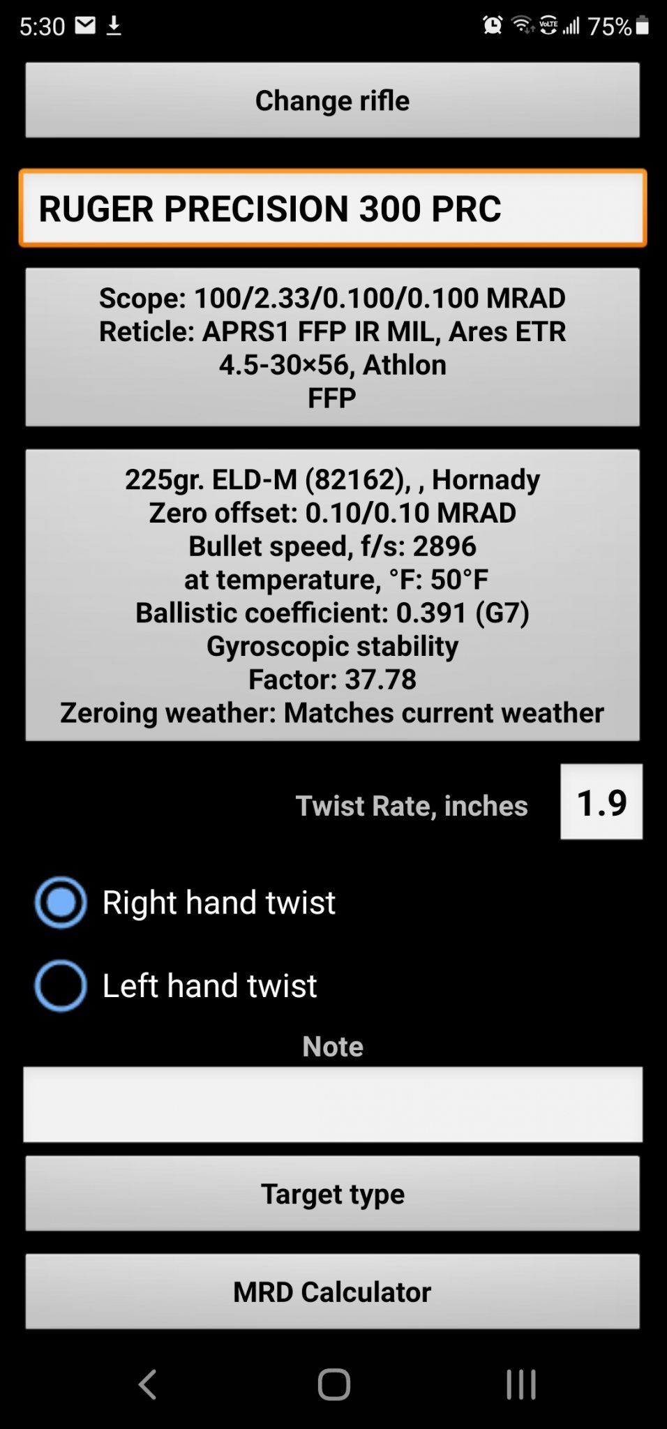

    Ok... I focused a bit and did the best I could adding the info into Strelok. Being an interface designer... noooo like that interface... klunky. Compared to 4DOF anyways.
    I know my velocity is 2896 --the averaged 5 shots taken with a Caldwell Crono. I am using a beginner rifle Ruger Precision Rifle 300 prc Model 18083. Athlon 4.4x30 50 Ares FFP MIL
    Does this all look correct?

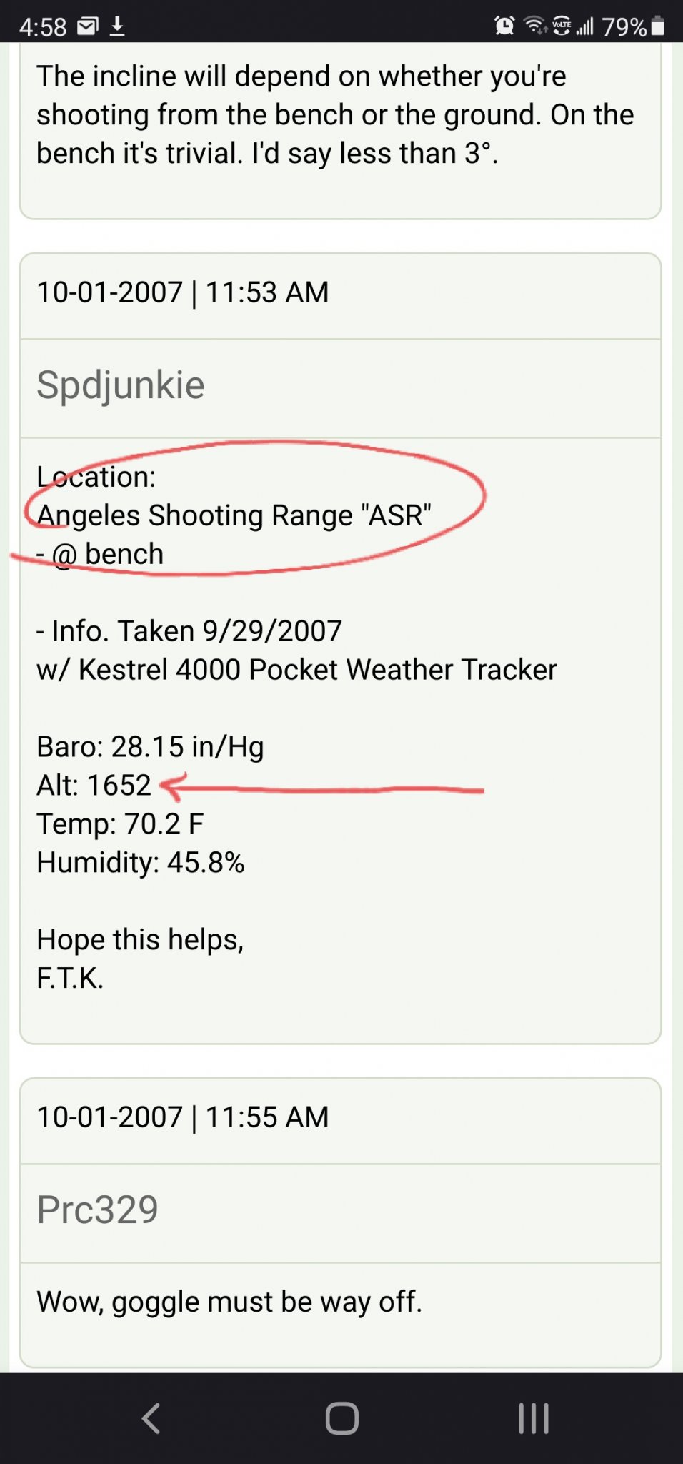

    Took AD from this guy's Kestral read, since Google Maps seems to be retarded.

    Entering your info it seems that yours would be an "8 mph" rifle wind wise. Try entering 8.0 for wind speed and 90 degrees for direction.
    Hit Calculate! and then click the chart button. The wind hold should be 0.1 Mil per 100 yards.
    Click the gear icon on that page to select/deselect what you want shown and increase the range displayed etc.
    I'd bookmark both of these:
    You will eventually want the info to compare, adjust and tweak things as needed.
