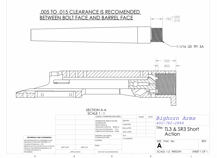

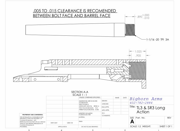

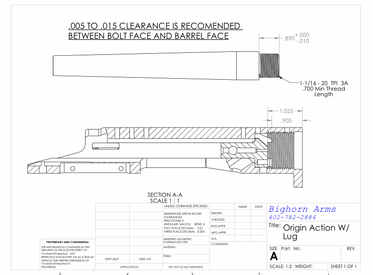

Same flush face savage thread pattern 1 1/16x20 for all of em, difference is the tennon length.
TL3 tenon length is .790
Origin tennon is .890

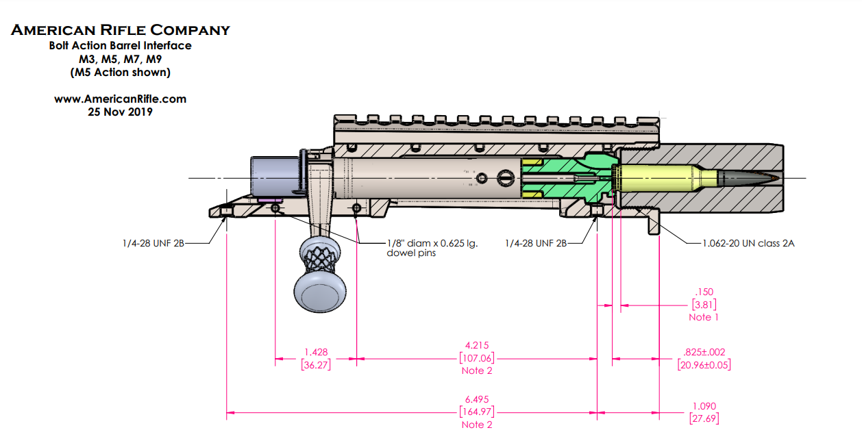

Arc is .825 (edit: .825-.150 case exposure=.675 barrel tenon length and so a .790 tl3 barrel tenon - .1 of spacer ring -.675 of arc action=.015 case exposure which is less than the .150 case head exposure from the arc print calls for but can work alright as per Leds explanation below)
The origin tennon is longer than the tl3 so you use the .1" spacer to fill the empty space and keep the origin barrel from screwing in too far on a tl3 action.
I guess you would file it down to fit the arc unless they make one thats not listed on the site that I can find.
I cant find a copy for the zermatt bighorn stuff (they will email it to you though) but the arc is here, used for all arc actions even though it specifies mausingfield.
Arc is .825
The ARC tennon is .825 minus .150 case exposure, so .675.
However, if you run .015 slim on the case exposure (.135"), it works out to a .690" tennon. So if you take .100 off a TL-3 (.100" spacer ring), you're at the right spot for an ARC action. The caveat here is that you don't have very much bolt nose clearance. IME this hasn't proven to be a problem, but just be aware, and test bolt closing BEFORE you check with go/nogo gauges to make sure there's not interference.

Here are the Zermatt schematics:
Reactions: spife7980
