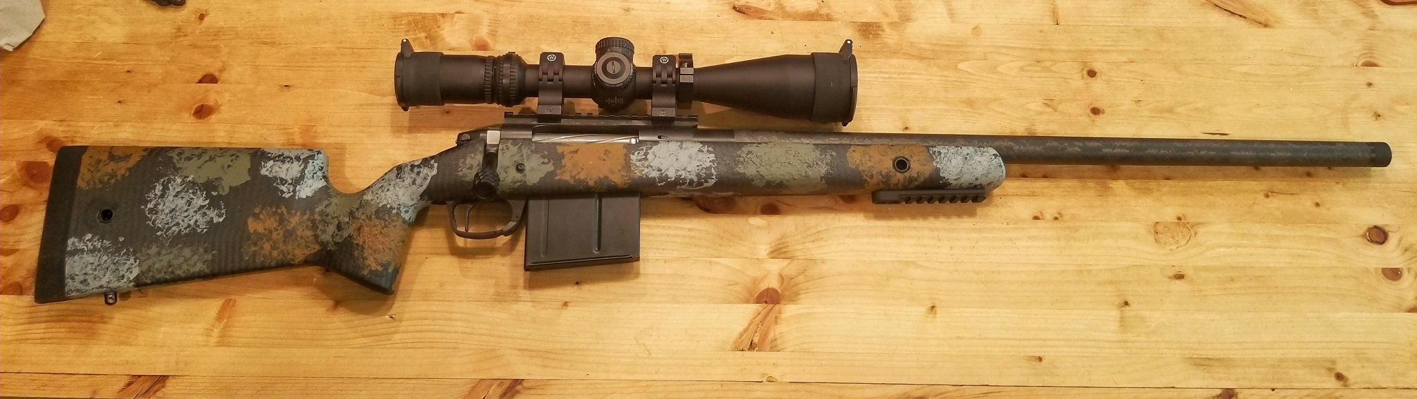

I built a 300 PRC on a Lone Peak action. Smooth as Butta and used a Proof Carbon, total build just an Oz or two over 8lbs....
If your lookn for a bit different but tight tolerances try a Lone Peak, that said I'm generally a Defiance Action guy myself.
