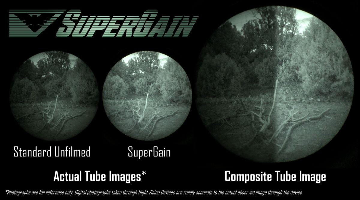

Confused after seeing an email marketing blast from TNVC a few mins ago. Are these tubes the standard L3 factory high FOM 2376+ unflimed tubes or did L3 come out with some new and improved 2376+ tube?
Reactions: NightHunt
Korean-spec, so 100k gain instead of 60-70k. I think the range on my UF sheets is 40-80k and actual is around 67k. Otherwise real nice 2376+ tubes from what I'm seeing (for an extra $1200/tube as compared to their spec'able UF WP). I hope it might push more development of quality manual-gain housings, as those'll be pretty damned bright on auto.
Wonder how much difference it makes vrs an UF tube with like ebi. This might finally motivate me to get a super toob.
I asked TNVC two questions over on ARF.
1. Wouldn’t manual gain be important with these?
2. Can we hand select specs with these new tubes?
Answer:
1. “Remember that all tubes will still have ABC - Automatic Brightness Control, so they will auto-regulate depend on ambient light conditions (the number of photons entering the tube), I've been using ABC SuperGains for about the last eight months in the TNV/BNVG Artemis, which is currently ABC-only and haven't had any issues in any lighting conditions beyond that of standard Unfilmed tubes.
That being said, manual gain control can be useful, especially to those who have very light sensitive eyes--long story short I would say that if you're already someone who needs / wants manual gain control, then you will still want it. If you are fine with ABC-only systems, I don't think that SuperGain will change that significantly.
Also, if you want to attenuate the brightness / input (technically not exactly the same thing as tube manual gain control from a technical standpoint) you can use refocusing devices like the Matbock Tarsier (probably the best option due to the iris allowing you to fine-tune the aperture size) to adjust the tube brightness on an ABC-only system while also giving you the depth of field benefits of a refocusing device, which manual gain control cannot do.
Doing my best to describe the experience of using them versus Unfilmed, the image is noticeably brighter, however, some of that is accounted for by the fact that the image is... "whiter," as most who have experienced White Phosphor know, the image isn't really actually white--it's more of a light teal, blue-green color.
SuperGain presents as leaning more "white," though it still has the characteristic WP hue, but to my eye, under most lighting conditions, it's also "cooler" temperature-wise, leaning more to white-blue than to green, if that makes sense.”
2. Hand-Select IS available for TNV-systems ONLY in SuperGain, within reasonable limits, of course, and as always, you can still hand select for cosmetics, though again, hand-select requests will affect lead times.
So, these are similar to manual gain setups? These are superior?
Manual gain you actually have a knob that can manually adjust the gain. That is housing dependent, not dependent on the tubes. These tubes will have a much higher end in terms of gain with a compatible housing.
With a non manual gain housing you get what you get. Which IMO might be too bright, probably just depends on your environment.
These should be superior to standard filmess as the marketing material does imply. Looks like they put out a brighter image when up against standard tubes.
Reactions: mikefraz
Pretty much imagine if your gain knob could keep spinning and you'll get how much of a benefit this is to you. End of the day, pretty cool but noise will be more noticeable for sure (filmless 35+ SNR tubes mitigate this to an extent).
I assume that if you take a 100k gain tube and 70k gain tube and turn them down to say 50k of gain you end up with an identical image

I have now used my Supergain tubes for a few months, now. They are in rnvga housing, so Autogain. I had some excellent unfilmed wp tubes, and these are excellent uf wp sg tubes. I hand select all the specs on the systems I order. These are roughly 2750fom, <1ebi, and 0.7 halo, and have excellent cosmetic characteristics. If "white wall hunting", they are indistinguishable from my uf wp tubes. When outside or in low light conditions, yes, they do scintillate more, however, I find it preferable to the uf wp regular tubes in dark environs, which return no/very dark image under canopy vs dim images with more scintillation. This sg is not a "next level capability", and if you have good wp uf tubes, I dont think the trade is really a big thing to pursue, but they do offer better performance in very dark areas, and if you want the best for that, these are them.
Reactions: Dogtown and Gasgun
Yup, I’ve got time now with 24UAs and now 24UAHs. In a nutshell, the Supergain tubes really shine in very low light conditions. For example, hiking the nature preserve near my house, I go in and out of moderately wooded areas on a clear night before the moon is out and with the 24UAs I get a bit of noise, but overall a clean clear image that’s totally useable. The darkest shadowed areas are very dark and I need some IR to see into them.
With the 24UAH (Supergain), there’s still some noise, but it seems a tad finer and more uniform (hard to explain otherwise - like stochastic image sampling). The image feels high contrast, where the overall levels are boosted a bit, so now I can see into those previous dark shadow areas a bit more. The image is also more black & white than blueish white. If you’ve ever used Photoshop, it just feels like someone’s played with the Levels tool to make the image more balanced.
Under more common conditions like overcast or partial moon, the Supergain tubes feel about the same as the standard tubes. This is especially true inside structures with plenty of IR flood action. But again, when you go really dark, where the standard high spec L3 tubes start to struggle, the Supergain tubes have a bit more to play with.
Is the juice worth the squeeze? It is to me, but your mileage may vary.
For reference, my tubes are all around the same 72lp res and 38ish SNR.
