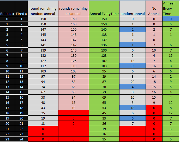

    Depending on your loads the two ways you'll lose brass without annealing is work-hardened necks that crack or loose primer pockets.
    One fella tracked case life by annealing at random, none, and every reload. The three columns on the right document how many cases he lost to cracks or primer pockets per firing:
    Hmmm??? I sure don't understand the numbers. For example, for those "Annealed Every Time", after 3 firings he only had 145 left. WHAT??? 😵‍💫

    Have to go in a Z pattern to understand it.
    at 2 x he Starts with 150 - Annealed and lost 5 to cracked necks (during sizing/seating)
    at 3x he starts with 145 due to the 5 lost.
    Shitty brass or bad annealing process to lose case necks after 2x?

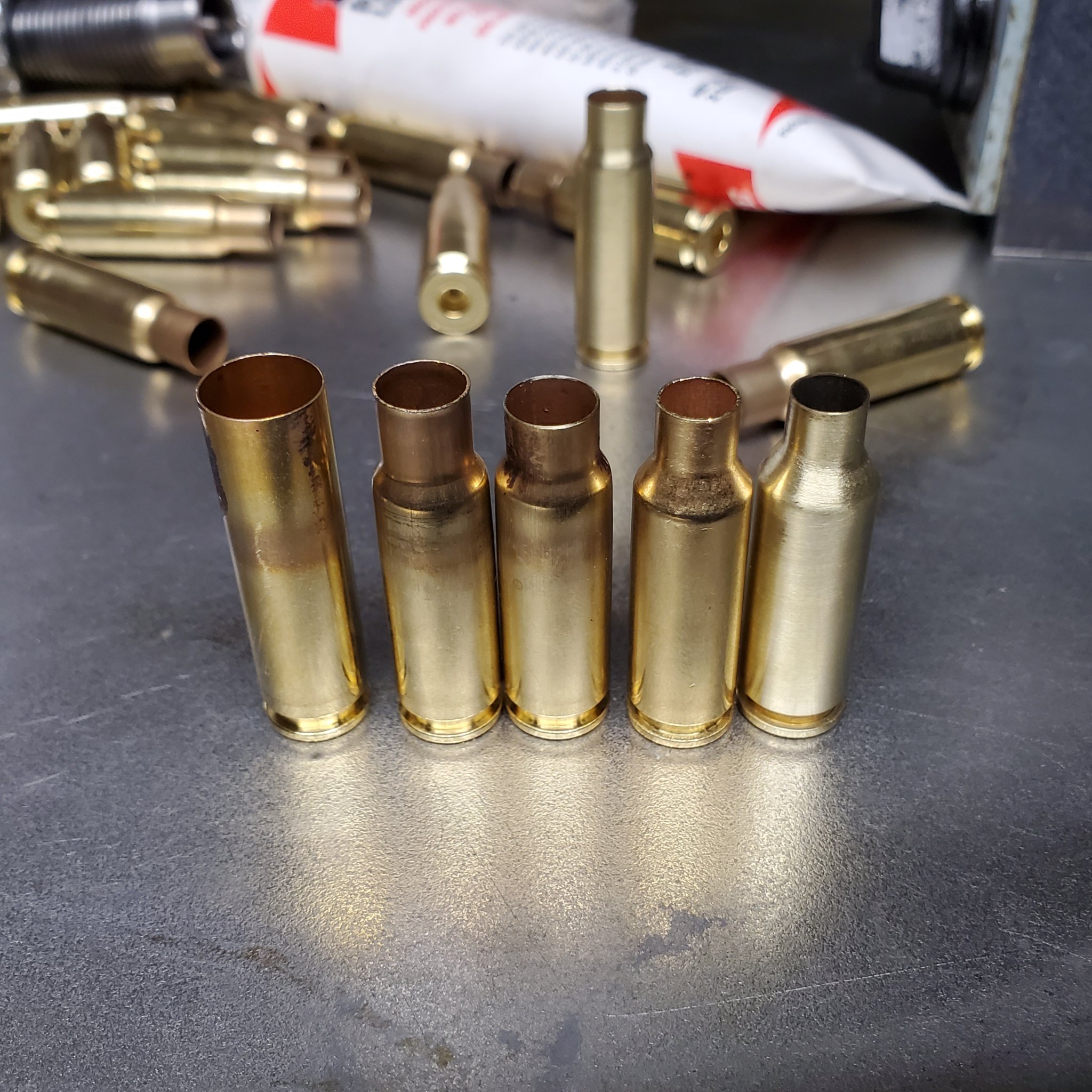

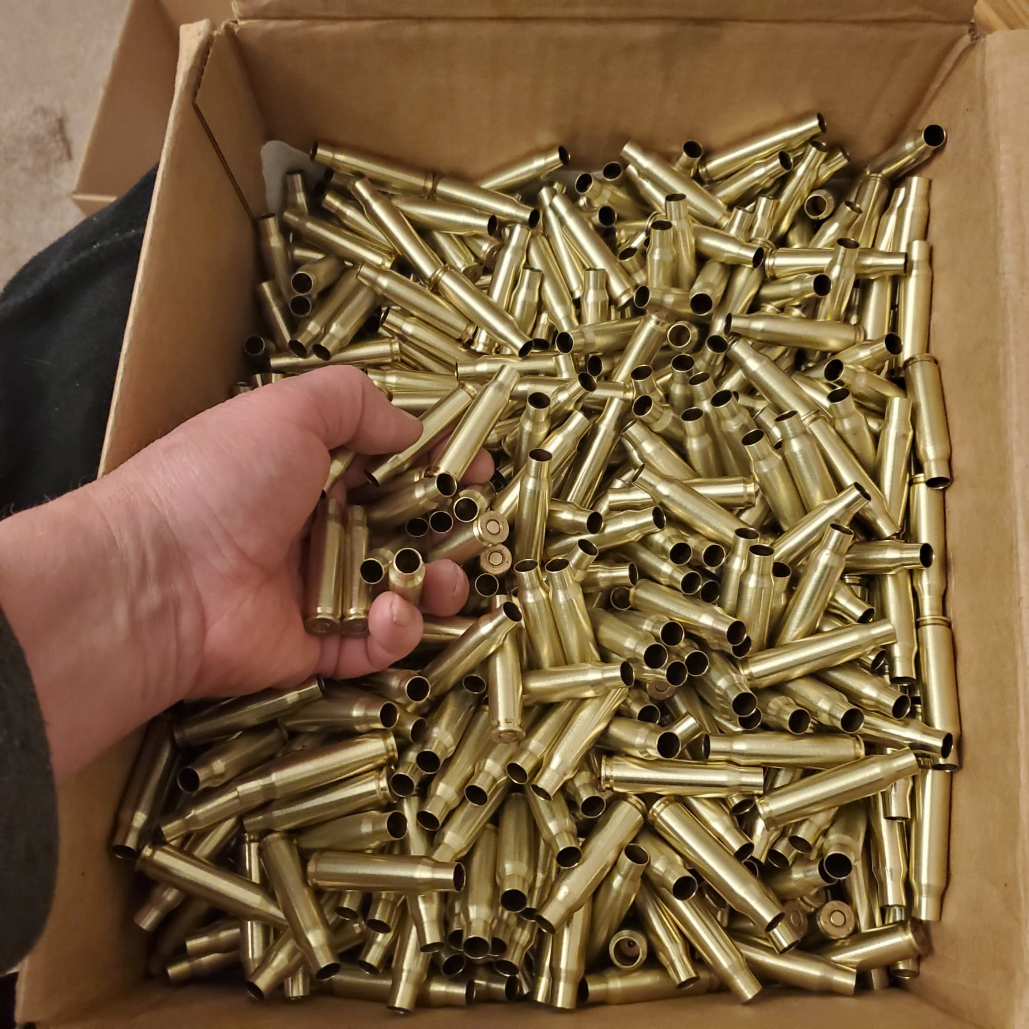

    Nope...never anneal these, even much of the case forming the 30-06 to 8.6 Blackout not annealed ...a waste if time on every thousand pieces of LC brass. But If I use commercial dies on some wildcats I anneal...home built dies no, they have a special secret built in.

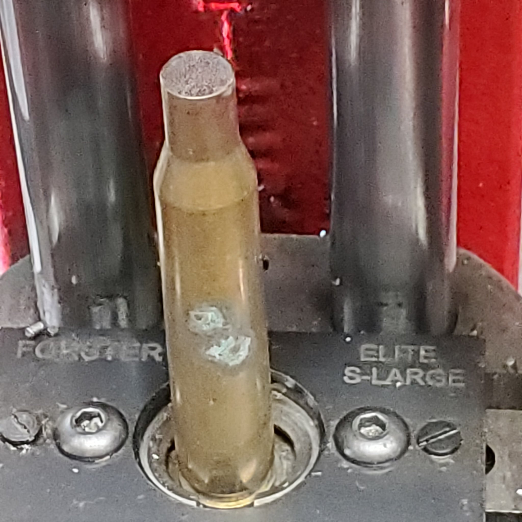

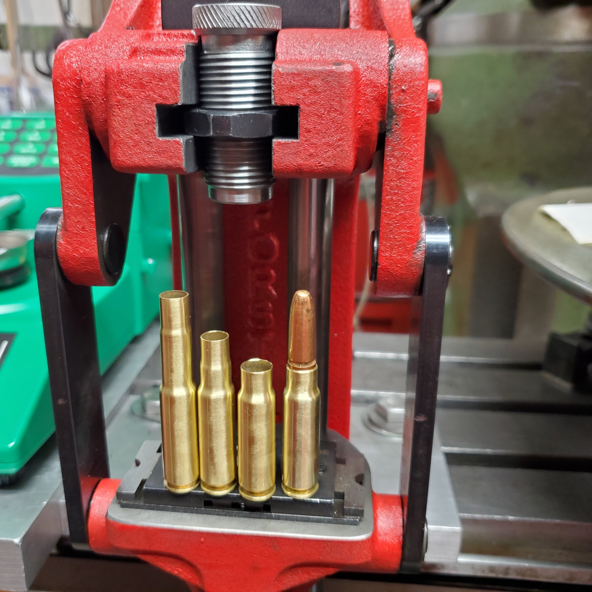

    Here is an example of my "top secret" home built sizing dies...the ideas are probably worth millions.
    No annealing ...no lube ..take this old crusty old 270 Win case out of the scrap bucket...as is.
    Put in shell holder pull press handle size 3/4" of brass to 8 6 blackout in 1 second no annealing no lube perfect shoulders.
    Don't ask.
    But I anneal with commercial dies on some drastic case forming... sometimes. And sometimes annealing causes problems, case formimg. It's when to anneal...but mostly I do not.
    I'll let others fuss over that, I have more important things to do, than light a fire under some brass.
    Don't ask.

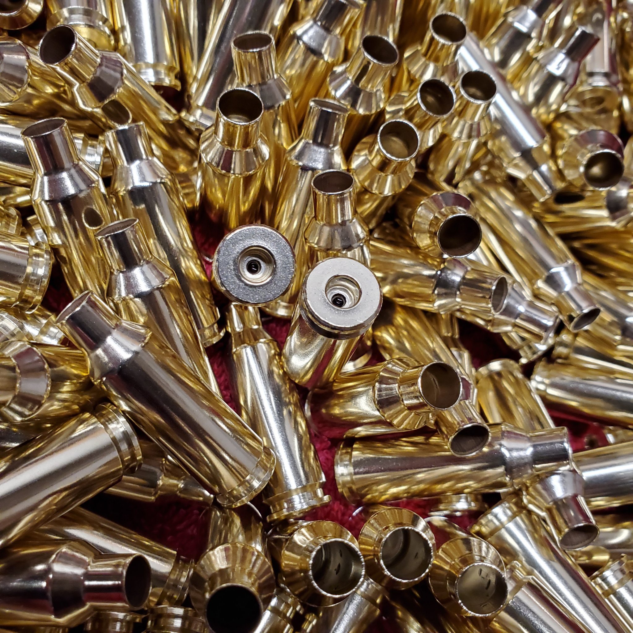

    Yep, it's not rocket science...I annealed 1000 times to get 250 cases, notice no head stamp as to what they are...
    Just use a torch and the lathe, a bored out piece of metal to hold, turn, and protect the case body...and a leather glove to pull and insert cases. Simple and free of charge, except for a little gas.
    Back in the day when shooting alot of 308 to 1400 yds. I reloaded Lapua 308 brass 40 times without annealing...just go to the lathe and make a .001" smaller bushing for the die, and back in business, with respect to neck tension.
    So I just annel when I have to...most of the time I do not...even case forming most wildcats, as I use mostly my home built dies for that, some commercial, that are altered, and not what they are.
