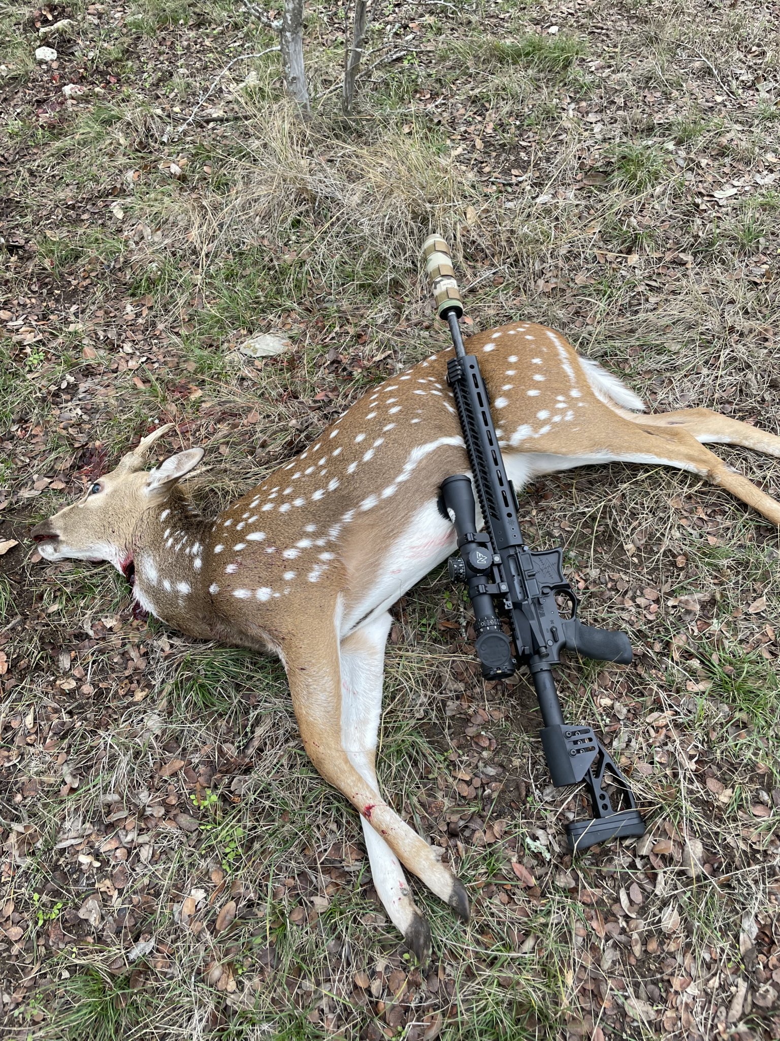

You would really like Hammer Bullets 6mm offerings. They would shine in the 6ARC. 80gr Hunter would be up there in velocity and DRT critters like a champ. Hammer bullets are notorious for being stupid easy to load develop. Everything I've tried is sub-sub-MOA. LOL. They also came out with a tipped version with 75r and 90gr. Being a solid copper mono shank, speed kills and going a little lighter in bullet weight helps in that regard.
Your Axis deer...I went to a high fence hunt ranch recently, it was still 2000 acres. An Axis doe decided to have her fawn by my cabin. I saw that fawn go from literally, "Wet behind the ears" no walk, to skittering around the camp in two hours. The doe had a lot of personality and pretty smart really. She had her fawn where no other animals would dare come near. It was really cool.
I also smoked a corsican ram with a 88gr Hammer hunter. 243AI 3600fps. That thing didn't know what to do after hit. All slosh inside the vitals and a backflip! LOL
I actually have some 80gr Badlands bulldozers to try!!
