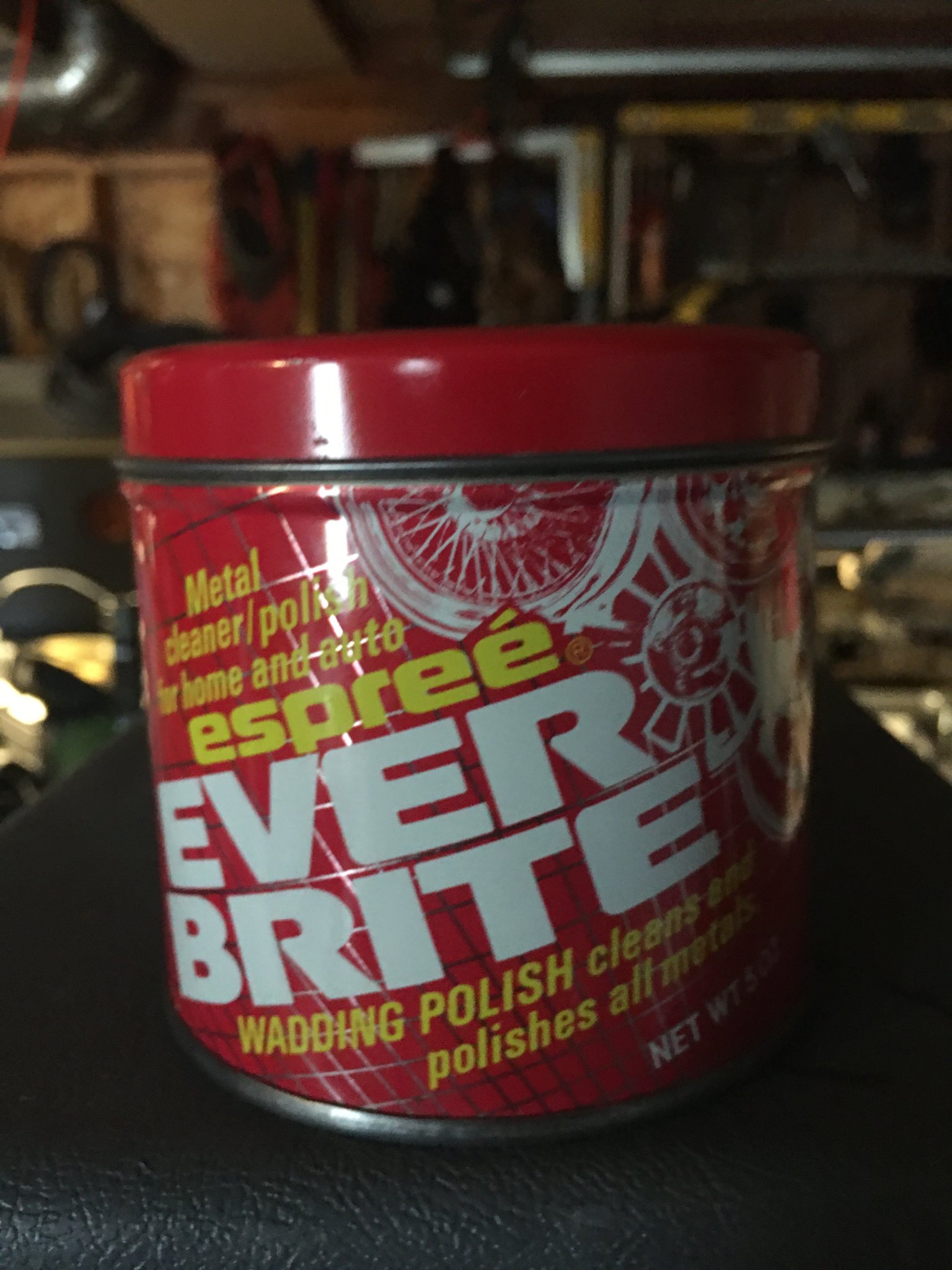

Do you attempt to clean the primer pockets?
This stuff works great;
