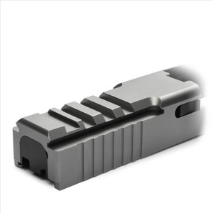

I just bought a new gen3 Glock 20sf. I'm in CA that's all we are allowed to buy. I bought a new Lone Wolf g20L long slide and a KKm 6" barrel for it. I was going to send the slide to CH and have a MOS cut done to it. I had planned on shooting hot loads with it. After reading about screw problems I'm having second thoughts. I might have a picatinny rail machined in place of a MOS cut.

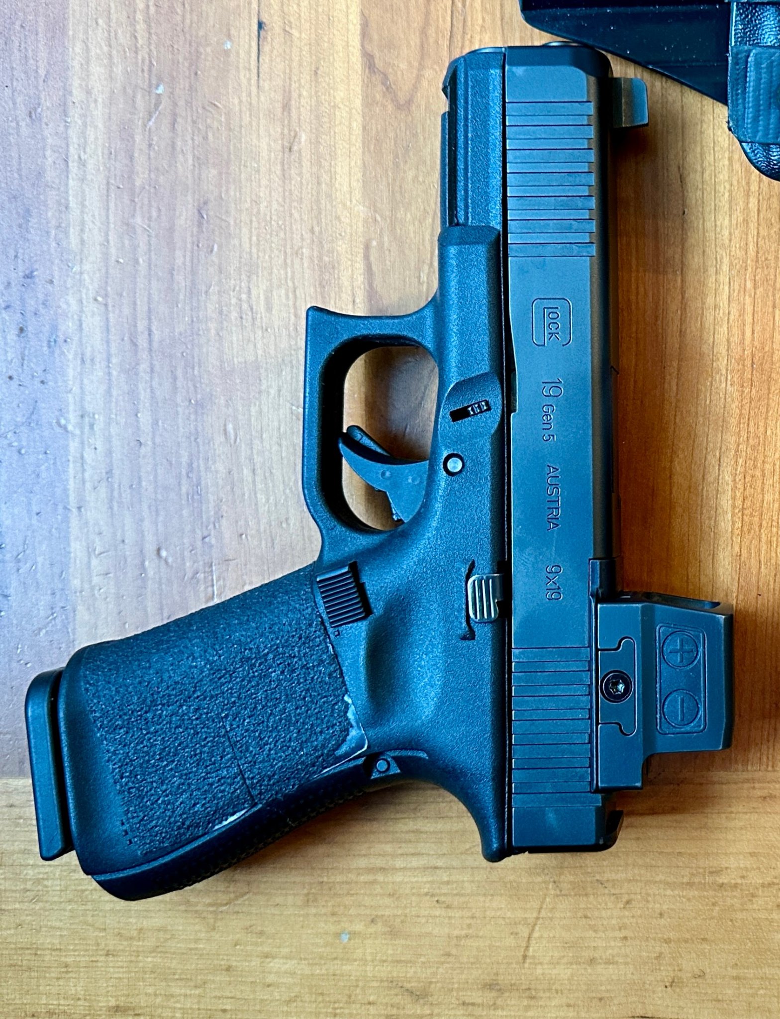

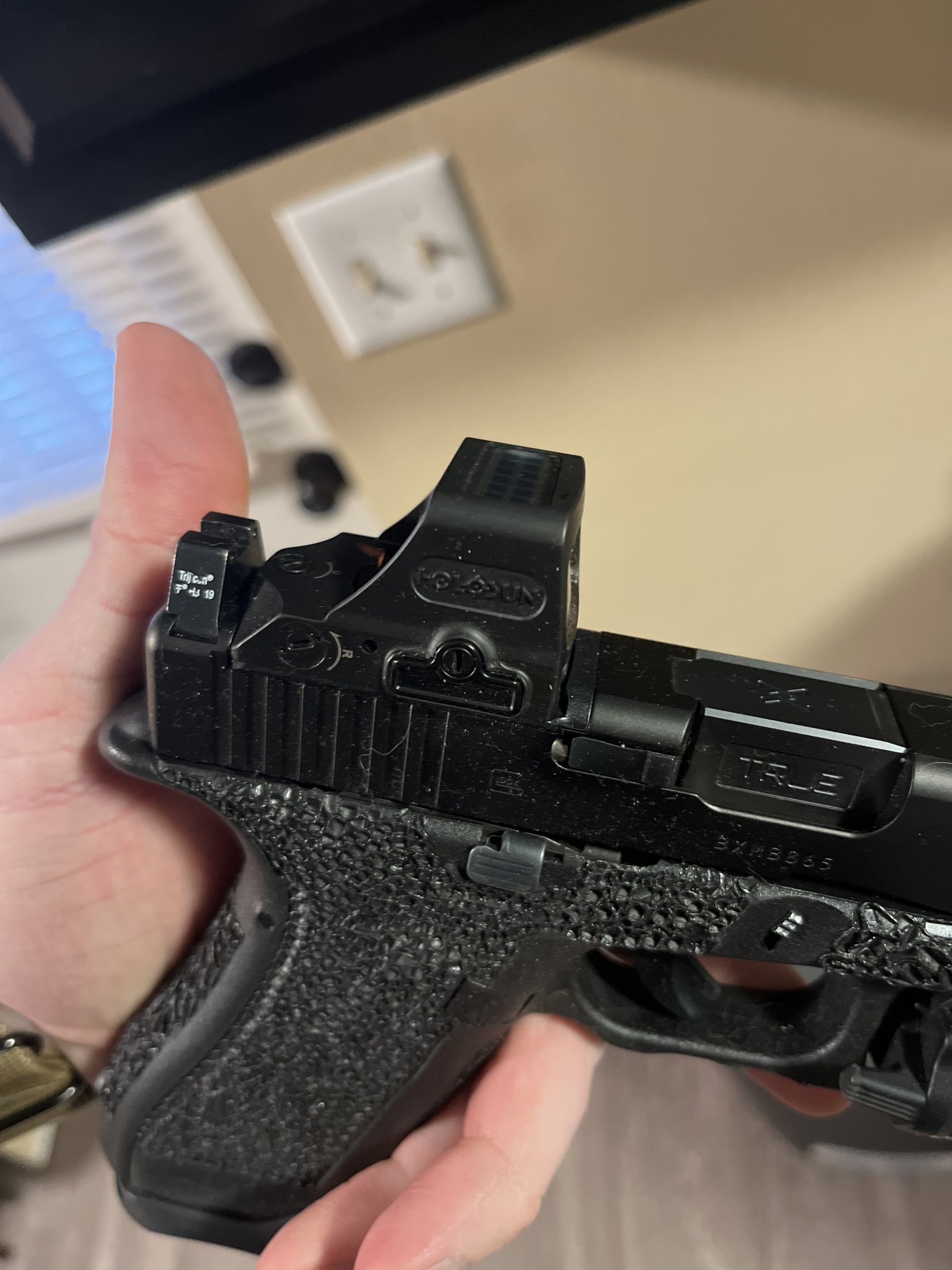

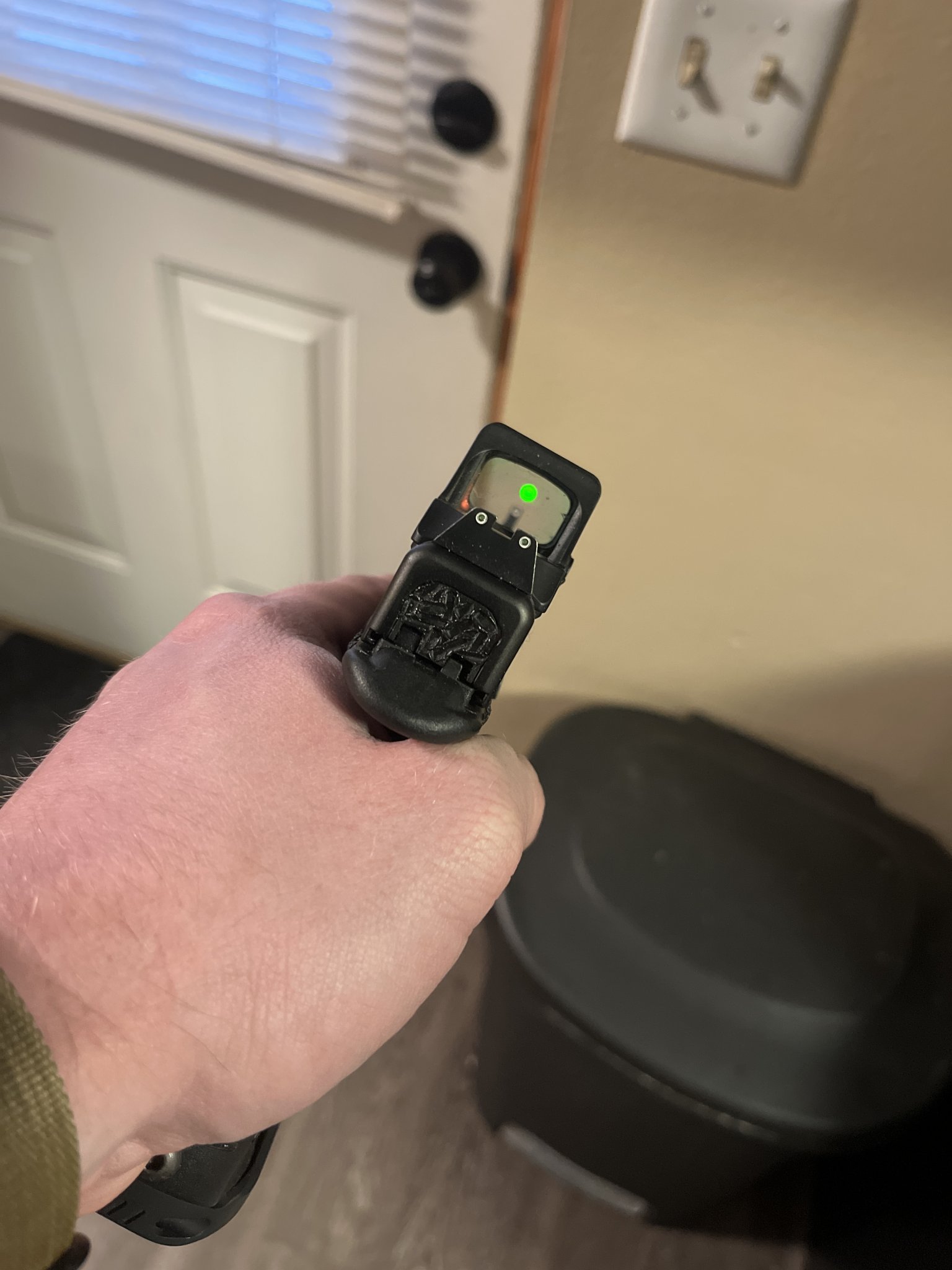

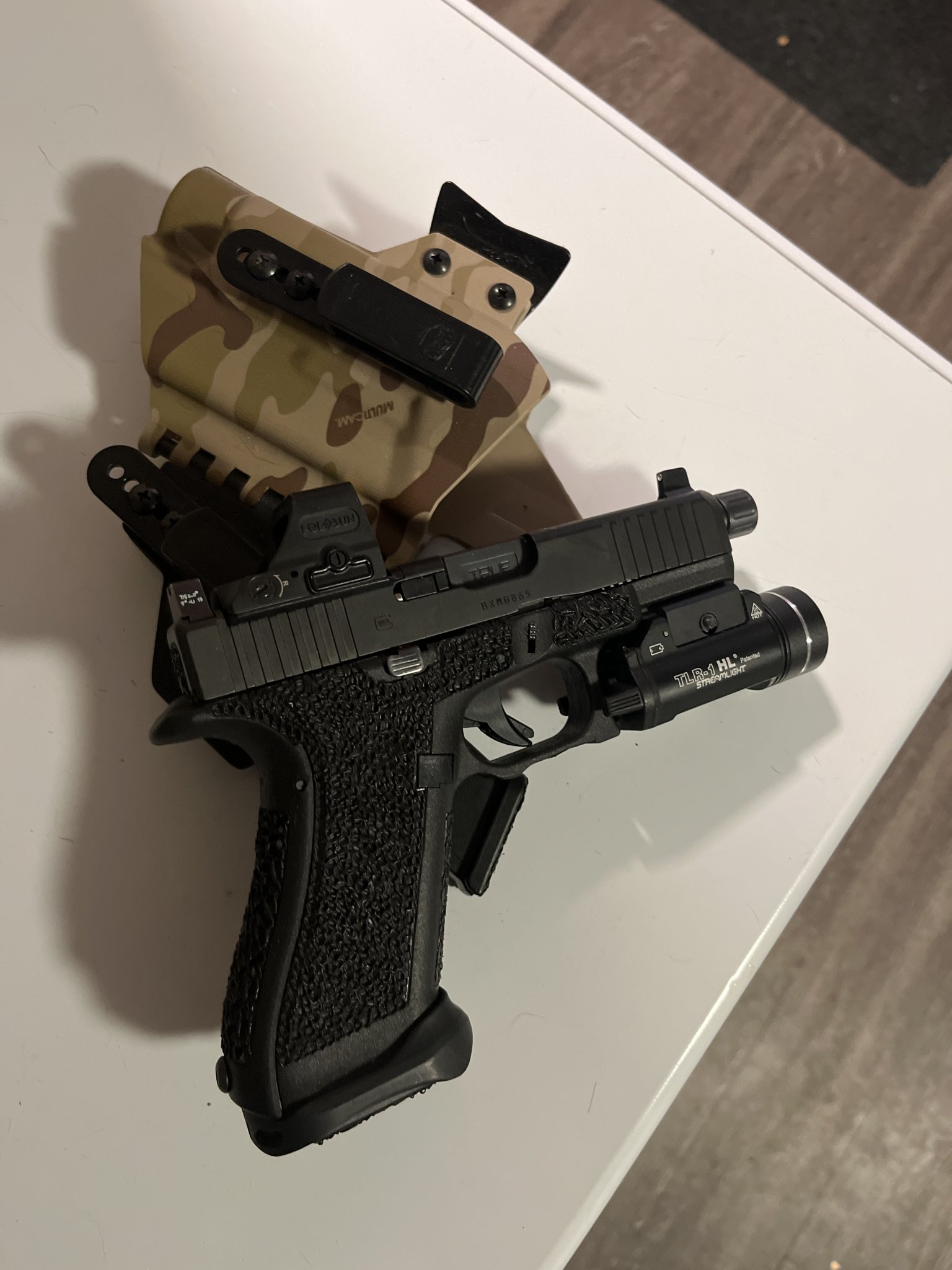

G45 MOS. With new titanium holosun

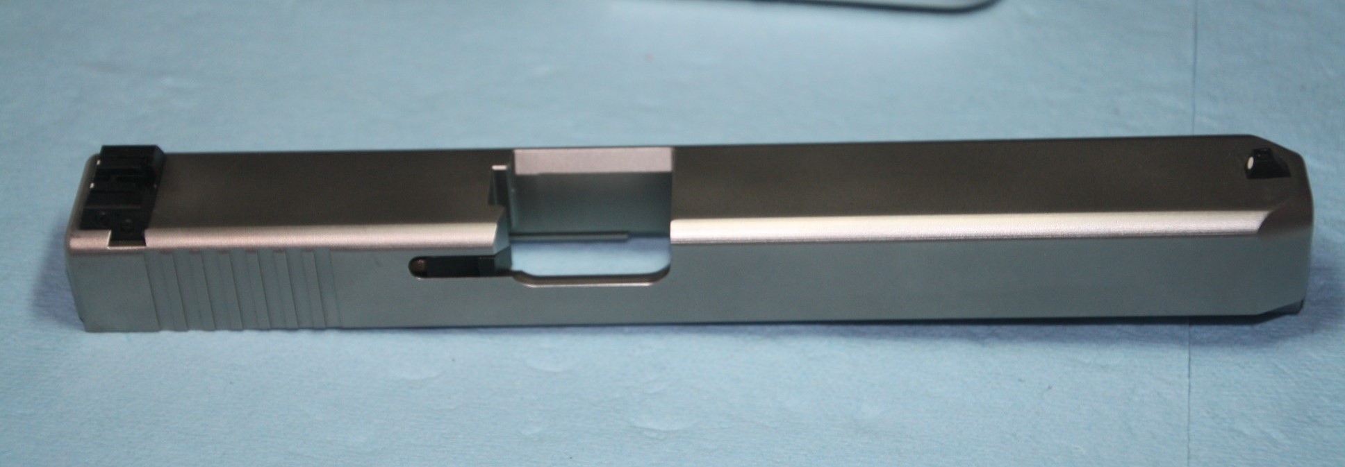

I did buy another slide to cut up so I don't have to alter the factory G20 slide. It's a long slide

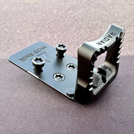

You can get an MOS gun, but buy somebody else's plates. The MOS plates are plastic, they don't fill any space between the optic and slide body so all the sheer force is on the screws and the MOS screws are small.
They break, a lot. Screws, plates, all of it. Just buy a CH plate or an FCD plate for the optic you want and use that instead and you're good to go.
