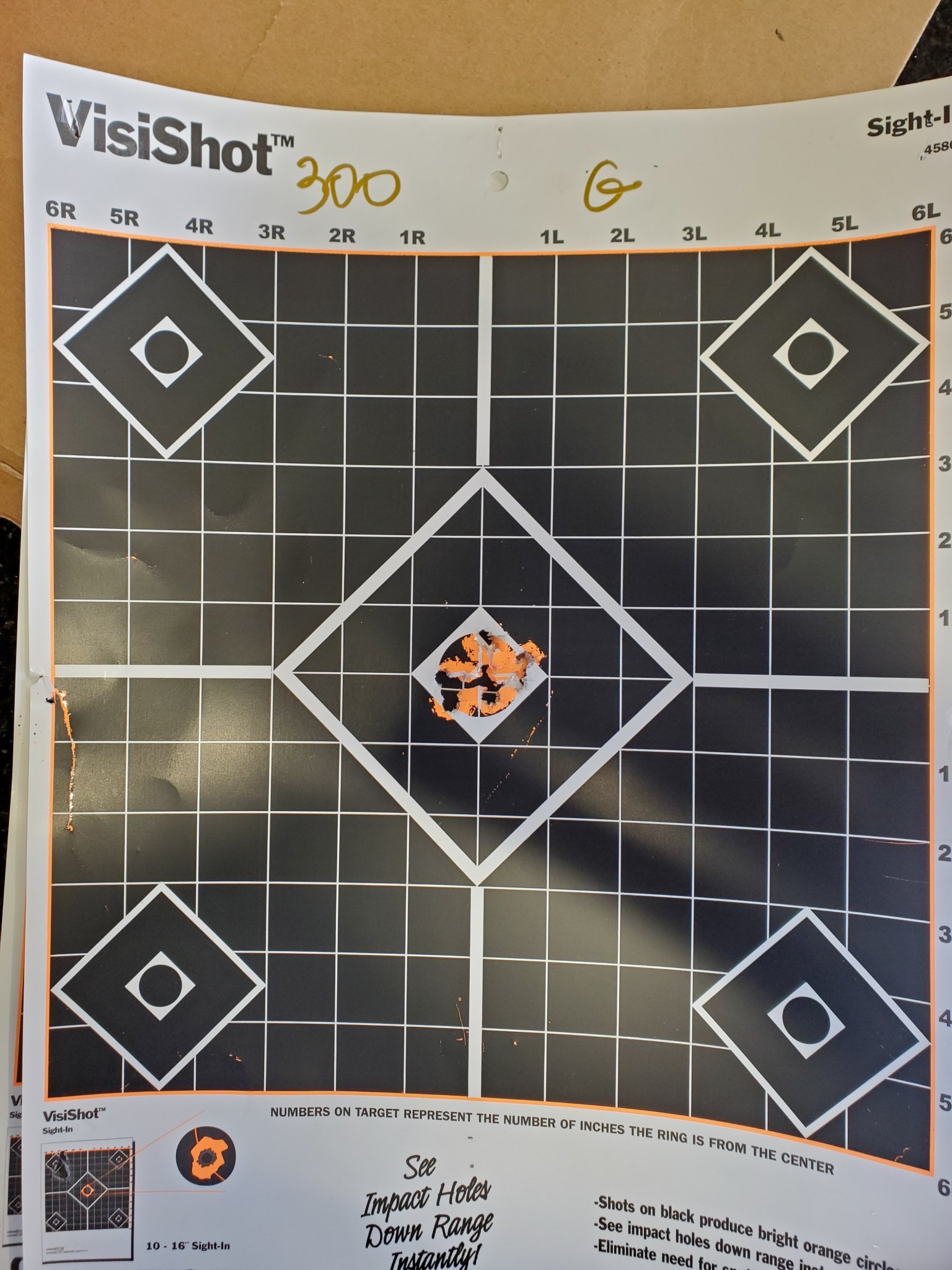

See attached, that's 10 shots in fairly rapid succession, Vortex 15-60X52mm Golden Eagle Scope, AccuTac bipod, no rear rest, bench.

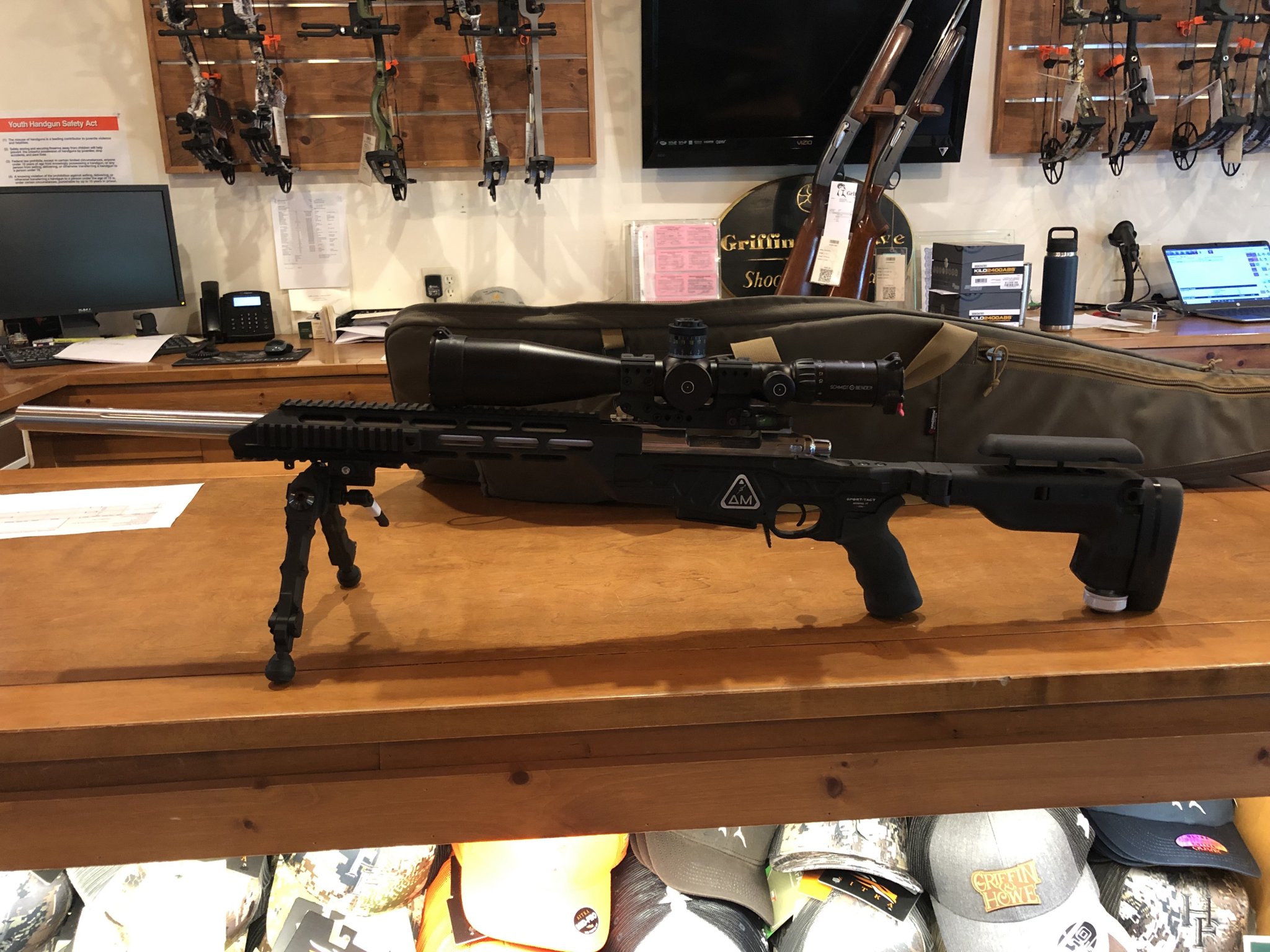

I purchased a .308 bolt gun that was spec'd and assembled by Griffin & Howe of New Jersey. The first thing I did after shooting it for the first time was to take the rifle down to G&H gunsmithing and have them spin on a 419. Huge difference.Photo below is prior to installation of the 419.
