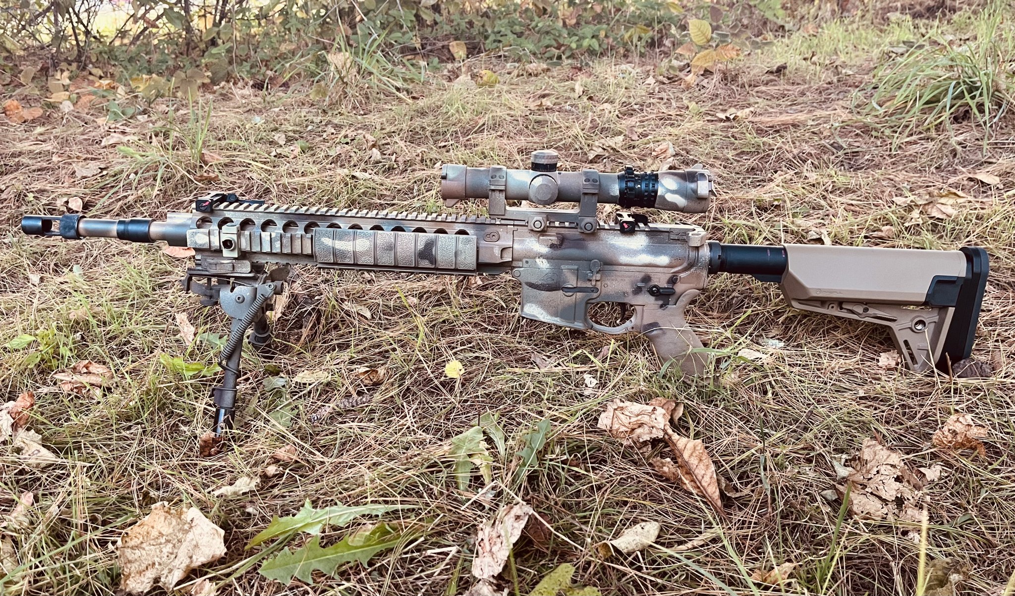

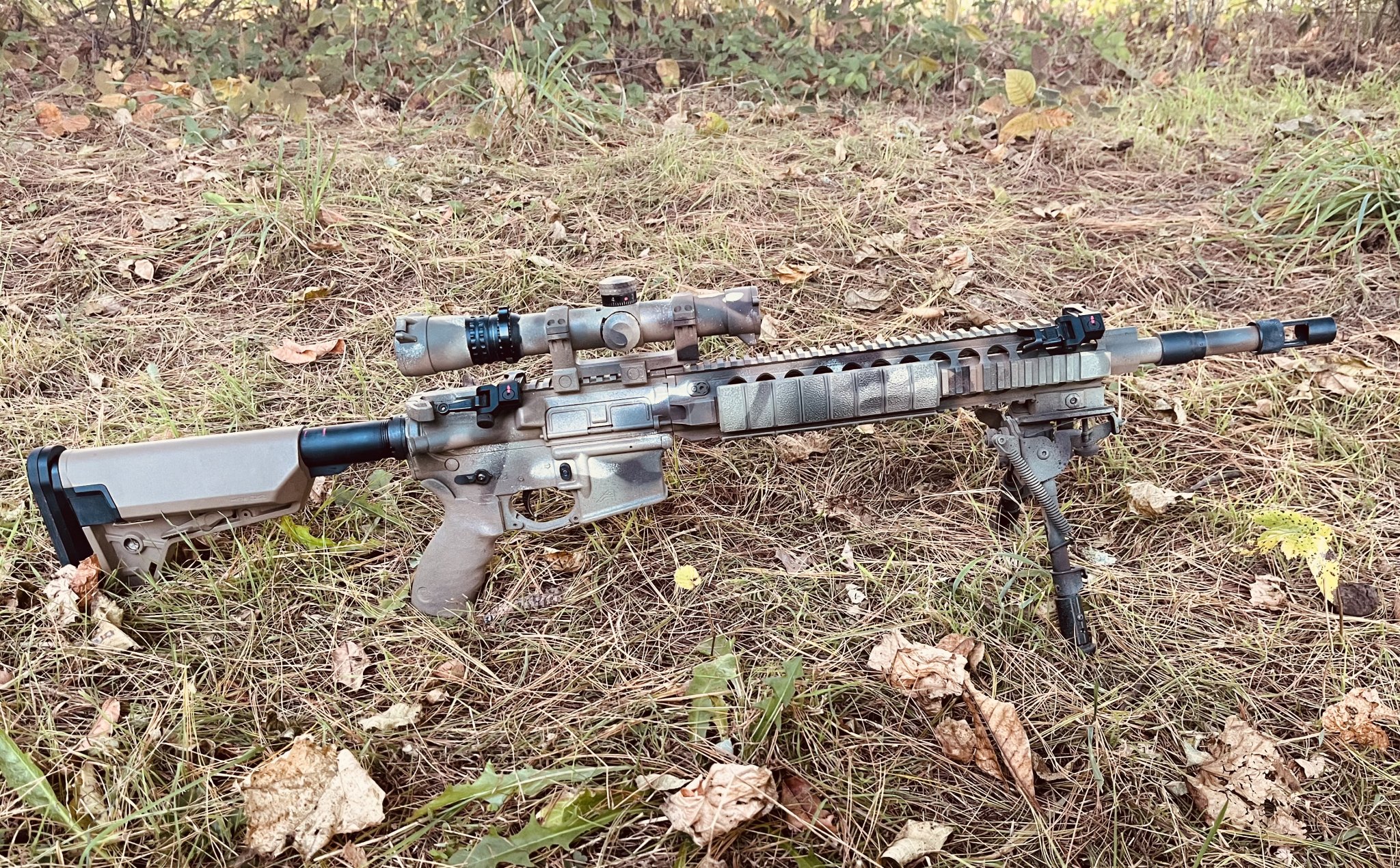

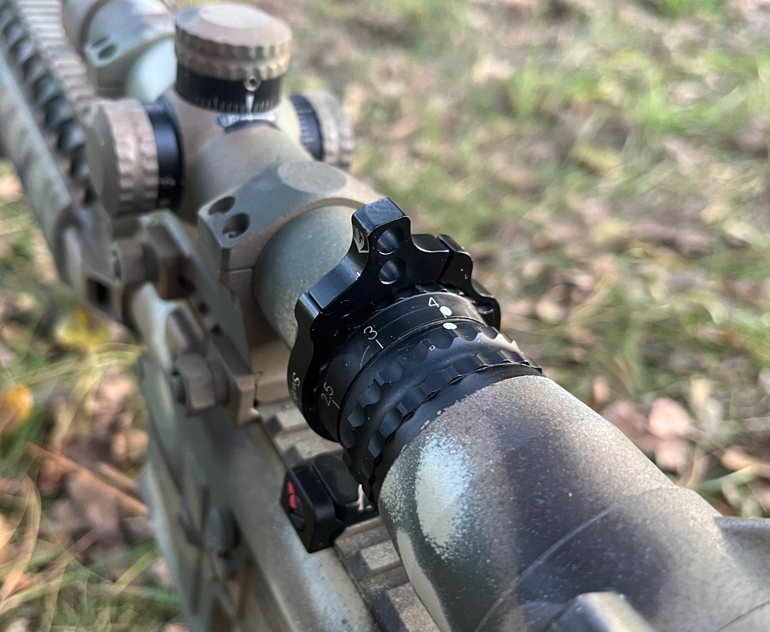

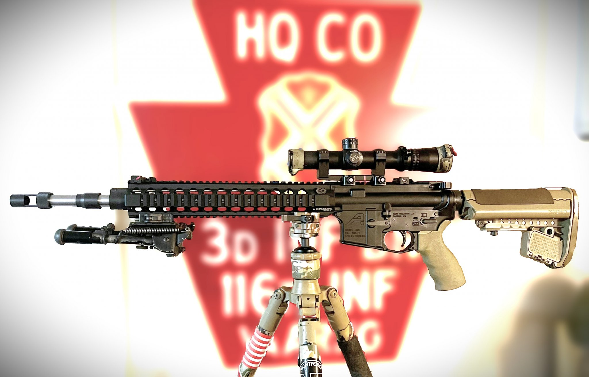

    Truth be told I'd already painted the rifle when I posted yesterday and with the overwhelming majority in favor of a little rattlecan spritz how could I ignore that haha? The responses were amusing though, almost like being back in my old platoon, thanks for that. Sadly, no pastels, sprinkles, or Cerakote was involved in yesterday's shenanigans but I'm satisfied with the end result. My Mock 12 Modoné in Moolticam™:
    Base layer:
    Rustoleum Ultra Matte Down to Earth
    Rustoleum Satin Nutmeg
    Intermediate Layer:
    Rustoleum Camo Deep Forest Green
    Rustoleum Camo Army Green
    Top Layer:
    Rustoleum Satin Fossil
    Rustoleum Camo Earth Brown
    I used a stencil that I basically copied from Primary Arms and cut it out on a manila folder, then just held it up to the gun. The bigger open areas are used with the greens and the smaller ones are for the Earth Brown and Fossil colors. As per usual the prep work took longer than the actual painting did and while everything was drying I modified the Switchview lever, chopping it down a bit to make it more low pro.
    For the curious:
    BCM M4 upper
    BCM QRF-12 rail
    BCM Gas Block
    BCM BCG
    Radian Ambi-CH
    White Oak 18" RLGS barrel, 1:7 twist
    Ops Inc brake and collar
    Aero lower
    Geissele SSA-E
    Magpul SL-S with Arisaka Angle Stock Adapter
    Ergo grip
    NF 2.5-10X24
    NF 1.375" Unimount
    MI offset iron sights
