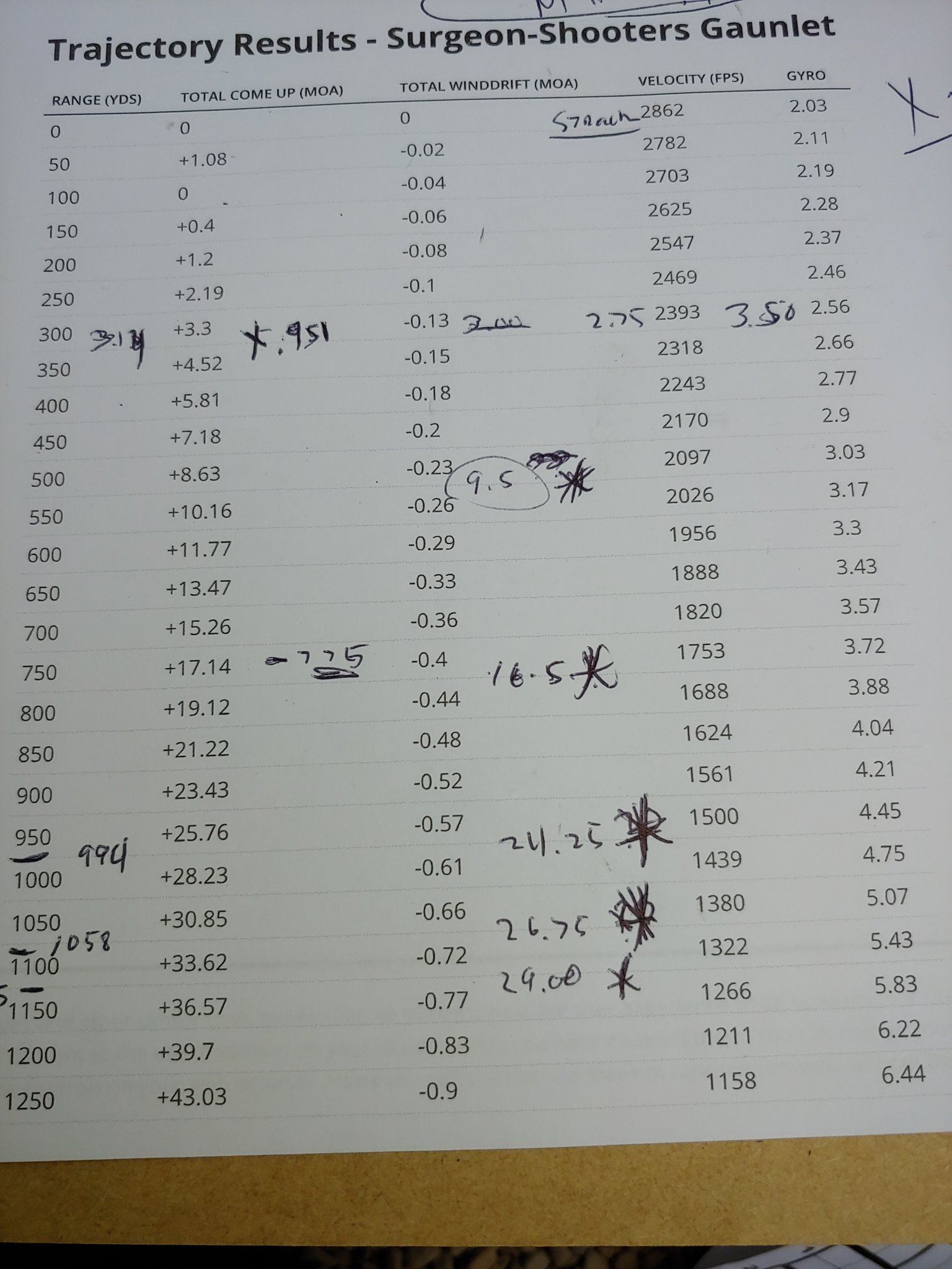

This week I took a LR course and was the first time to shoot longer distances.
The course was 2 days and I learned quite a bit.
But some things just didnt make sense to me
Prior the course I load tested my rifle and settled on Hornandy 130eld(230rem)
grouped the best. so thats what I was planning to use. I verified the velocity with a Magnetospeed(2862 average)
I used Hornady 4DOF and inputted all info. Including the high altitude the range the class was being held at(1640+)
Even printed out a chart so I could us it for notes and adjustments
Day 1 of the course was lots of info. some 100-300 yards drills and tests. Like a box test. where my optic seemed high
also a test shooting a spot at 100yards. Then dialing 30moa and shooting three rounds. Mine was high. So the instructor
mentioned the Correction Factor of .951 that should be multiplied by whatever solution I was going by.
On day 2 we started shooting further. But first we verified at 300. I was low, so he mentioned the high altitude
was making my velocity higher??
He said I should adjust my velocity in my app to get my 300yard closer to actual. Makes sense to me.
I used Strelok since it was easier to adjust and show new table multiple times compared to the Hornady
I played with velocity until the 300yard was about where my POI was and we moved up to 540
Using the new adjusted Strelok chart. I sent three at 540 and all hit dead nuts.
Then 775, adjusted based on strelok. same all three almost touching
Then 994, 3 and 3
Then 1058, 3 shots, 2 impacts
Then 1115, 4 shots, 2 impacts. Thats was kind of on me. I picked the lower elevation 29. should have went to the next one up
This seemed all good to me. First time doing this and I was able to connect. But then I thought about it.
My Hornady app had all the exact data inputted. and it was way off? I would have been about 34+ moa using it
I understand that the higher altitude could mean higher velocities. But doesnt me inputting the altitude adjust the solution for that?
Also the Correction Factor that we spent time learning about. There was no parameter to input that. But even multiplying
that(.951) to the Hornady Solution would still have not been right? With the Strelok solution I didnt bother adjusting for CF.
But had velocity adjusted based on actual POI at 300 yards.
So is this normal for these Ballistic Apps? do you adjust based on test fire impact everytime? and adjust velocity based on that??
I assumed by me actually verifying velocity it would be accurate and the app would adjust for altitude?? Did I do something wrong?
I am more then happy I was able to connect. But it was was a last minute adjustment based on 300yard POI.
Playing with velocity until the chart at 300 matched my bullet holes
would a different app work better? Instructor suggested AB. but when he inputted my data into his app. The solution was
was too much elevation adjustment??
Once again, sorry for the long post. Just had lots on my mind and wanted to type it while it was still fresh.

I tried moving the Axial Form Factor on the 4DOF, but it didnt move the adjustment enough to match the actual POI at 300

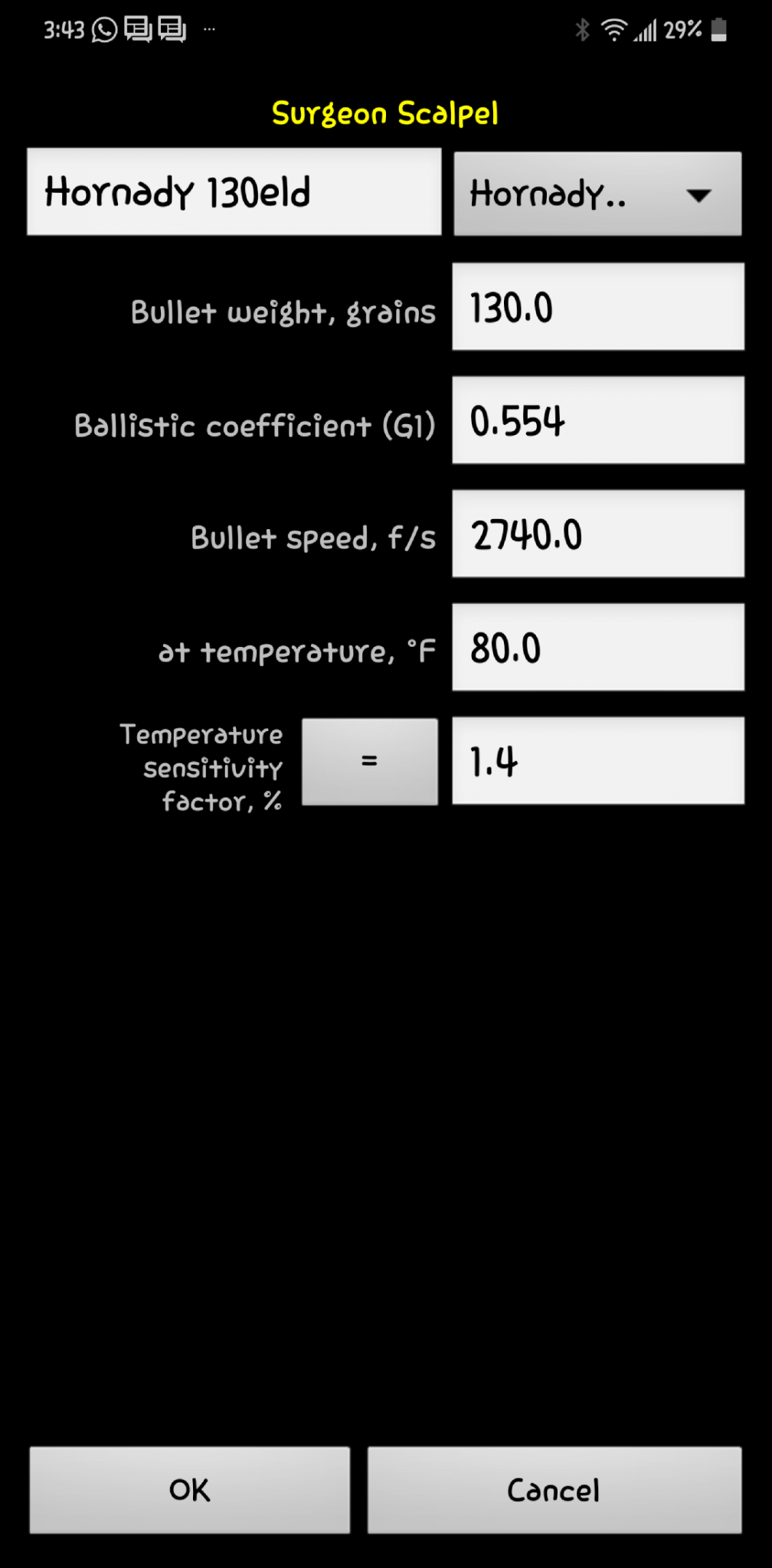

I just opened my Strelok and the velocity that gave me the numbers that seem to work was 2740??? Way lower then what my Magnetospeed testing showed. and lower, NOT higher then the instructor was saying was likely the higher altitude. I understand
all Ballistic apps use a different algorithim. But how can it be so different? My 4DOF had velocity at 2862

Well something doesn’t compute here... no pun intended. I just entered data into Stelock Pro and 4DOF for the Hornady 130 ELD M using the same environmentals and MV. In 4DOF I used their doppler profile and in Strelok I used the G7 BC. At 1200 yards Strelock gave me 30.8 MOA. 4DOF gave me 31.08 MOA... not much difference. That makes me wonder whether you have an input error somewhere that would give a result around 5 MOA difference.
My Strelok had the velocity adjusted to match the POI on the 300yard groups we shot. Not the actual Chron'ed velocity
I just went back into the Strelok and inputted all the same data the 4DOF had
500 yard was-4DOF: 8.63 Strelok: 8.55
900 yard was-4DOF: 23.43 Strelok: 22.80
So they are fairly close. I only switched over to the Strelok because on my phone it was faster to go back and forth checking the correction from changing velocity. To match the POI at 300 yards.
Inorder for the solution to make hits on target. I had to adjust the velocity to match the 300yard POI
and if that is what I need to do everytime I am at a new range. I will do it.
I was just under the impression that the Ballistics Apps avoided that. and gave you solutions based on your inputted data
that doesnt need to be trued? or adjusted as much as I had to. Sorry for these newbie questions. I just am trying to get
a better understanding of all this
Just a couple of questions: What was your measured MV? Was the 2740 the MV that you used to get the correct poa=poi? Also, did you zero at 100 at the range where you took the training?
Just to clarify for you, your actual MV shouldn’t change due to altitude, but your downrange bullet speed will be greater at any given distance as you go up in altitude due to reduced air density (resistance). However, you might have to adjust MV either up or down to true your solver.
OK, that (122 fps) seems excessive. I have not experienced that. I think Frank indicated in one of his training videos that a typical MV adjustment might be as much as 25 fps. Perhaps others will comment. Did you zero your rifle at 100 yards at the training range, and if so, was it exactly on at 100, or were you off a little? Here is why I ask. If I zeroed my rifle at 100 yards, but was about .36 inches high, my rifles true zero was 149 yards. At 1200 yards that is about 1 MOA difference in the calculated elevation adjustment. If you didn’t use the turret correction factor in Strelok, that 29+ MOA adjustment is high by about another 1.5 MOA because you are actually shooting about 30.5 MOA (29/.951). You can see how these things can add up. With regard to altitude, 4DOF requires that you enter physical altitude, uncorrected barometric pressure and temperature. Strelok allows you do do that or to enter density altitude. I really hope you are able to figure this out. Please let us know if you have a breakthrough. I am very curious why such a dramatic mv adjustment was necessary.

That's what i basically did. And it was way off.
I use my app(ballistic AE) often to get approximate holds.
Those are confirmed with actual dope from notes in areas I shoot at often.
The apps actually do really well once you get it some good data to run with.
I often have to true it a bit but nothing major.
Usually I just fiddle with the bullet BC.
Sometimes I use a G1 instead of a G7 and everything matches up perfectly.

I can understand 1/3 even 3/4 of a MOA. But mine was quite a bit more off. Unless my environmental were off?? Since i had printed a sheet from 4dof desktop version. At home before the course.
I caved in and ordered the 4DOF kestrel. With the 15% code i couldnt say no. I will try it and see how it lines up next time out. But will do some testing first
The altitude parameter. Is that the actual measured feet above sea level? or is it based on DA?
I know based on the Kestral info of the instructor the altitude kept changing depending on weather
I was wondering do I input the actual measured altitude or the what the environmental make it?
I use density altitude and also a temp as I have an approximate temp correction value I use in my app.
You could do actual altitude, temp and humidity but DA is simpler with no negatives that I know of.

It was my first time needing to use my apps. So I was not sure if trueing of some sort was necessary or not
I guess I was always under the assumption that I just input data. read chart. dial. and as long as I do my part. It will connect
I will have to get better data and hopefully will be shooting at the same place for enough times to get a handle on this

How much was the DA changing during the day? You need something like 2,000 or more change in DA to matter much.
based on the instructors Kestrel. It was going from 1600 to 1800+
I was not sure I should inputted the actual measured height or the floating number. I inputted the measured
