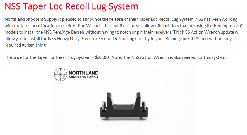

I would never waste my time doing any of that.You’re covered. If you have the action apart, take the opportunity to lap your lugs and drill/tap your scope mount holes to 8-40.
you’ll also want to cut a small slot at the base of the receiver for the recoil lug pin if you’re going with a NSS lug. You can do it with a drill press, but finding someone with a mill you can use is a better way to go. Lastly if you can get access to a lathe, you could also face the front of the receiver. This doesn’t get you a real “blueprinted” receiver but it’s an improvement over stock.

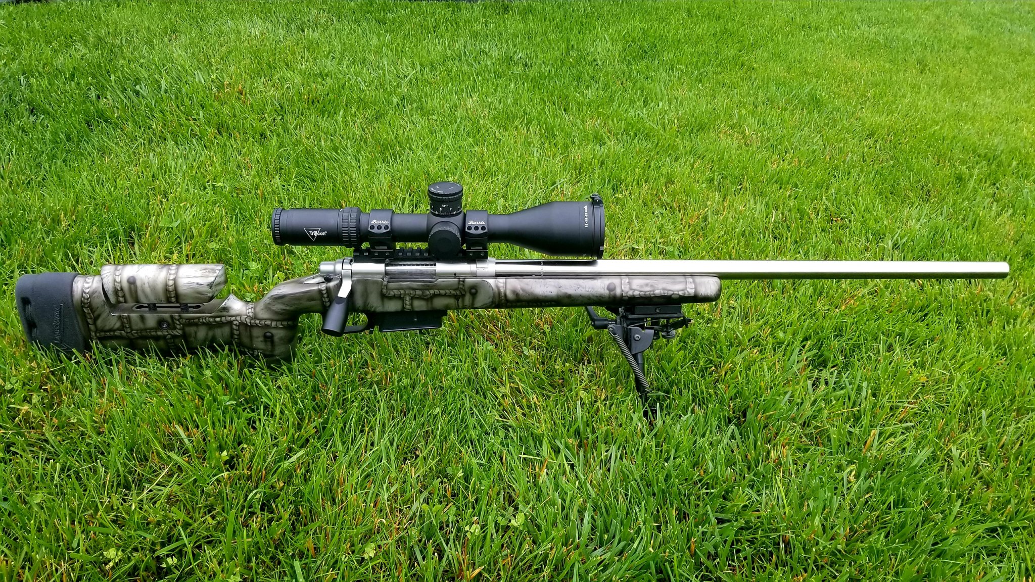

Ive done 4 of these, 3 with a criterion barrel, and working on a budget build with a KAK barrel (not sure how accurate that one will be). DIY remage is a fun hobby, good luck.

Just get the taper lock lug alignment for 25 bucks and youll be good to go.
I’ll also add that I’m very happy with the Criterion barrel (26” MTU in .308) - load development has been easy and it shoots sub MOA.
