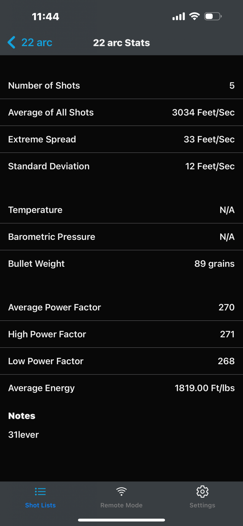

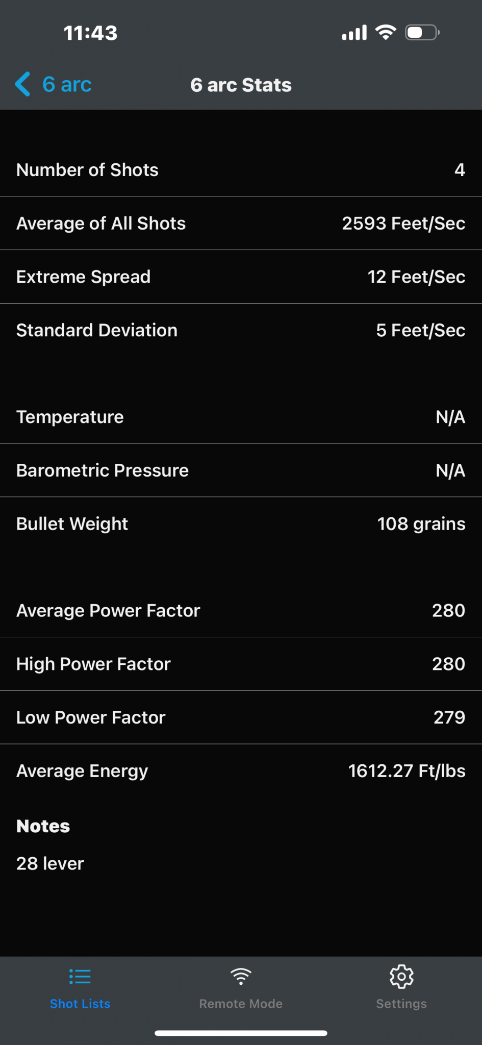

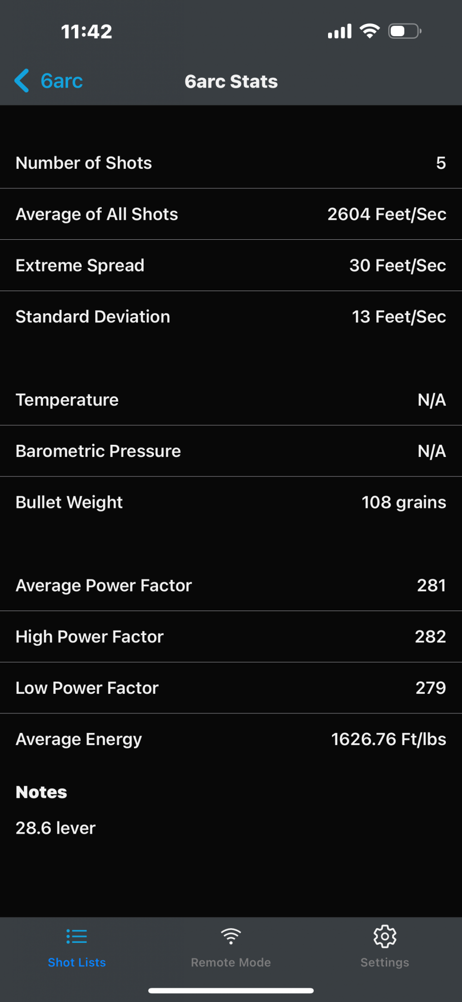

Top tier 6mm ARC barrels
Six ARC
Shot with the 87 Vmax (called 89 grain by mistake)
and 108 ELD
Really good SD but grouping just wasn’t there at all

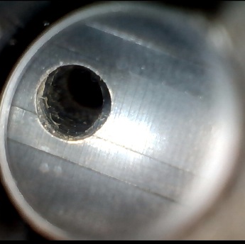

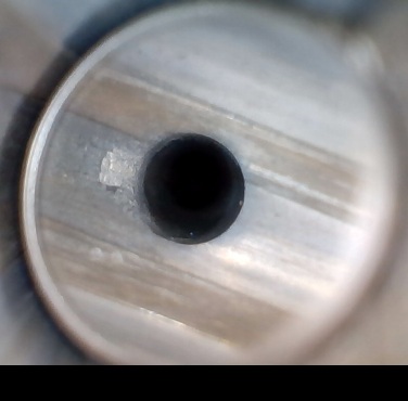

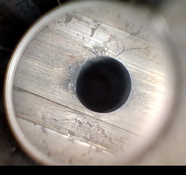

Here are a couple of gas port pictures to give you a sense of what is common. I don't have a 6ARC so these are different calibers.
Proof 6.5G, roughly 2k rounds, uncleaned. The erosion is filled with carbon. This barrel shoots, does not drift or string:
WOA Wilson 223Rem. 2.5k rounds, uncleaned:
Brand New Faxxon 5.56. Notice the tooling marks, they run the entire barrel.
Even the Faxxon port is round and unchamfered.
Curious as to what brand and model of barrel scope you have it does a really good job(I have played around with the mirror length but I’ve never got it to be that clear)
